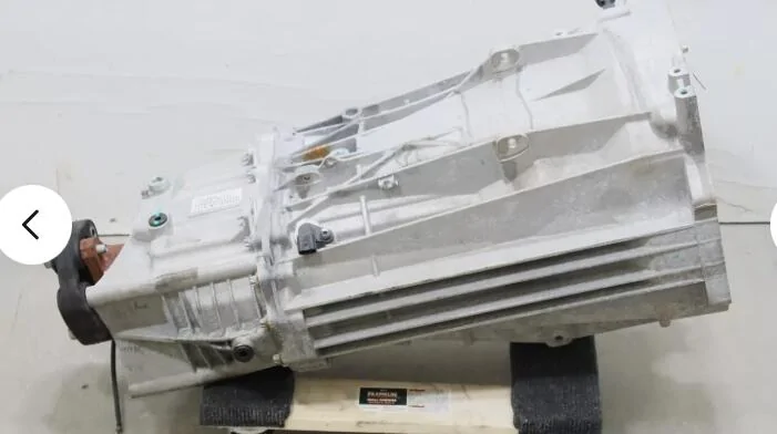

Brother....I REALLY hope your not going to try and run that 2.3 off that 8 speed tranny in the Maverick. I've had a Livernois 93 tuned 2019 Ranger and there is ABSOLUTELY NO WAY that Maverick tranny can take the low end torque of that 2.3 ecobeast. I know you are more than knowledgeable about the engine swap so I'm curious what you will do about the transmission......10 speed swap of the 8 speed maybe? Can't wait to see how this turns out. I know a lot about the capabilities of the 2.3. AWESOME platform......you can safely take it to 350 hp but it seems the folks that start to get above 400 hp start getting the "rod off light". Keep us posted!
that's definitely not going to happen because the 10 speed is only fitted to longitudinal mounted engines.
however there are several transmissions in the Aisin 8F family that are rated for much more torque. it might be difficult to adapt one complete because of the tcm and interaction between tcm, ecu and other modules. however, it might be feasible to use some internals from the higher spec units in the 8F35 case.

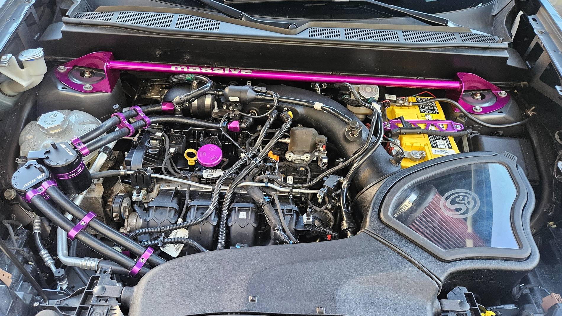

Yo what strut brace is that!!! I love ittttt please provide the link.

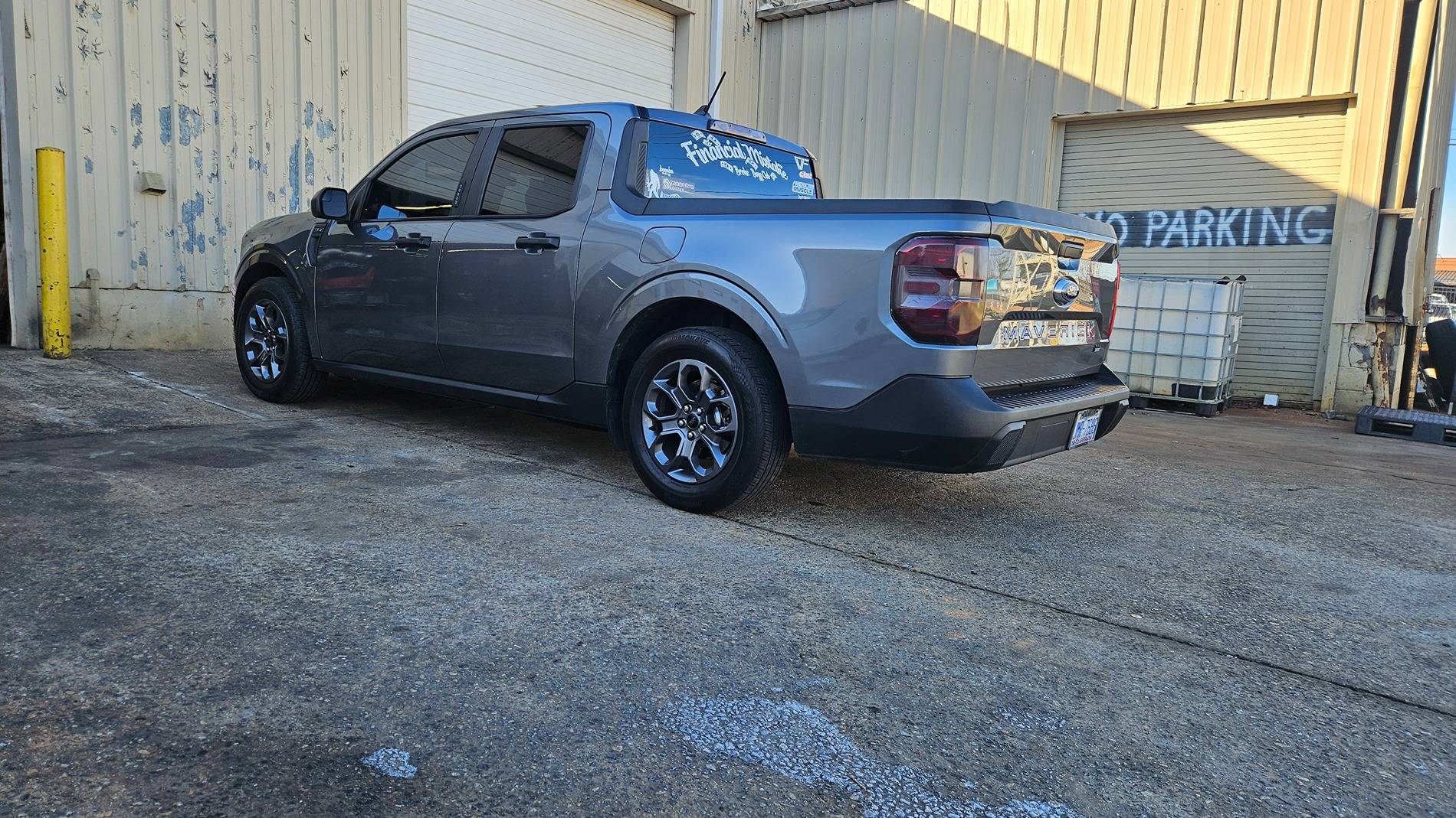

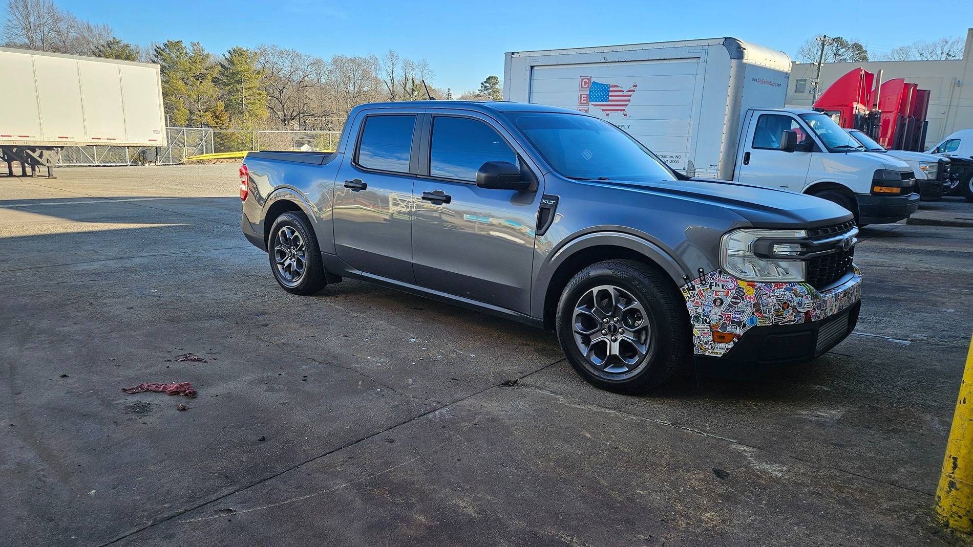

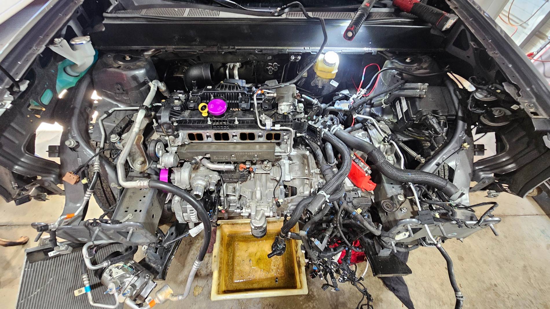

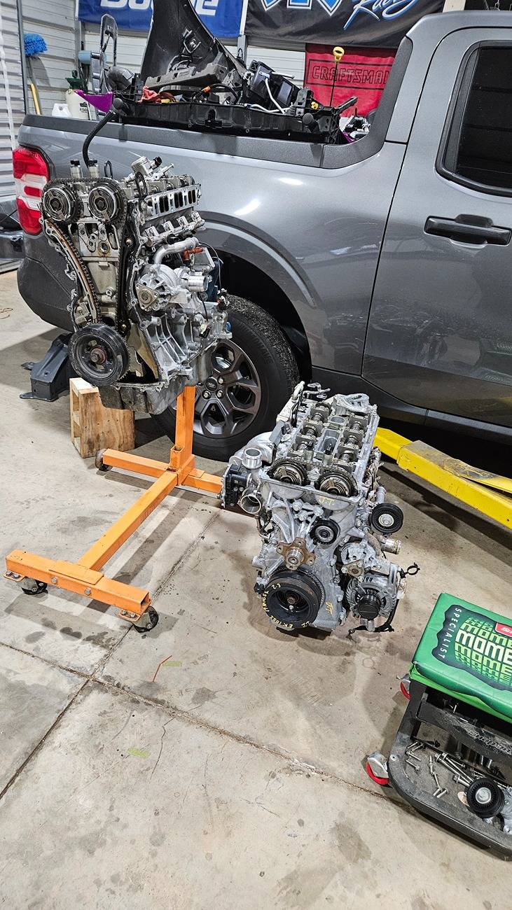

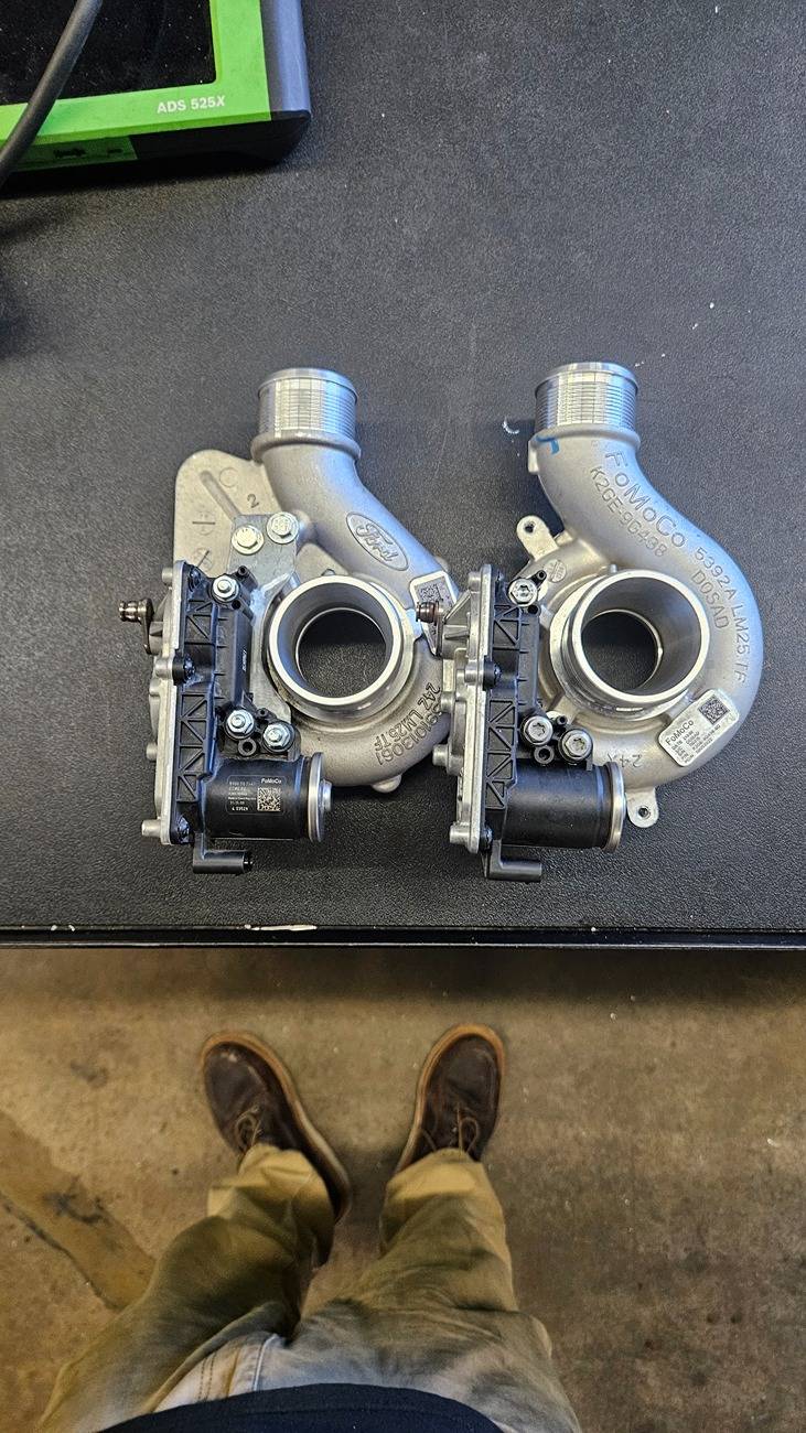

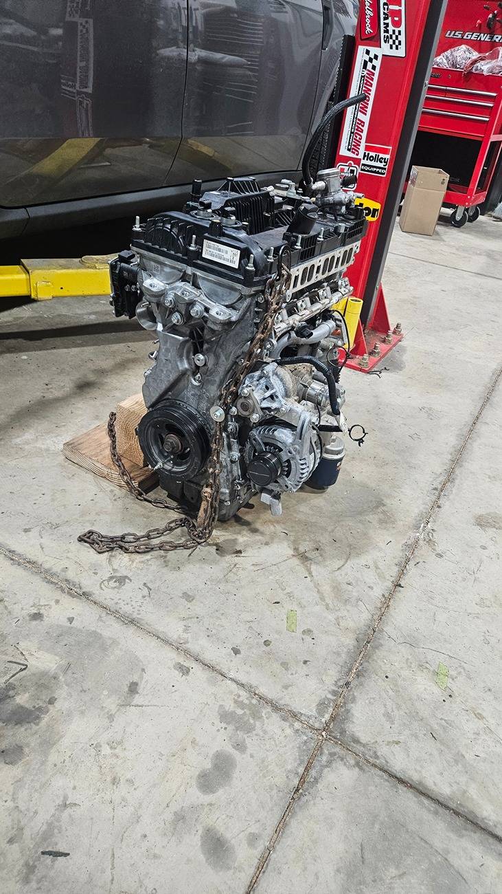

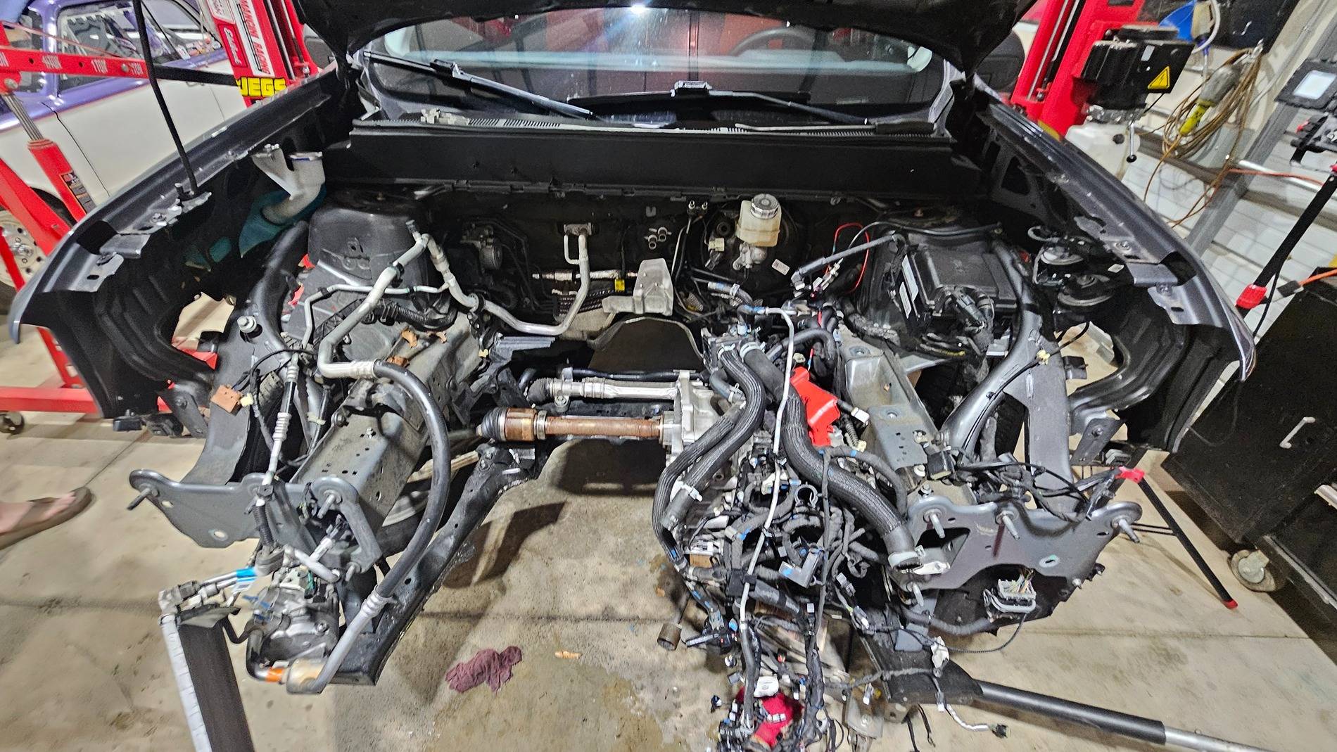

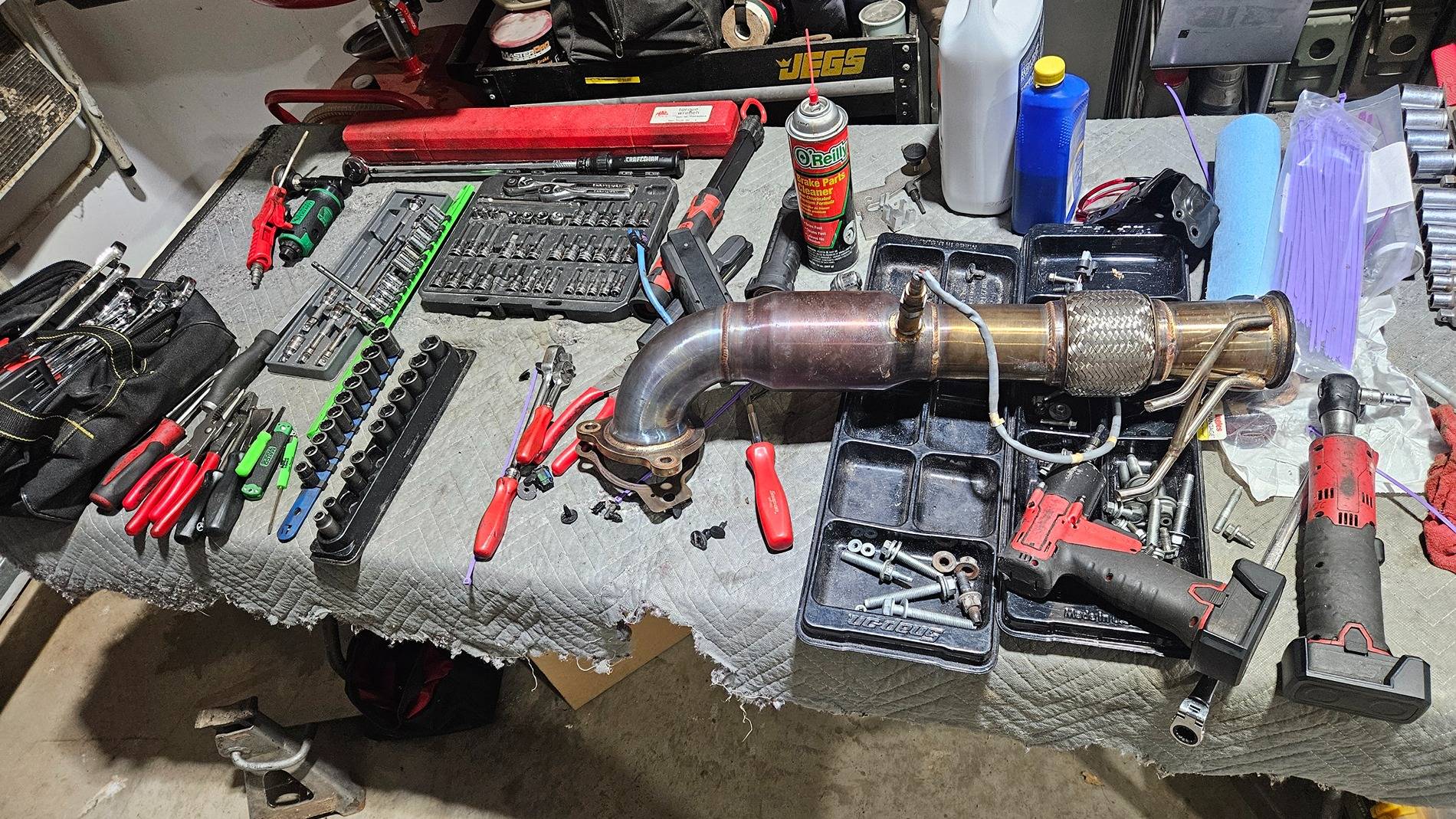

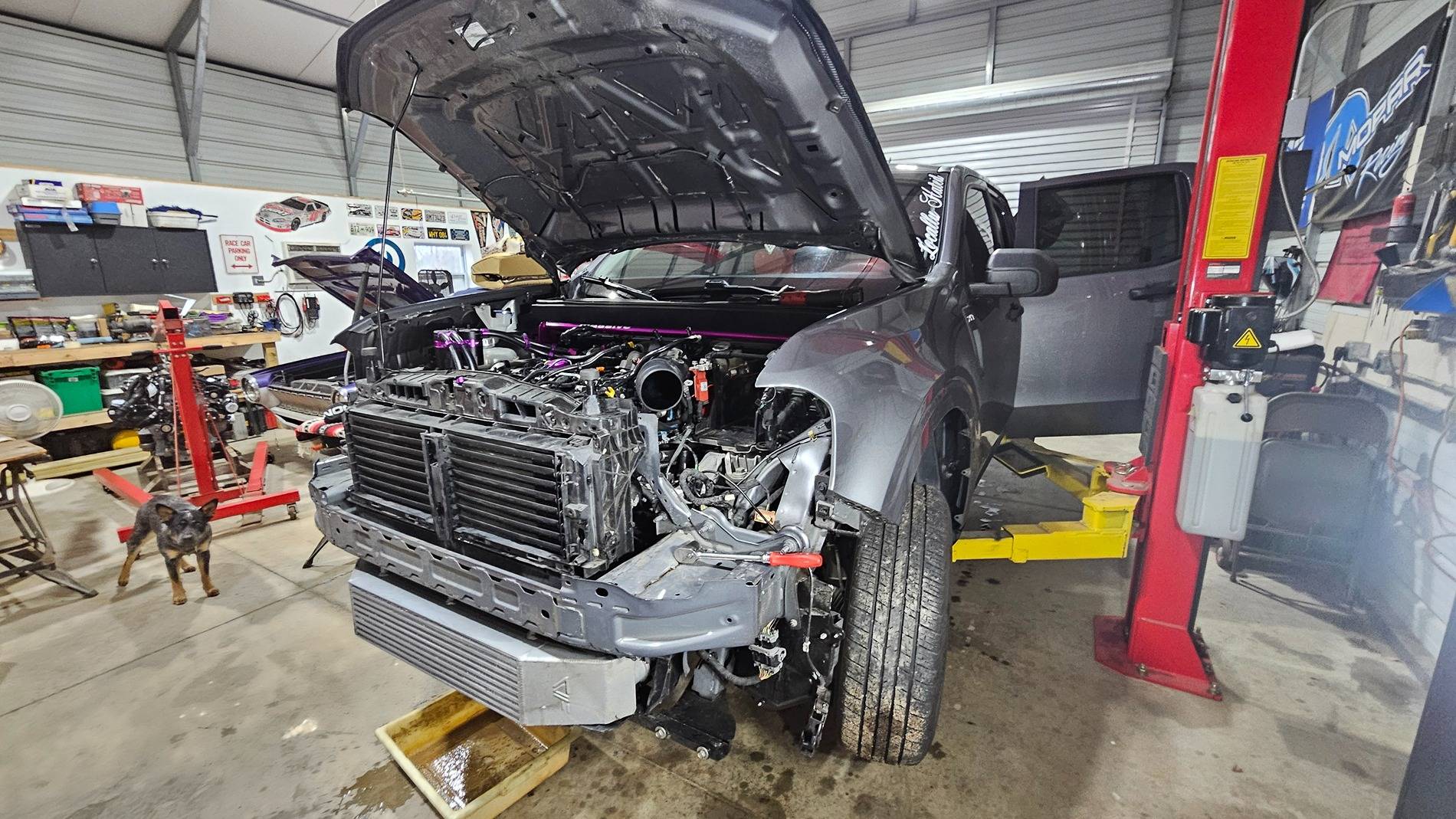

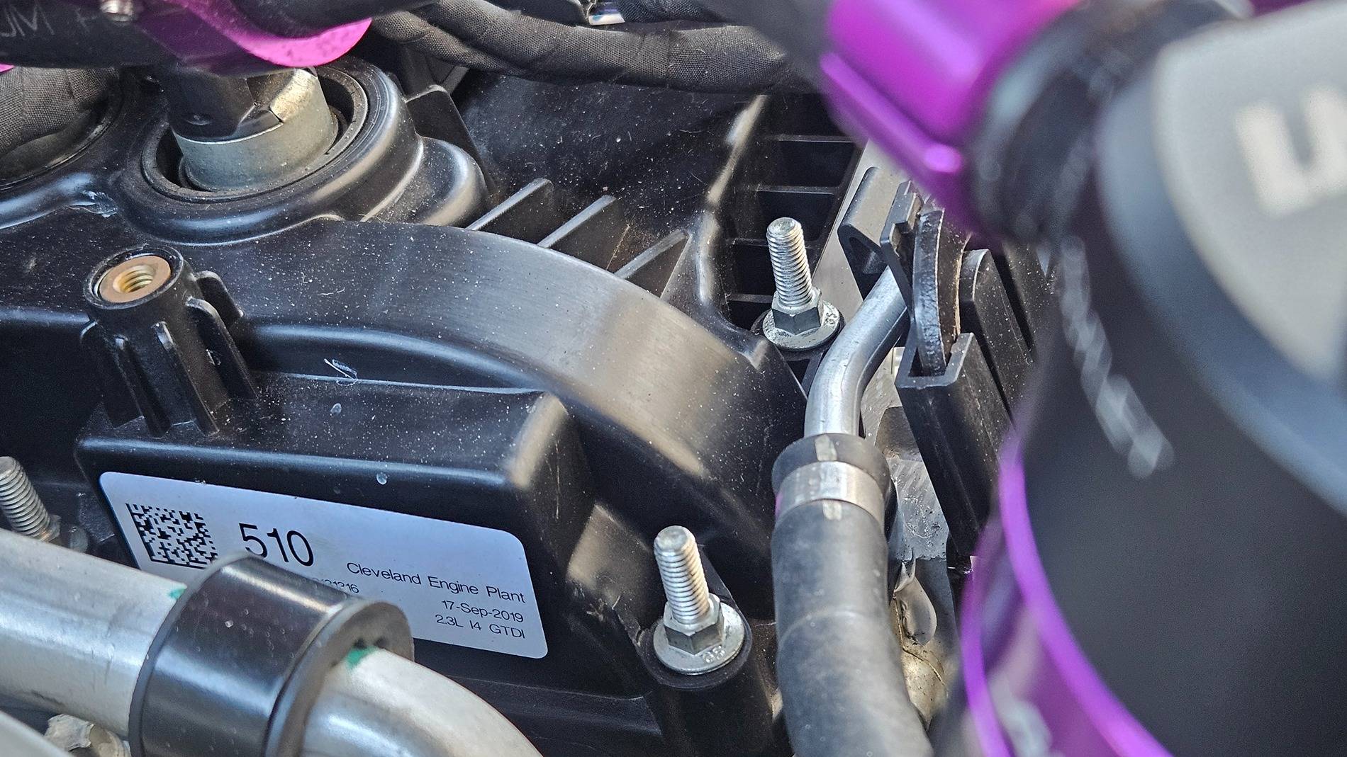

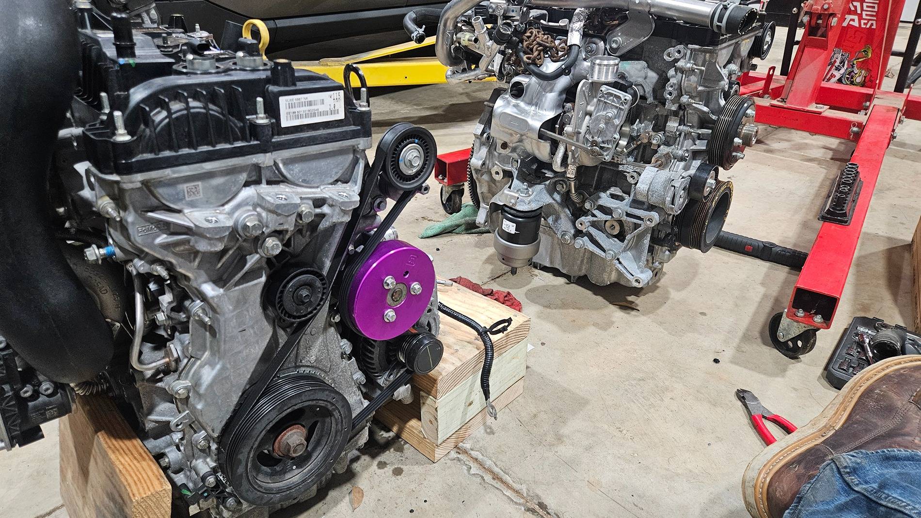

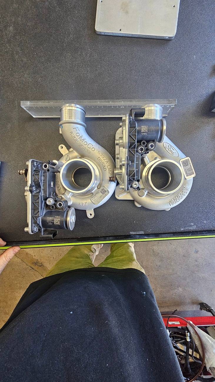

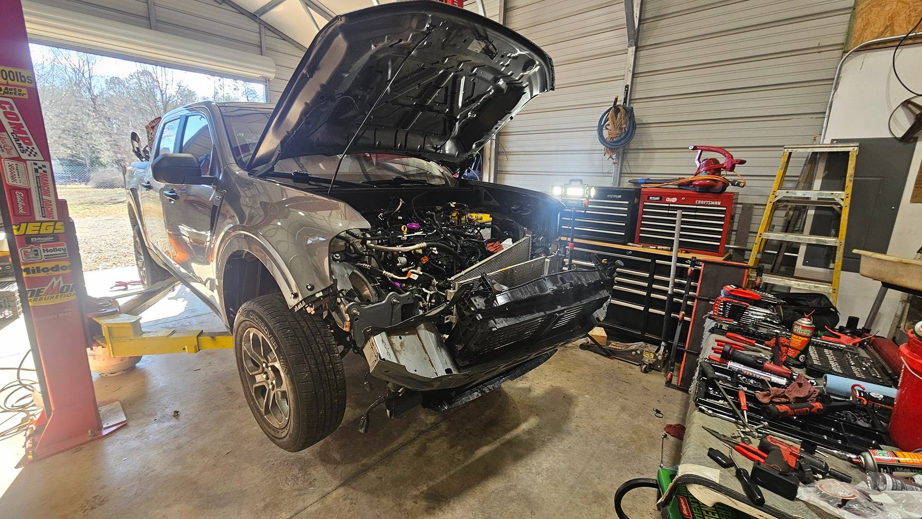

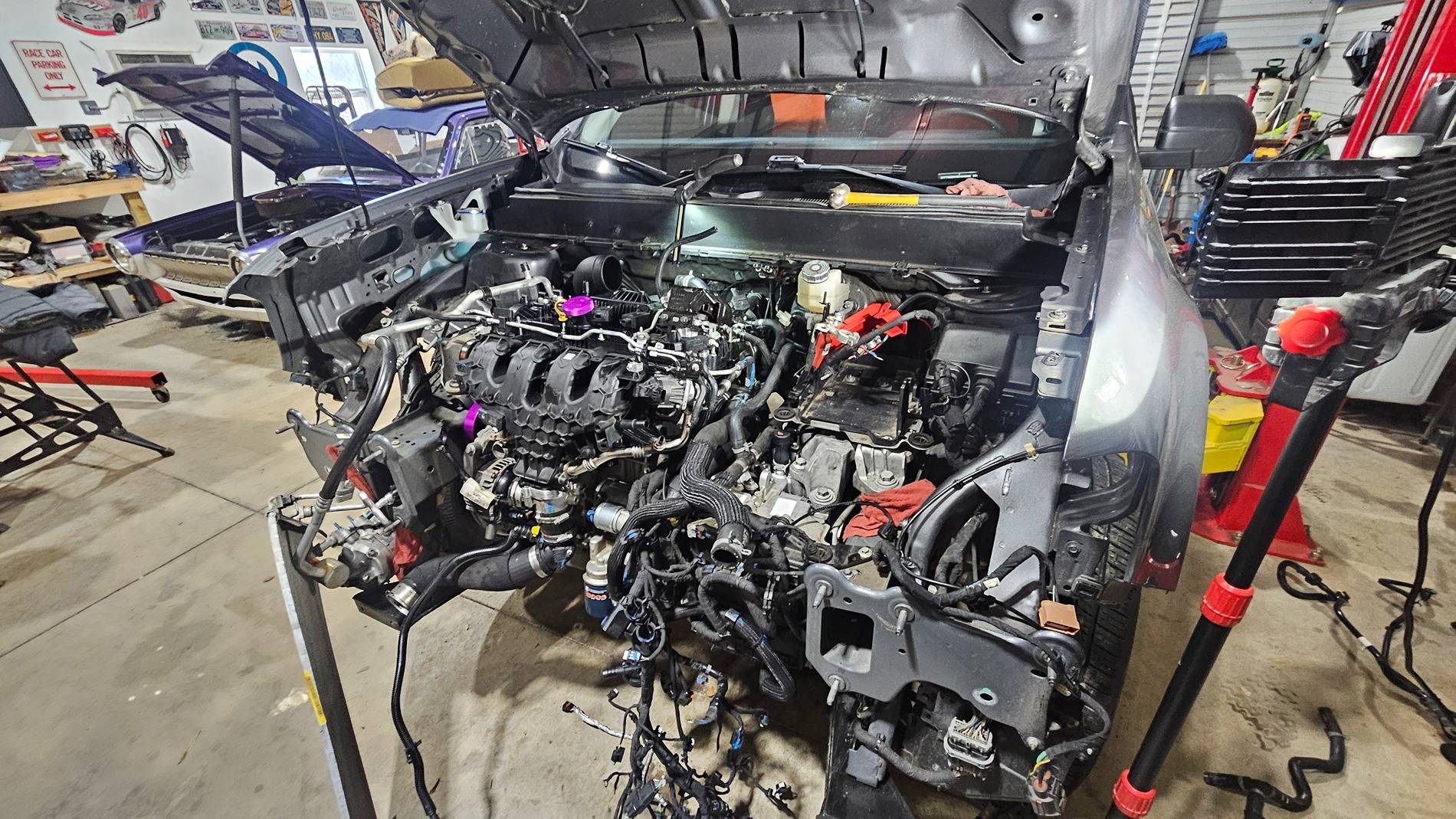

Wow the site is working for me tonight and uploaded! We'll here is a mass pic dump from the past 2 weeks. Pulled out on a Saturday, spent time thru the week swapping everything but the timing chains and head from the 2.0 to the 2.3. Past Saturday I had it back in and running. Sunday and early this week I sorted out the larger turbo actuator and linkage. Drove it home last night and to work today. Perfect! Strut bar is Massive Speed Systems!
