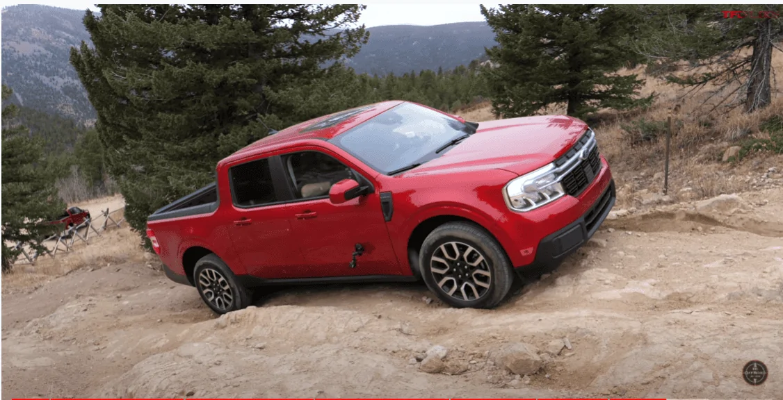

TFL did a segment on how capable the AWD 4K equipped Mav is. It was more intense than I will ever go off road so for me the 4K tow package seems like the better trade off versus the FX4 option.
I mean come on just look at this pic. How man of us will really do this much off roading? And if you do the AWD 4K tow package will handle it no problem. To me the FX4 is more of an appearance package. Sure it comes with some functional stuff but nothing a 4K can't handle.
