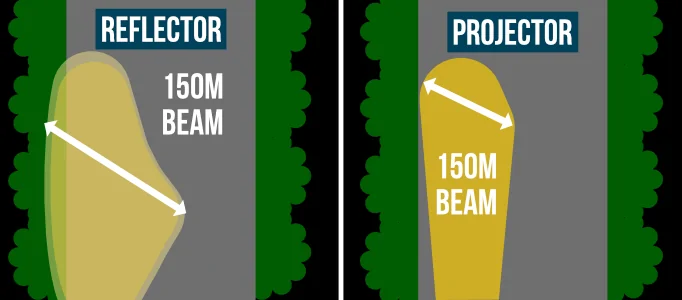

Huh? Many projectors have a much wider useful beam than reflector lamps. Halogen projectors were never the greatest, but HID and LED projectors more often than not have some of the widest beams out there. Of course the width also traditionally comes with larger projector housings, so we'll see what Ford's projector beam pattern actually looks like soon.
Unless you just mean a shorter, wider beam? Less glare above the cutoff.
I'm hoping for similar width but better throw with the lariat projectors.
My understanding is reflector headlights produce a bigger beam pattern that covers a larger surface area as opposed to projector headlights. The illustration below is from the UK so in the US the pattern would be flipped.

It's possible they're talking about glare, rather than any usable light (for visibility to others). The widest beams I've ever seen were from projector headlights - especially HID with 3" or larger diameter projectors. Some headlights will light up 7 lanes of traffic (3 lanes next to you if you're in a 4-line highway and in one of the side lanes). Reflectors are good for about 4-lanes lanes (lane and a half next to you).
Projection (can) also more easily throw light further down the road too, rather than light up the useless first few feet in front of the vehicle - this is not only good for putting light where it's useful, but lack of foreground lighting will also allow your pupils to dilate more, giving you better visibility all around. Of course this also means your eyes will be more sensitive on oncoming glare when you're cruising in the dark and come upon an opposing vehicle.
All that said, most projectors aren't much better than reflectors - there are some good reflectors, and there are some poorly-engineered projectors. I think the <2025 Maverick LED headlights are pretty good for a reflector - cutoff and all. Biggest letdown on most automotive headlights today is poor CRI, but that's mostly an issue with offroad in the dark. Of course most aftermarket flood lights are even worse on the CRI than factory HID and LED headlights. Not everything should have horror-movie grayish casts ;)
