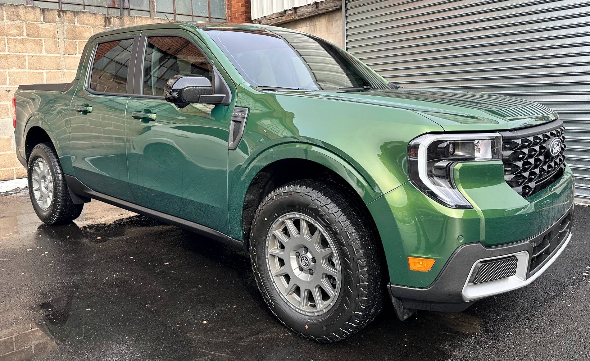

I love my Wildpeak AT Trails. They're a great tire.
Ford Maverick 2025 Maverick Lariat Wheel Size IMG_8028
