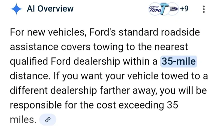

A lot of the time when I'm on the road, I don't have cell service and I'm more than 35 miles from a Ford dealer.
On the road I carry a hydraulic jack, tire repair kit, wheel chocks and my compressor/battery jumper
I would never call FORD!
I have FRVA Roadside Rescue®. It covers my motorhome & all my other vehicles.
Cell coverage is a side issue. Ask me, I live in Alaska. I have a Garmin InReach Mini, Lightweight and Compact Satellite Communicator, that I have never used.

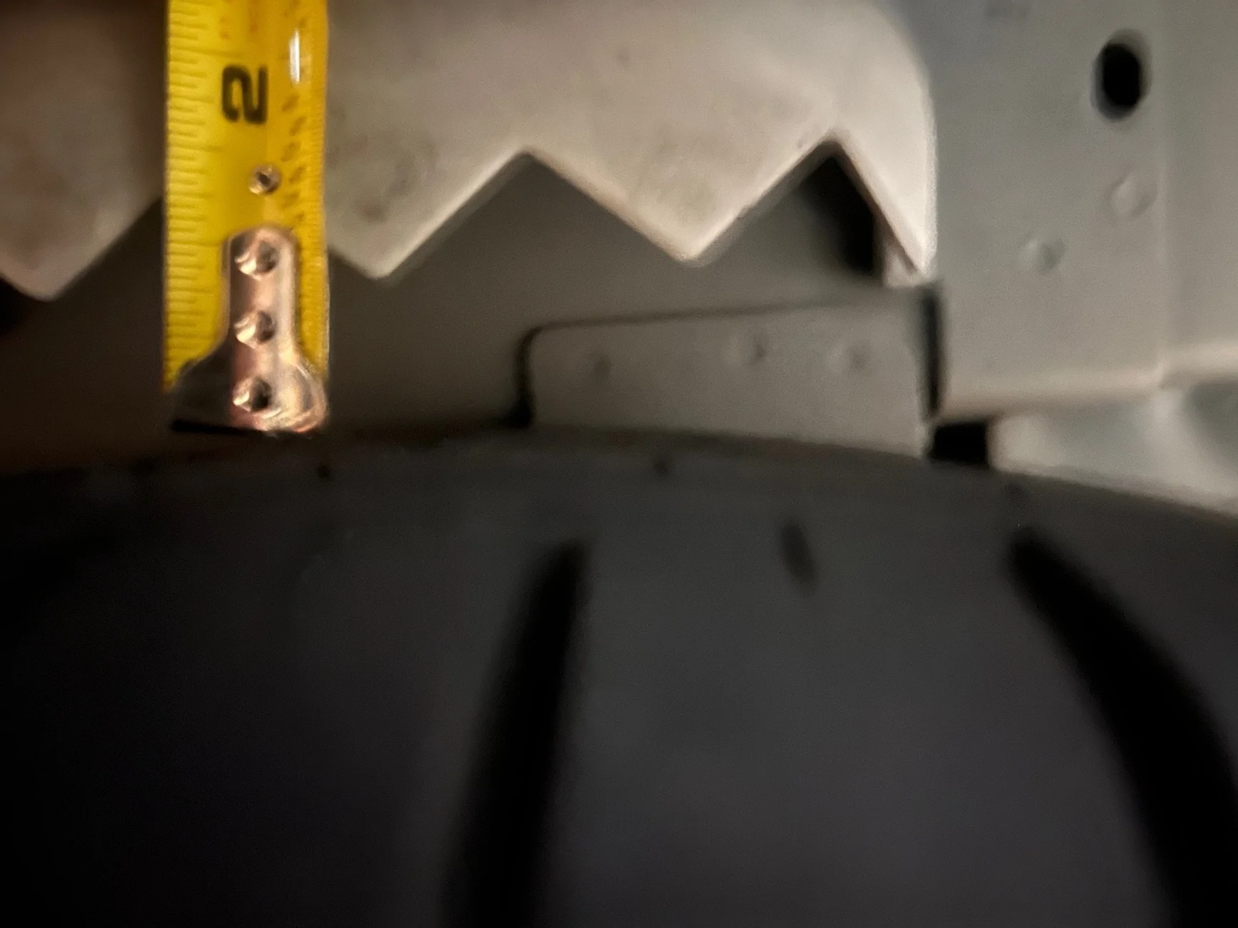

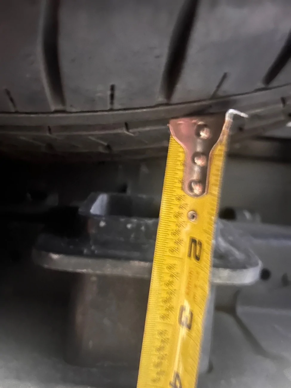

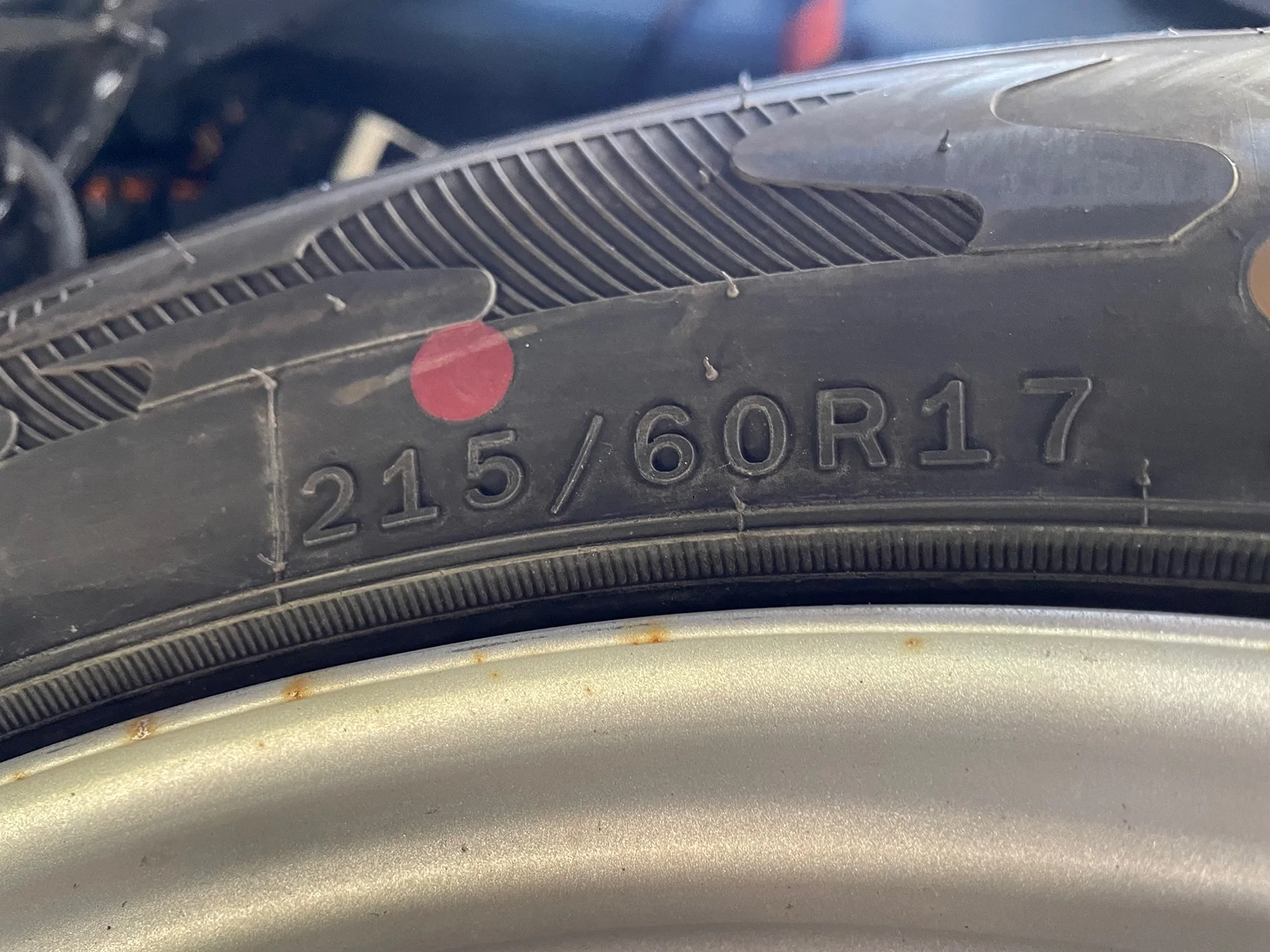

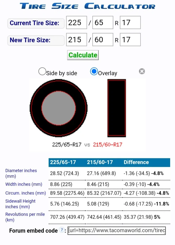

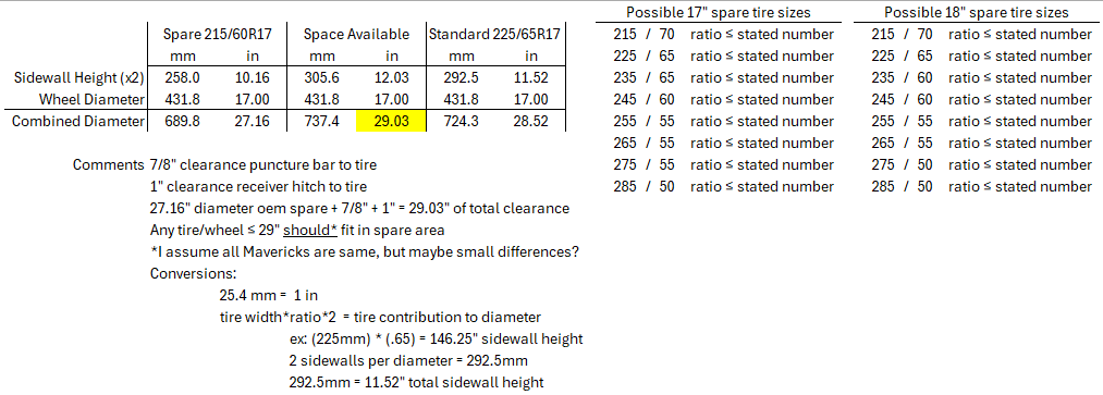

I got my new tires today from Costco and they (for $19) put the best of the original Continental's on a spare rim (Amazon: Allied 83B FWD Black Mod 17x7" 5x108 & 5x4.35, 35mm Offset = $74). Now I have two spare tires; a 225/65R17 on the aforementioned rim and the other, the OEM 215/60R17 that came on the steelie under the truck. Despite what my turbonerd spreadsheet above tells us, the larger tire measures almost 2" higher diameter than the smaller one once in the real world, mounted and aired up. To my credit, somewhere above I did indicate, despite what theory tells us, you can't be sure until you try it yourself.
The new spare mounted and lifted easily into place under the truck, and felt like it tucked into place nicely with no room to spare. Despite phase 1 success, I wanted to remove it to make sure. Yep, it was wedged tightly and wouldn't budge. The words of caution from Glen Baker LLC above, " Trying to wiggle it down passed the tire poppers at 70+ years old while on the side of the road" were gold. Boy was I glad I was doing this in my spare time, in my garage with good weather while in old clothes with my son helping me. I had to take all the air out of it to then pry it from the grips of the receiver hitch and tire poppers while my son lowered the cable. So, in conclusion, my dream of a stowed away true full size spare is kaput.
In my 34 years of driving, I've experienced more flat tires than I can remember. I've been fortunate enough that all but 2 of them occurred in my driveway (or were slow leaks that after inflating, made it home just fine). If this trend continues, the overwhelming majority of my next flat tires will be replaced in my driveway with my truly full sized spare that I'll keep at home. The other 1 out of 10 will get the factory supplied 215/60R17 that fits nicely under the truck.
