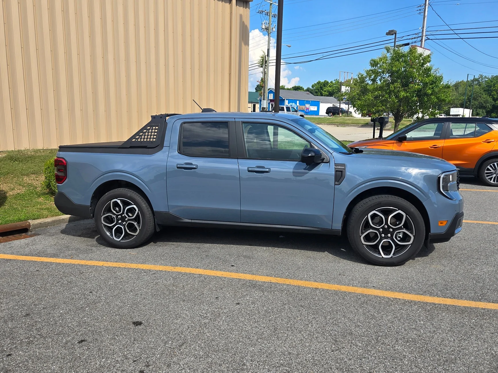

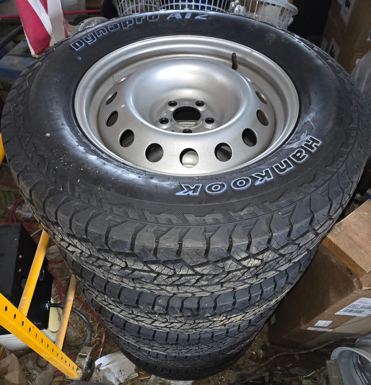

235/60R19 and Rough Country 2.5" full suspension system. I'm running 255/50R20 and they do adversely affect mpg a little. Especially at the door placard recommend inflation pressure of only 36psi. Also, if you plan to drive on trails, you are better off going with 17" tires for sidewall height in an AT tread. For my winter tires I selected 235/75R17 Hankook AT2 and the aforementioned Rough Country lift.
Ford Maverick 1st Post - 2025 Lariat Hybrid AWD 4K - Tire Size Question 20250119_140959
Ford Maverick 1st Post - 2025 Lariat Hybrid AWD 4K - Tire Size Question 20250710_170011

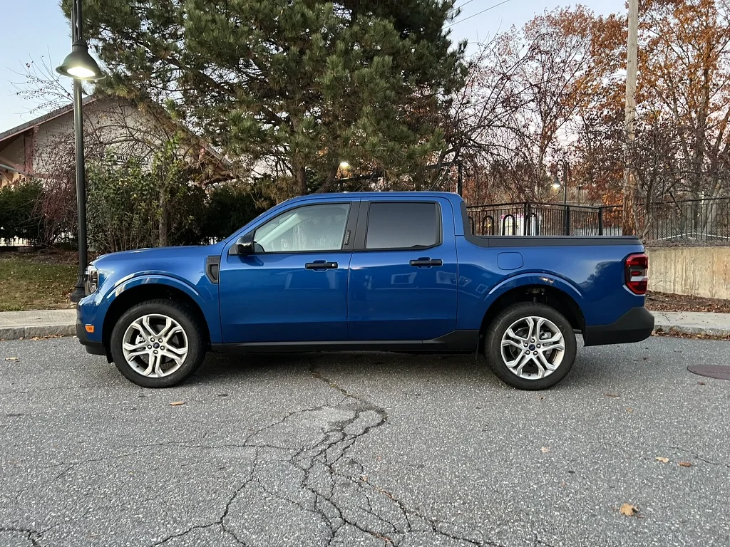

I ran a set of 245/55/19s on my old Edge wheels, which I had in the shed. I only dropped 2 or 3 mpg, and the ride improved.
Ford Maverick 1st Post - 2025 Lariat Hybrid AWD 4K - Tire Size Question 1769026327441-ua
