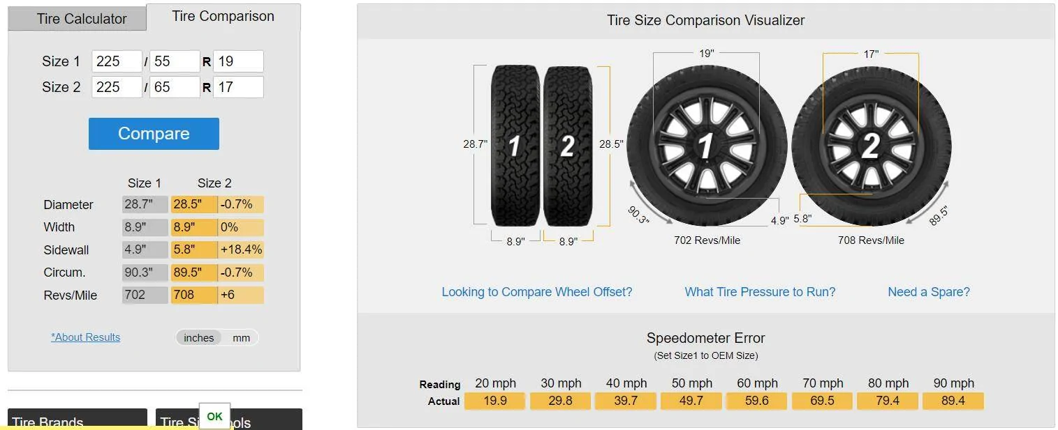

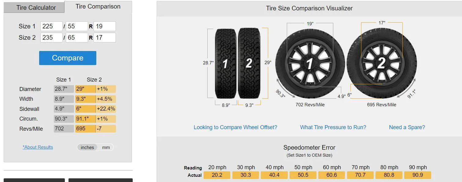

Smaller wheel (lighter than factory) but a larger tire (235 v 225) and the same diameter with a tread with a significantly higher rolling resistance and I will see a hit on MPG.
Attempting to match factory combo of tire/wheel for weight or beat it is the best chance I have to mitigate the MPG decrease.
In no scenario can one replace the hybrids low rolling resistance primacys and an aggressive AT tire and realize an improvement.
For our geographical location, getting 3PMSF rated tire is worth the 1-2 MPG hit. Leaning towards 225/65/17

Absolutely my goal will be to use the lightest 17” wheel and lightest 235 AT tire (highly rated) to hopefully off set the impact.
No reason to buy an AWD hybrid just to torpedo efficiency with some 255 monsters. Also would further stress the weak CV axles as is.
235 Wildpeaks were just fine on my tremor.
