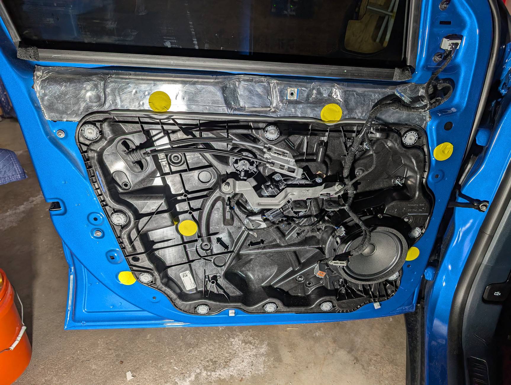

Midbass in the doors, not great, who would have known. I might be a bit overly critical, for the most part they are great, but on certain songs with lots of info in the lower midbass range, they get a little unhappy, and vibrate the door panel. I thought I could live with the compromise, but I cannot. I have been researching options, and landed on adding a front sub. This does a few things for me. 1: it removes energy from the doors, 2: it should allow me to keep the volume up on those heavy midbass songs, and 3: I am hoping to gain or keep the same level of punch, but lower the bass slightly. Not sure exacly where it is going to go yet, I am hoping it will replace the glove box without taking up any leg room.
Enter the Stereo Integrity BM-11, I picked this up used. In my research, this modeled the best, and has a great reputation, I feel this will do exactly what I want. Currently the Morel Hybird MW6's are bridged off of the Morel MPS4.400 giving them the potential 200W. I will be switching them to a single channel output, and run the BM-11 bridged instead. One thing that works out is the BM-11 has dual 2 Ohm coils, allowing me to bridge it at full power. The Dayton LS10-44 has dual 4 Ohm coils. It modeled OK, but the BM-11 still edges out. The other option I found was the SB Acoustics SW26DBAC76. It also modeled well, and was in a similar price point as the used BM-11. I think either would have been fine, but I decided to go with the BM-11 due to the great reviews it has had.

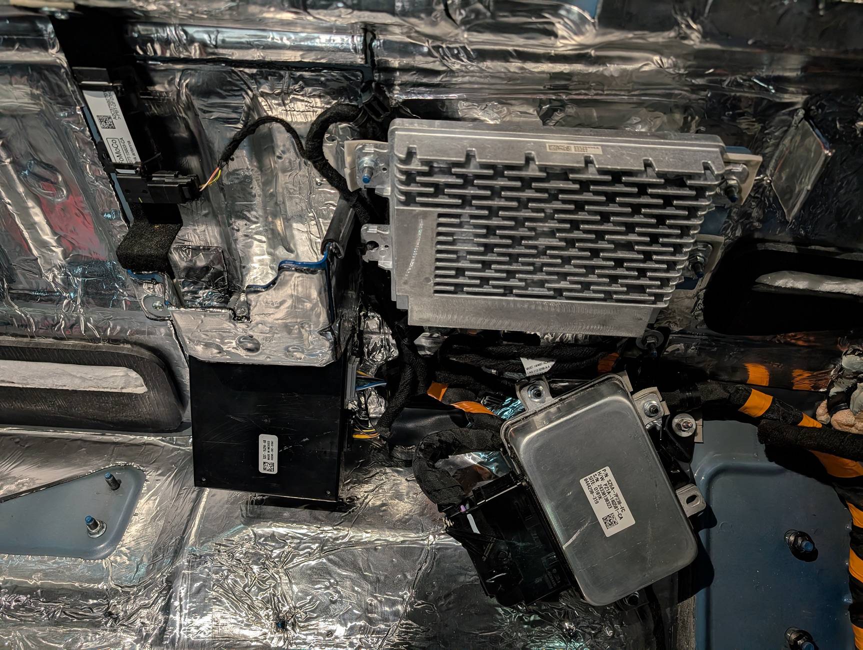

I also added load resistors to the front speaker outputs.
Built a harness using some left over parts from the PAC T harness
Ford Maverick 2025 Maverick Build Log PXL_20260413_014149320
Soldered in the other half into the T harness
Ford Maverick 2025 Maverick Build Log PXL_20260413_014303426
Used some velcro to attach the resistors to the top of the ACM
Ford Maverick 2025 Maverick Build Log PXL_20260413_014809531
Buttoned up
Ford Maverick 2025 Maverick Build Log PXL_20260413_014858185

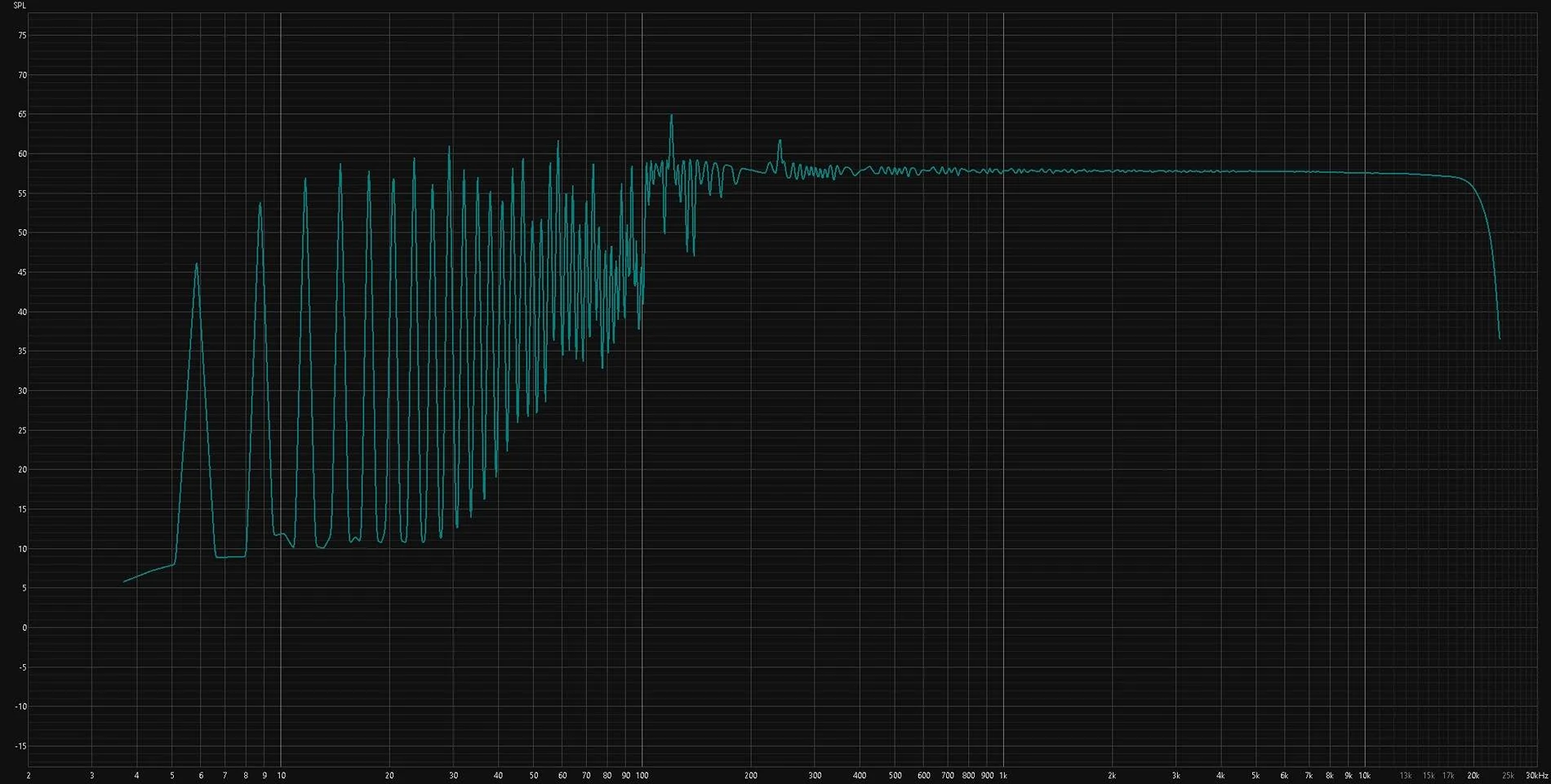

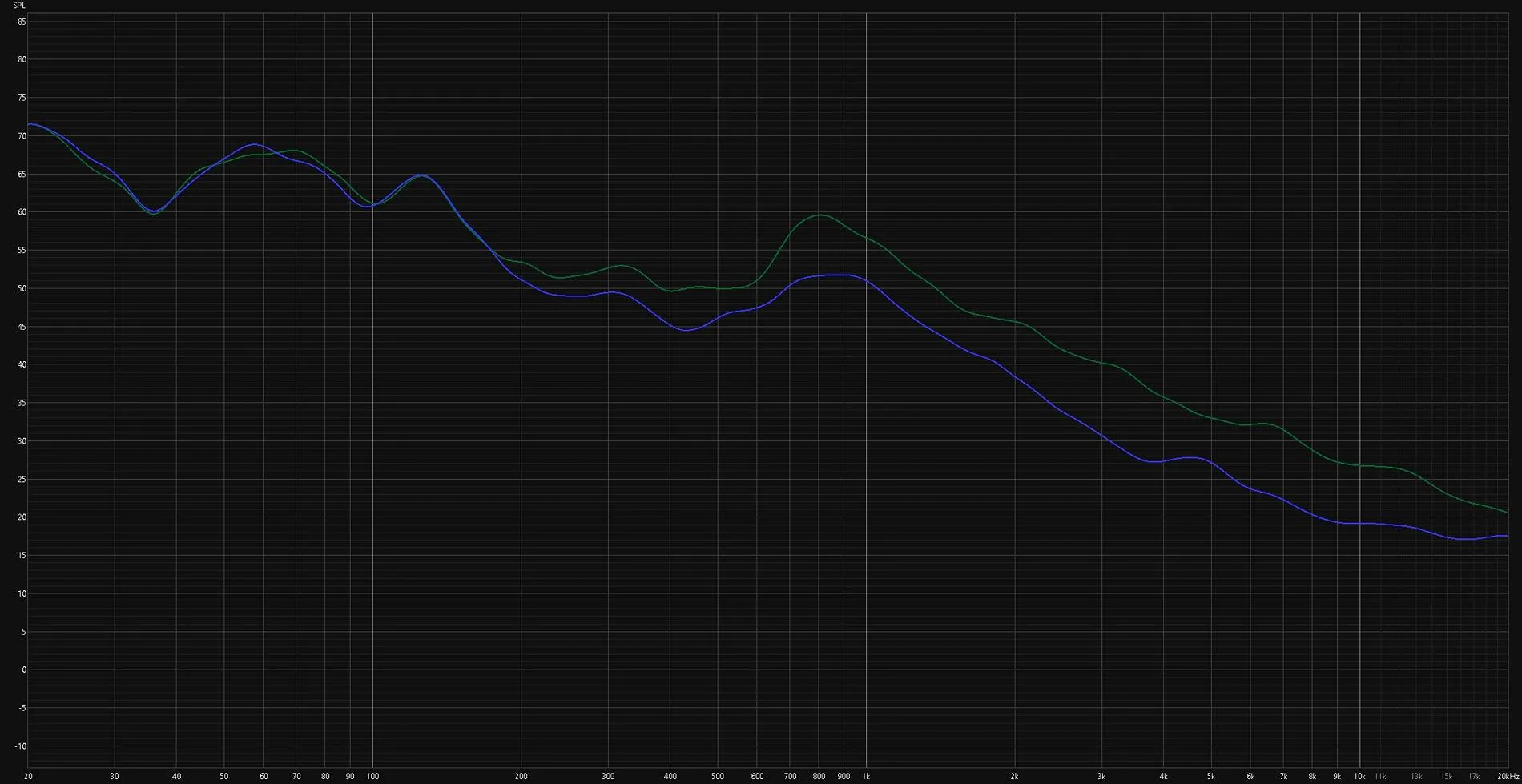

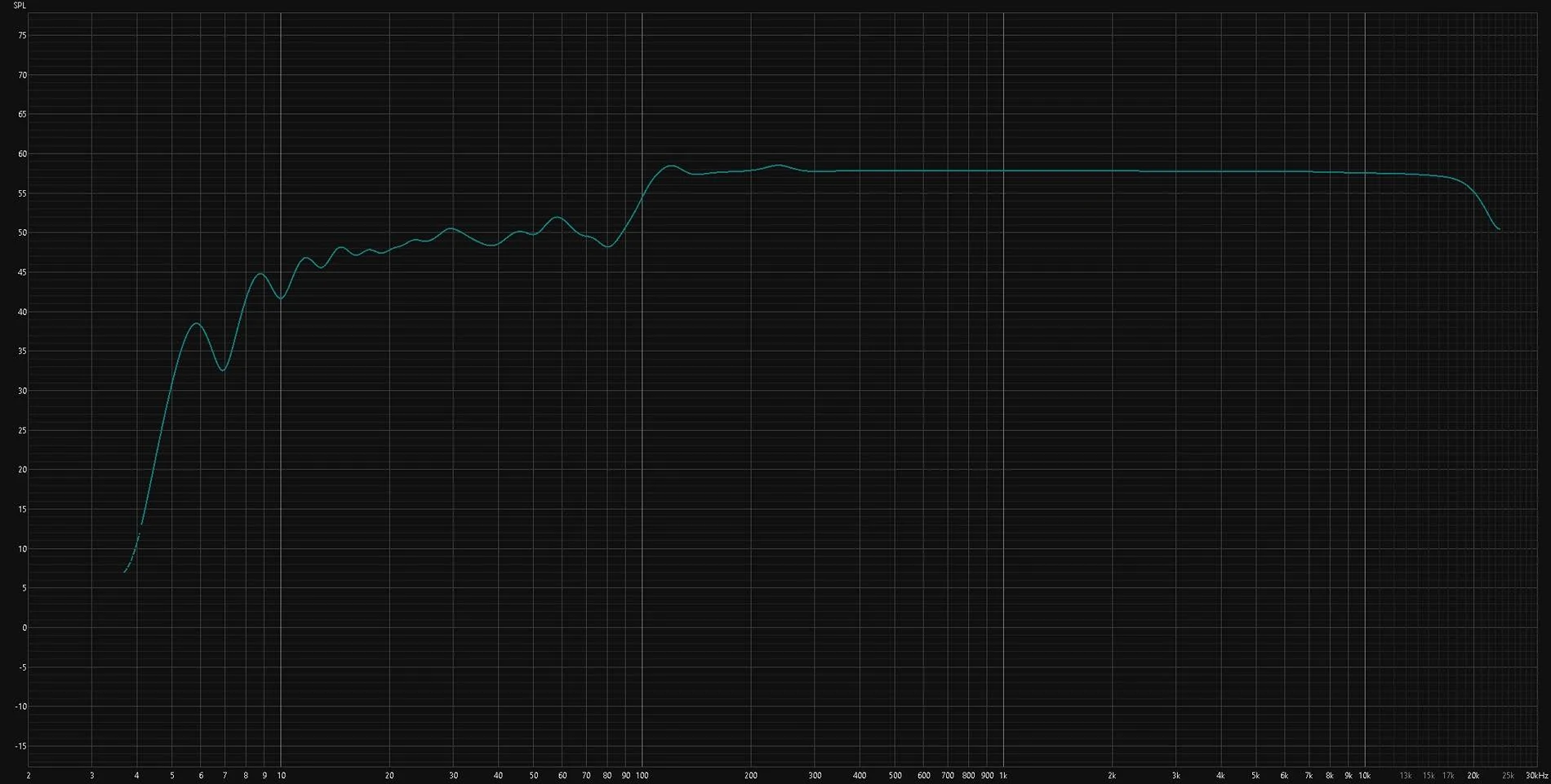

I have been noticing some issues with the sub with a resonance or peak in the upper bass frequencies. I want to say it started after one of the last software updates. I took some RTA measurements of the input signal and it was nearly flat, with a slight roll off starting around 30Hz. I looked back at previous measurements and it was significantly different. I am unsure on how this is different from my original measurements, but I am not going to complain.
I need to re-tune after I install the new mids so I didn't spend a lot of time making adjustments. I did clear out the EQ settings for the subs and took measurements. Everything looked good so I just ran with it. It does sound much more natural. This is a big relief and I look forward to re-tuning.
