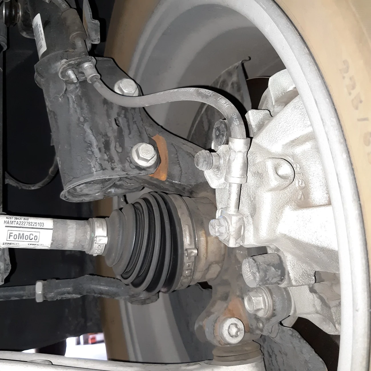

Ok - appears you have good weather for pictures?
I do hope not crawling around.
I'd hate to see a post about "I'm trapped and I can't get up!"
I'm curious what the angle looks like on a typical residential speed corner, as a compare?
That way don't even have to get on the ground!
I can't recall ever noting how much I turn the wheel for that type of corner - watching traffic too distracting I guess.
Obviously turns aren't normally the brunt of a driver's axle turning time, but for some sure could be a higher %.
I figured while I was down on the ground, I might as well take pictures.šŸ˜‰
Ford Maverick 2025 AWD Hybrid CV joints failing? 20251008_094923
It looks as if I lowered my Maverick it might actually straighten the angle out. If I were to lift or raise the truck that would increase the angle even more than it is.
Nice pic.
So able to see on that what you really need to be careful doing is removing the pinch bolt, bottommost bolt there faced towards us, on the top of the balljoint to steering knuckle. Releasing balljoint from there may allow knuckle to move outward and pull on the axle due to spring. Now if it comes out far, either the axle is real tightly seated into the diff in the housing and you pull the CV apart, or it isn't super tight and pops out before the CV separates and now you're swimming in transmission fluid. So yeah, working on that, take extra precautions, chain bottom of strut back to something so it can't wander outwards.

Bert,
Here's a picture of the front axle of
my factory stock 23 Maverick hybrid XLT.
As you can tell it is already at a slight up angle. As a Layman, I would expect any lift to the body of the truck would increase this angle. That all said, I don't know if CV joints work their best when they're at an angle VS being straight or how much extra wear happens when the angle is increased.
You may want to take a look at how much of an angle your axles are already at on level ground. šŸ¤·ā€ā™‚ļø
Is it my eyes playing tricks on me or is your boot starting to leak at the housing at the top of the clamp? With all of the threads and horror stories I have read about the tell tale signs of the beginnings of CV joints failing, leaking from the boots is one of them. Not to alarm you, could just be regular road dirt/gunk that has accumulated over time, but it is a different complexion from the rest of the shaft. Anymore with me, when inspecting my shafts I am getting like the kid in the 6th Sense movie. ā€œI see shaft failures.ā€ Please tell me to relax.
Dry as bone left in the Nevada šŸœ desert or in your case Arizona desert.

Bert,
Rule of thumb for cv’s is that 30 degrees is the max that you should run them. 18 to 25 is considered safe for long term street operation. The bronco raptor has 18 degrees cv angle. The F-150 raptor has 22 degree cv angle. My maverick ecoboost fx4 with 2ā€ lift kit has 11 degrees on left and 15 degrees on the right. Previous MTC posts have said that the right side cv angle on stock hybrids is 15 degrees. I don’t have a hybrid to confirm this.
