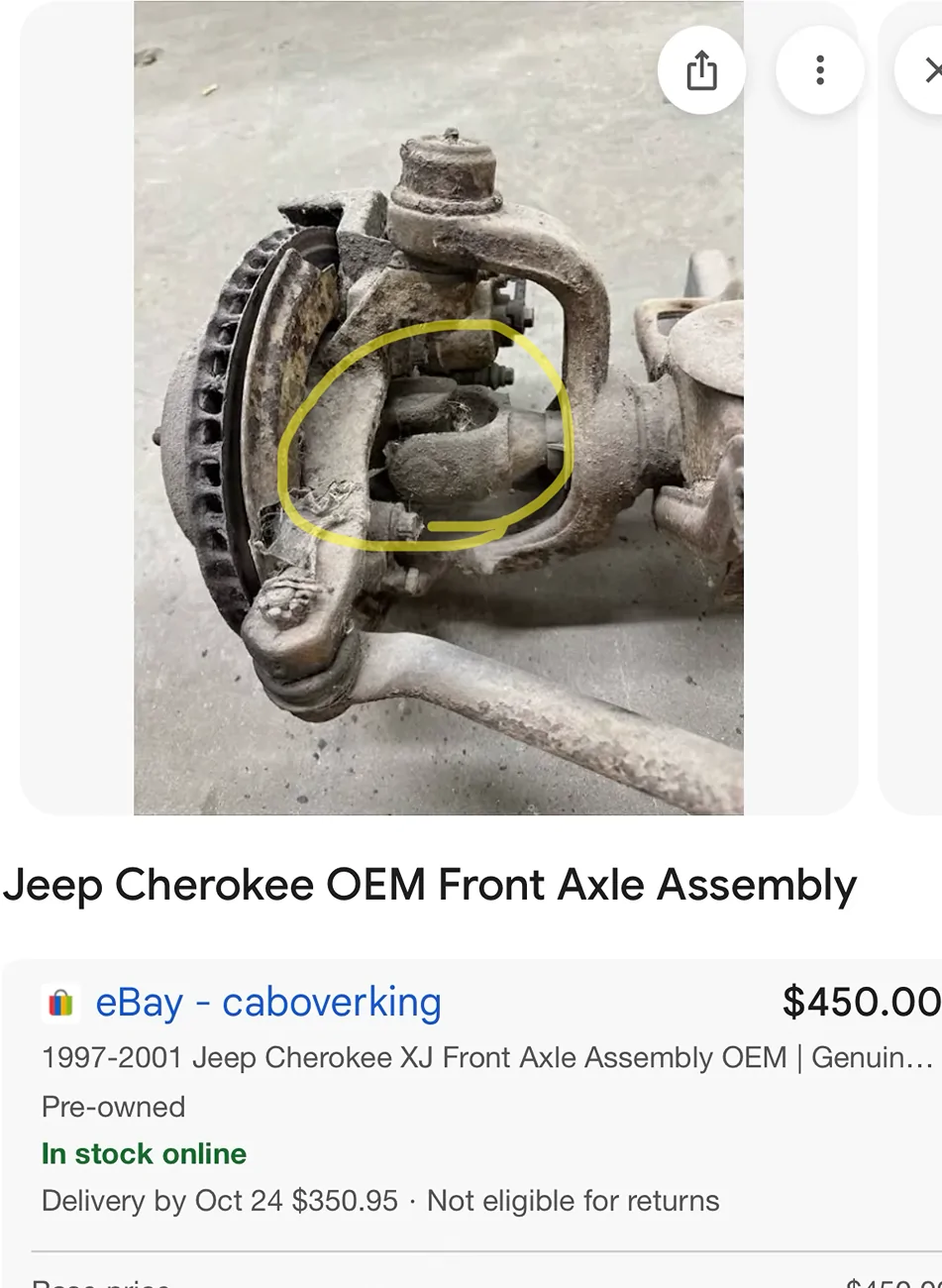

XJ Jeep Cherokees had live axles, it's a completely different setup. You can lift those as much as you want you might get driveshaft issues but never CV joint issues because the axles always stay in line with the center of the wheels ...
PS are the Mavericks with bad axles mainly FWD or AWD, or does it make a difference? Putting 240 hp through 2 axles (FWD) is different from putting it through 4 axles (AWD)
XJ cherokees never have cv joint issues…..
Correct.

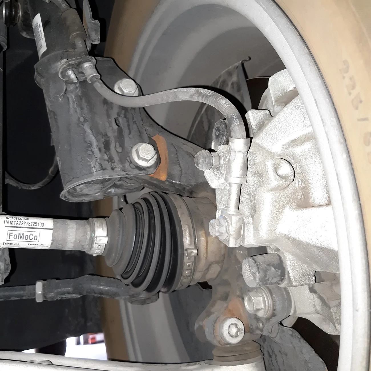

Ford Maverick 2025 AWD Hybrid CV joints failing? IMG_4533
However, the Dana 30 front end in the XJ was well known to be the weak link in its power train and they blew out plenty of u-joints and ate plenty of ring gears, especially in the low pinion models.
