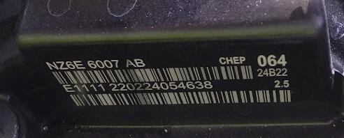

Engine tag spells it out.
Well, in 3 or 4 letters.
Hybrid. (my truck mfg 3/24, has engine from 2022, Feb 24th, interesting delay in usage. Go engine team! Come on assembly team...)
CHEP - Chihuahua Engine Plant
Don't have picture of EB.
VEP - Valencia Engine Plant
Maybe you got one of the holdbacks when they were unsure which ones had the "engine FIRE build" and they finally cleared it!!!😁
