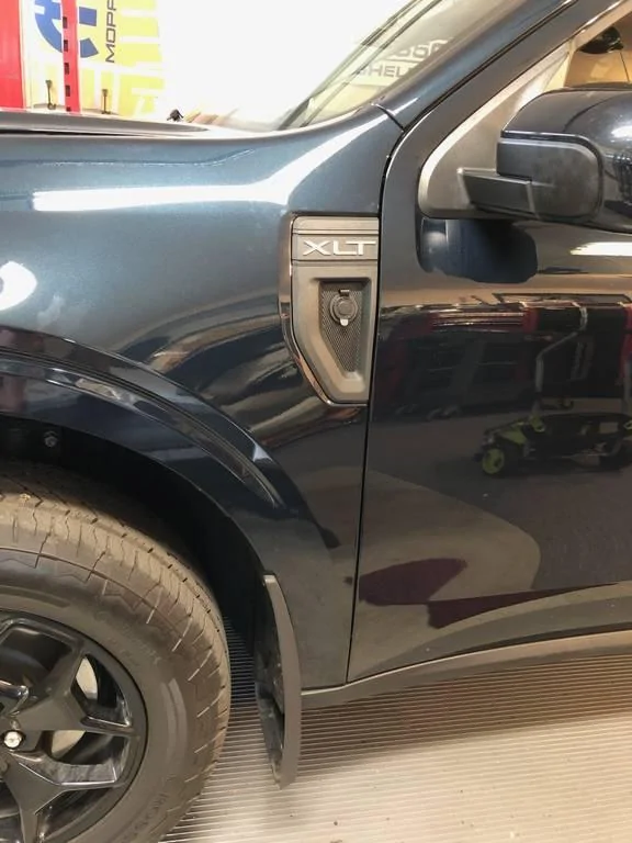

Does anyone know how many Amps you need to supply to close the circuit and engage the hybrid battery for 12v recharging? I'm just wondering if something like that side install can properly handle the current necessary for a "jump."

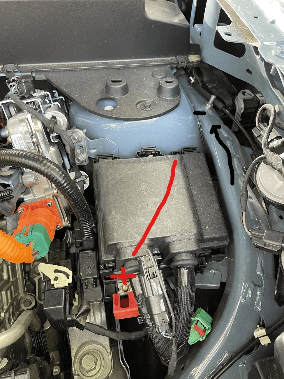

I’ve been getting phone notification of battery sleep mode. I dont drive often and apparently the battery doesn’t like it. I want to install a trickle charger to keep battery charged. Where do you hook up cables? Thanks 2024 hybrid lariat.
Here is a pic I took of the jump locations.
That is not for jumping. It is to trickle charge.

Thank you. I looked in manual and couldn’t see the positive location.
Not the best picture in the B/W Manual. A picture however is worth a thousand words ;)
