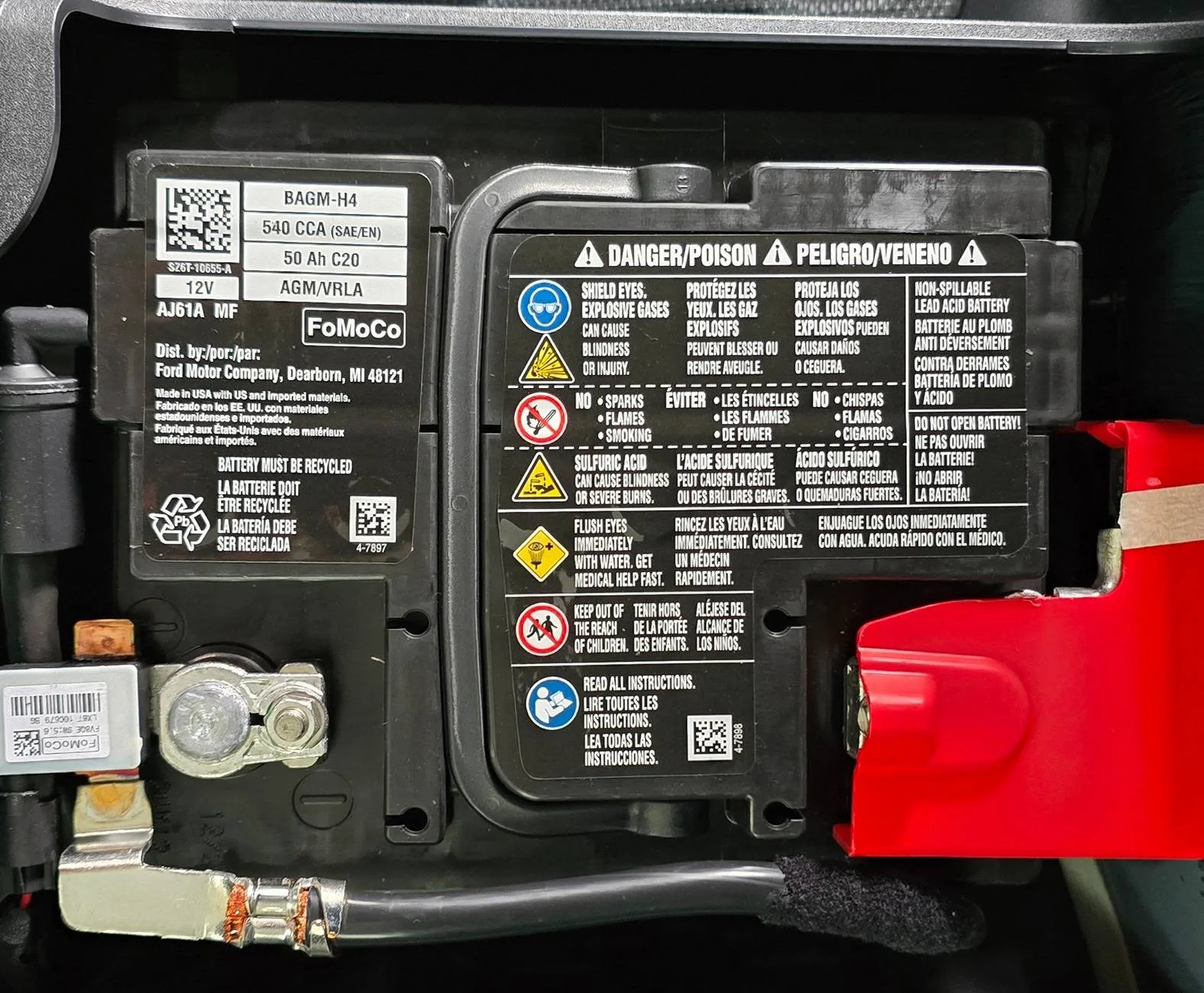

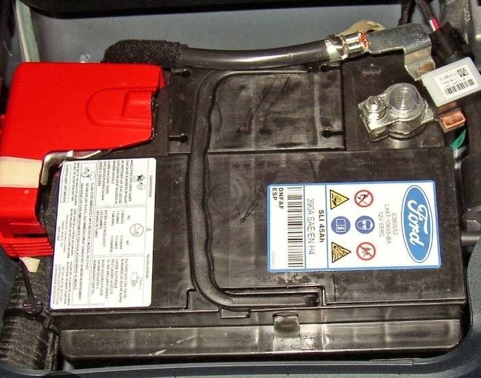

The battery in my 2023 Hybrid was a Flooded Cell, 390 amp/45 amp hr battery. The 2025 Hybrid battery is a AGM 540 amp/50 amp hr battery. And now a US made battery instead of China. A nice upgrade compared to earlier trucks. The 2025 has so many improvements it would be hard to know them all.
2022-2024:
2025:

Good, seems Ford finally decide to do something,,,

Yes the AGM part was known.
But - can you get a good closeup picture of that battery sensor label by itself?
Bad foundation to battery charging if the readings are bad.
Curious if it's the same as prior models.
Actually - if you still have the 23, perhaps that picture too. I'll add my 24.
Thanks much.

Mine is the new battery, that is why I said it is a 2025
