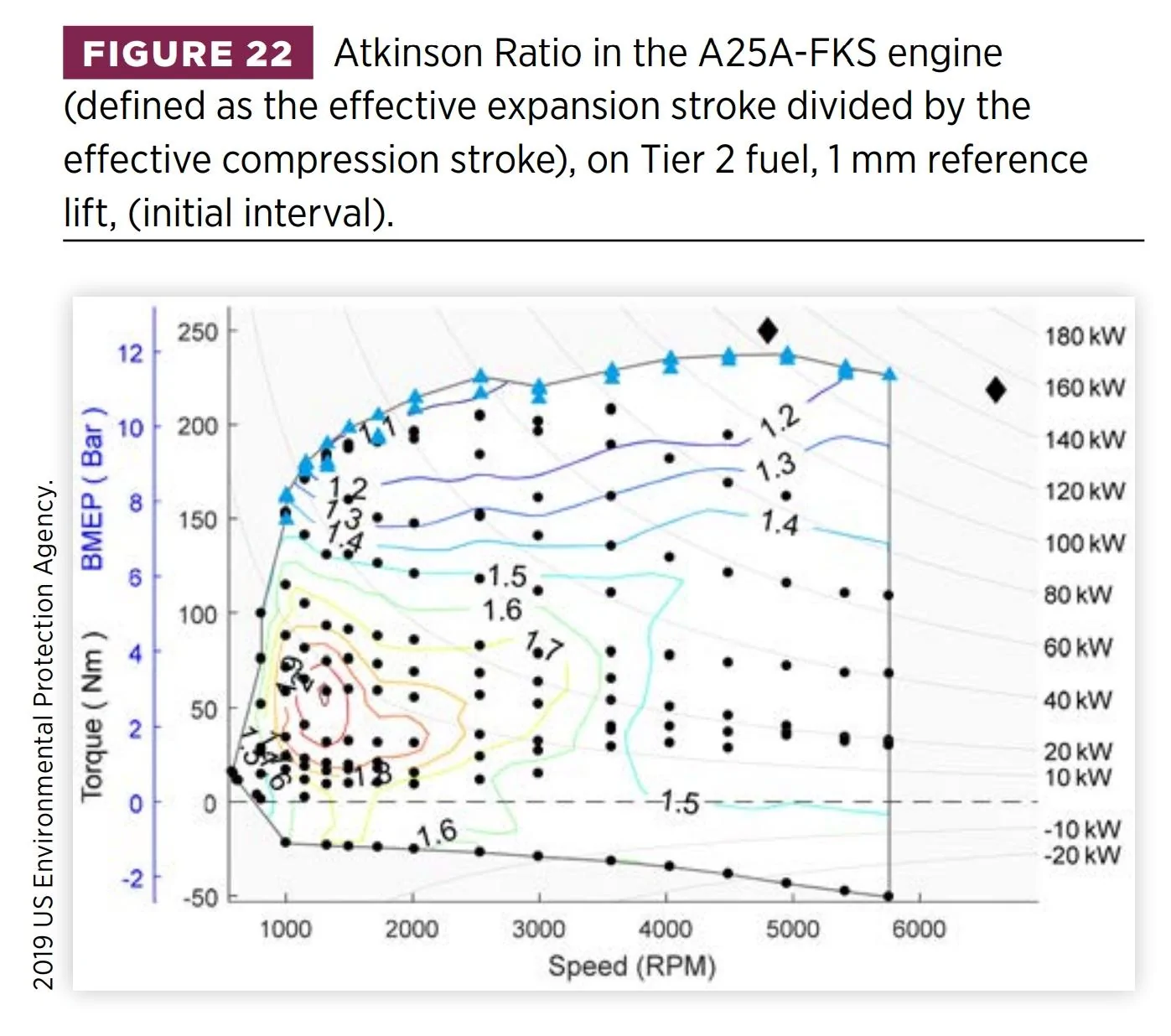

the 2.5 hybrid engine specs that it has 13.5 to 1 compression
the effective CR of this engine is something lower than the listed 13.5:1.

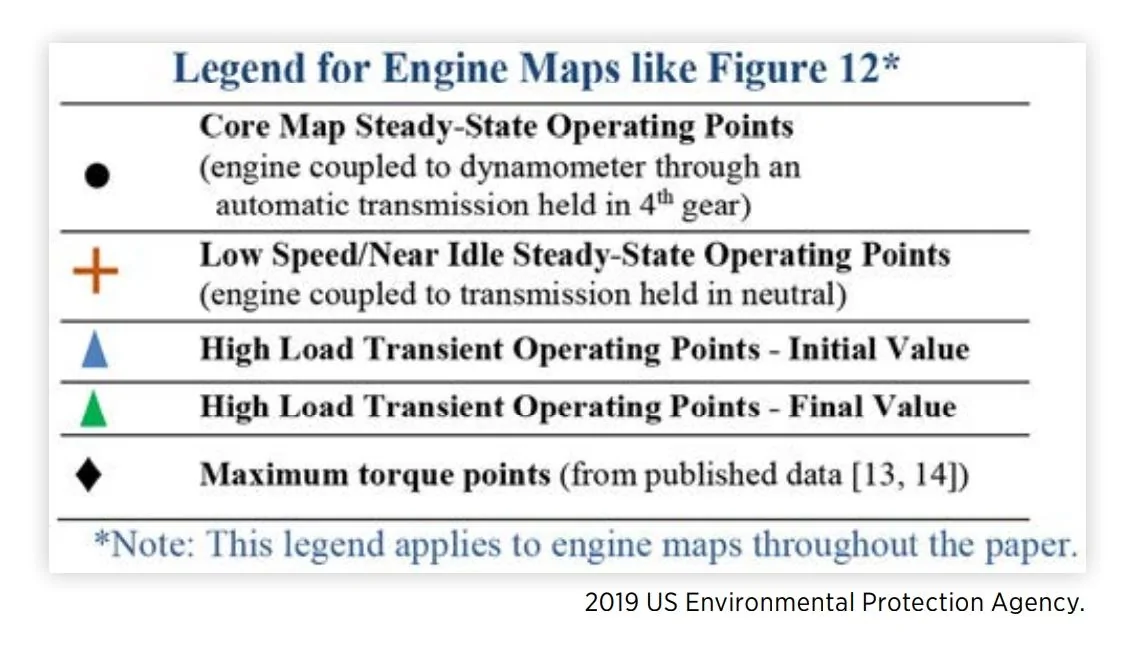

It starts at 90% and drops as low as 50%, which engineers see as twice the power stroke of a non-Atkinson engine. Here's the fill-ratio map for a similar ICE from Toyota, in terms of power stroke/intake stroke (50% fill = 2.0). This ICE gets almost 40% efficiency inside the 2.0 circle.
Ford Maverick 2.5 hybrid engine requires Premium Gasoline? Atkinson Map for Toyota 25L
Ford Maverick 2.5 hybrid engine requires Premium Gasoline? Atkinson Map Key for Toyota 25L

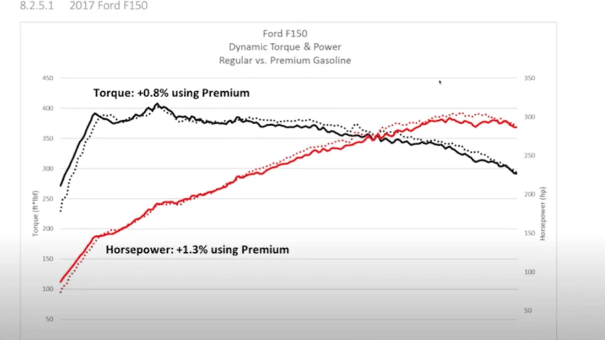

The hybrid doesn't have its own specific manual, it's the same one. And the beginning of the section says the cars are designed to run on 87.
Take a look at this chart for the 2017 F150 3.5 Ecoboost - another car that "recommends" but does not require premium, test ran by AAA:
Ford Maverick 2.5 hybrid engine requires Premium Gasoline? F150EB
Now you can't exactly extrapolate this data to the Maverick and assume it will be exactly the same, but this is a good representation of how little return you get for the extra outlay that premium fuel costs (which is .70c more per gallon in GA).
You think you'll feel the difference in a Maverick Hybrid if instead of 155tq it has 153.75tq? You think you'll notice if your 191hp is 188.5hp?
I won't. Premium is a waste of money in any car that does not absolutely require it.
