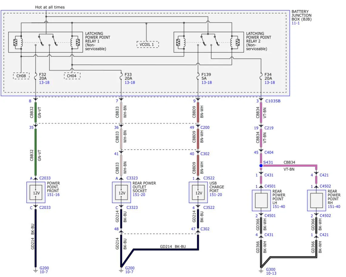

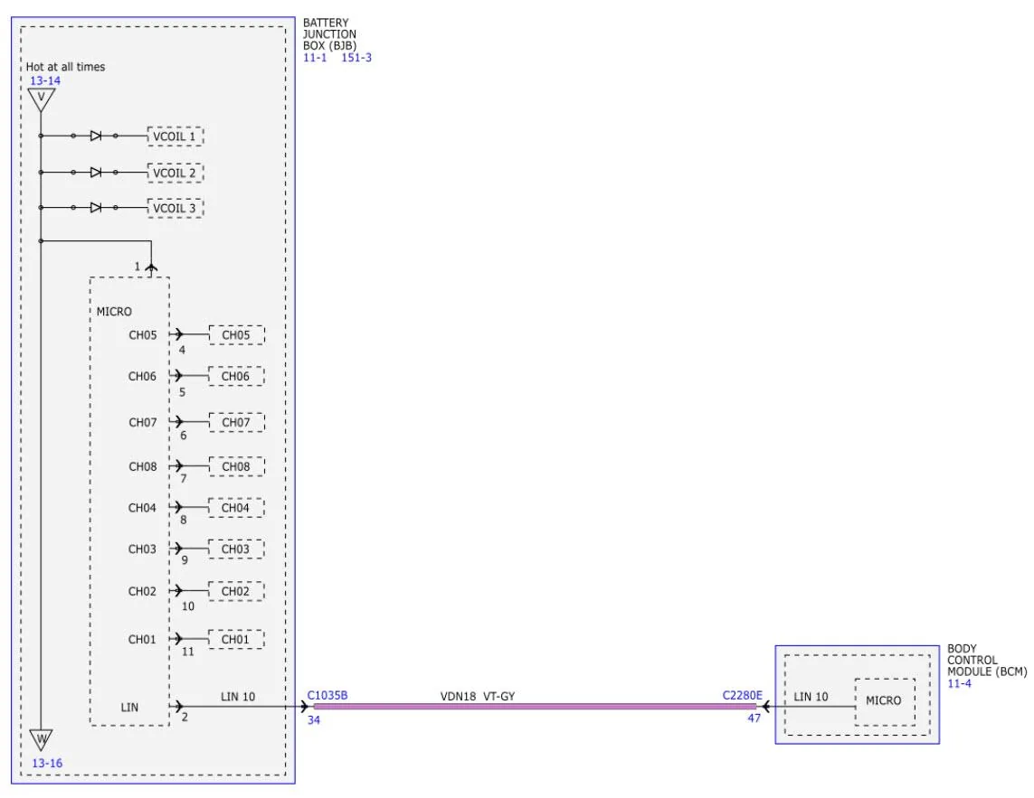

I wonder if the BCM is keeping the power point latching relay Reset.
The diagrams for the relay show a Reset coil and a Set coil that the BCM controls thru a microcontroller on the BJB circuit board.
I've noticed mention of pulling off the battery for awhile to reset the BCM and that Forscan can reset a module.
I don't have a problem with mine, just wondering how there's no power to the bed if the 20A fuse isn't blown.
Ford Maverick 12V flex bed no power Power Point, Rear 12V Outlet, USB Charge - Latching Relays
Ford Maverick 12V flex bed no power BJB Micro Controller to Power Point Latching Relays via Chan04, Chan08

Maybe the issue is that the harness is bad?
To that end could probe for power at pin 3 on the C1035B connector that's on top of the underhood junction box. It's the one closer to the engine of the two. That'd narrow it down to the relay or somewhere along the harness itself.
