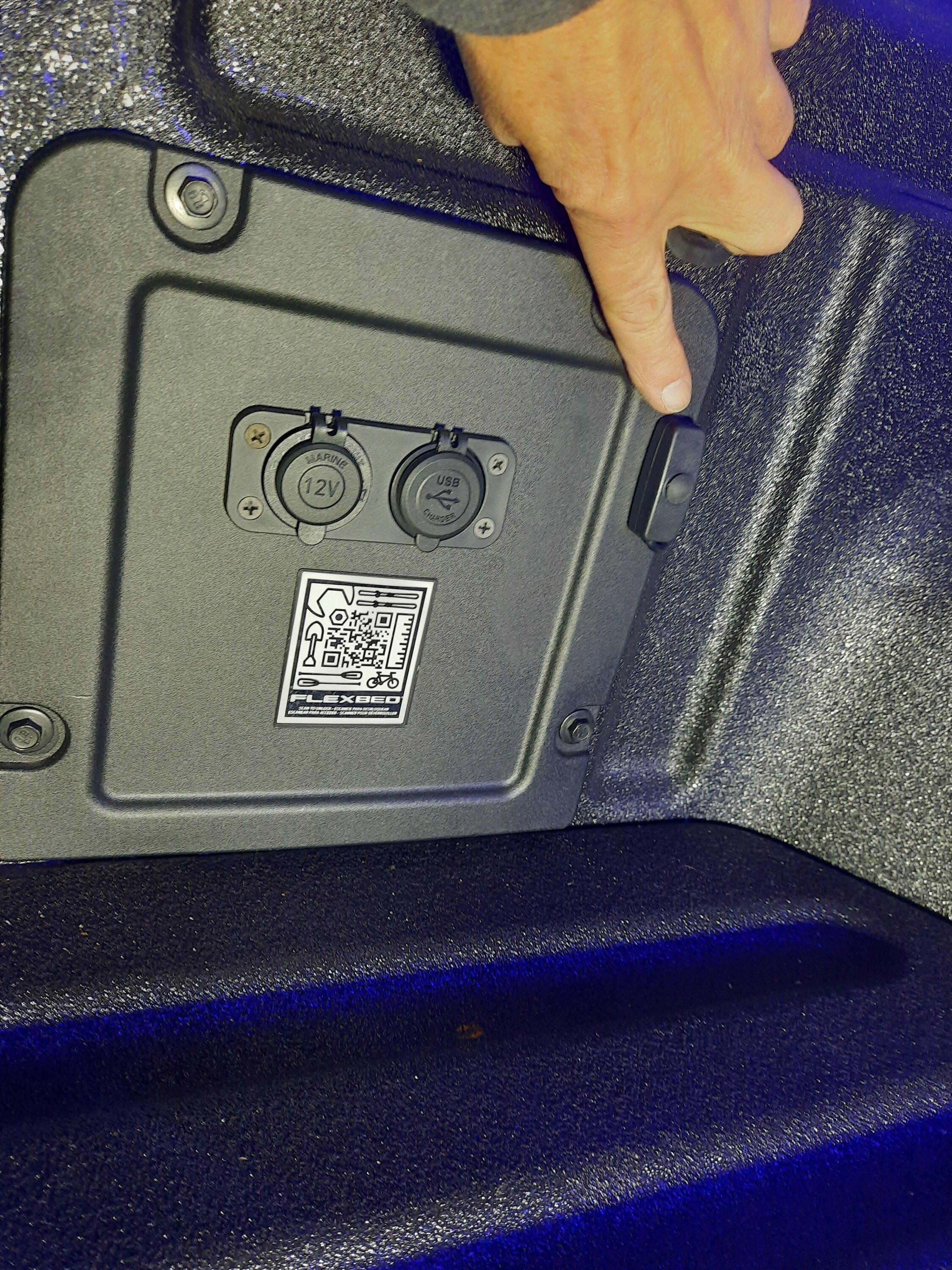

Led's and 12v, USB. Pointing to light switch
Are you using the provided 12v wiring? If so then your lights only come on with the ignition on (or for a brief epriod after turning off the ignition) right?

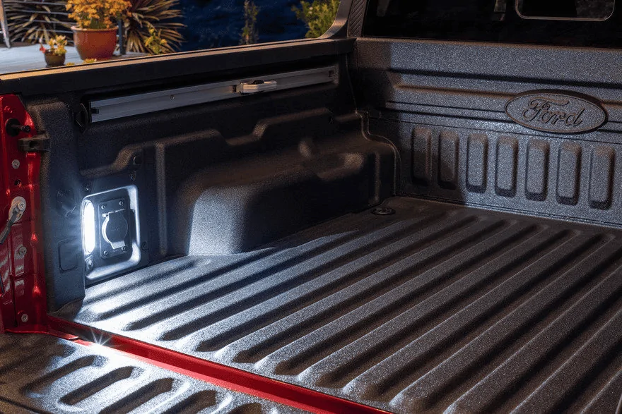

The lux packages come with a light on the left cubby panel that from what my brother-in-law tells me it's always hot.
So the wiring is likely already there in some form.

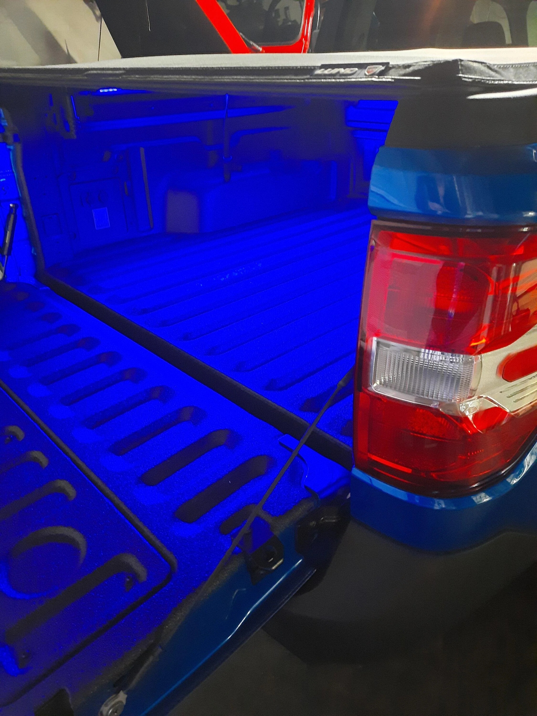

I just put my Maverick in ACC mode and the bed light stays on as long as I need.

Through other threads, I have come to determine that the XLT and Lariats with the lux package have a bed light on the left side of the truck. There is a switch next to the light that turns on both the overhead cargo light and the bed light.
In addition, when the truck is unlocked, both of these lights turn on for a short period of time. If you have that on the truck, the solution is simple. Tap into the light for your added bed lights
Yeah unfortunately my main use case is tossing stuff in the bed when I'm coming back to my truck. So opening the door, putting in the key, and then walking back to the bed is not ideal.
