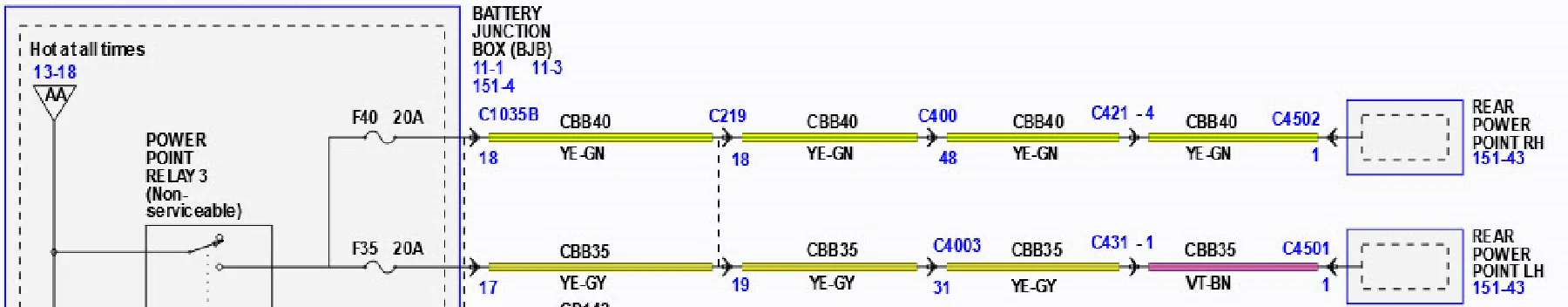

Well, guess I’ve got another fuse to eyeball. Everything googled indicated only one shared fuse, albeit I admit I didn’t pay attention to what years those posts referred to. I’ll take a look and see what I find, thanks!

Ford split it into 2 circuits in 25

Was indeed the second fuse. Will be saving that link above. Thank yall!

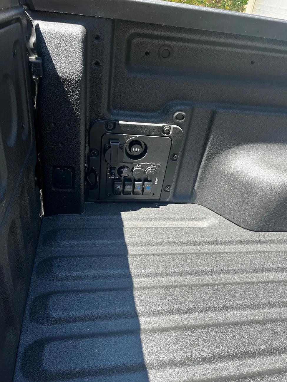

Figured I’d attach an image of what I ended up able to install after the fix. Four switch panel, first switch set up with inverter to power 110v outlet, USB-A/C port, 12v port and three remaining 12v switches for any future use found
Ford Maverick Flex Bed 12v power on passenger side not driver side [SOLVED] IMG_1384
