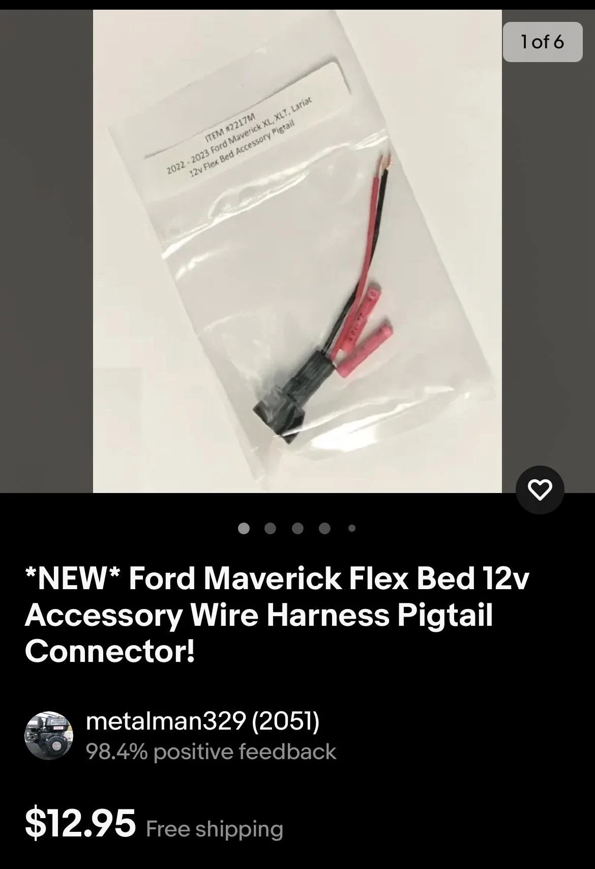

I ran into the same problem and finally found one on eBay that worked great. This is the link.
Wow! That was prompt! Thank you. I thought I was alone in having a hard time finding this item. Now at least we have given other members some alternative solutions.

You’re very welcome! By the way, in case you completely butcher the plate (like I nearly did), here’s that part number to keep handy:
Blanking Plug #13D712 ($13.23)
The other pigtails from Amazon did not work for the bed 12v. They fit the connector, but for some reason, did not power up the usb or cig lighter modules. No idea why. I ended up using the one Ford packaged with the truck. Thank you for your link to an extra pigtail. What was Ford thinking? "Yeah, let's keep the cost down by giving the consumer only one pigtail." They saved $10?

I spent way too much time looking for the second pigtail that Ford never gave me hahaha. Thankfully someone on here had posted an eBay link so I was able to go there.
Yes, that's where I got the second one. Oddly enough, when I inquired to my local Ford dealer about the pigtail, they had no idea what I was talking about.

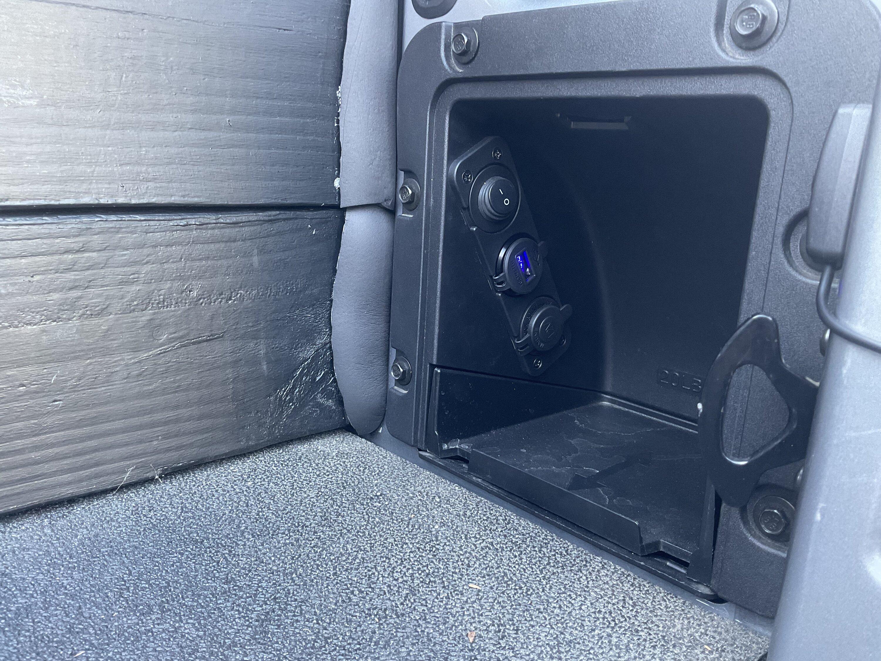

I went a different direction and put this in the cubby so nothing in the bed could damage them. The plate was installed so I could see the plugs from the tailgate, much easier this way to plug into, especially USB ports. I replaced the glass fuse with an inline blade fuse. I made sure that the fuse had enough wire added so I could access the fuse from the DIY power cover.

Just thinking about having my power port I installed in the bed cubby stay live. It has its own power switch that controls the both the 12 volt and USB ports. I also installed an dedicated inline 10 amp blade fuse. There are times you just don’t want to keep putting the key in.
