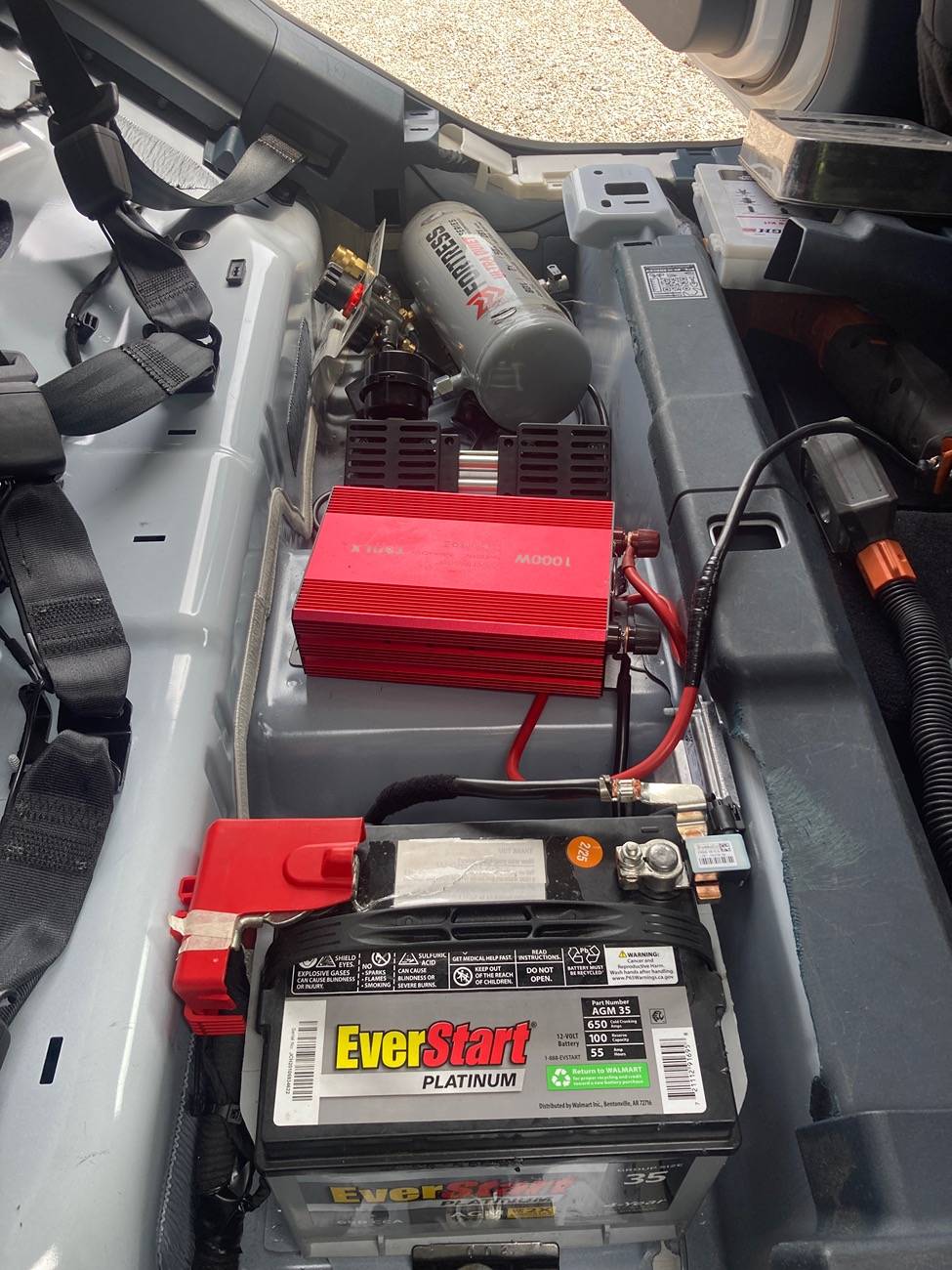

last week I traded my ‘23 XL hybrid for a ‘25 , this inverter mounted to back of cab , right now im putting it & a small 110v air comp. in well rear left side , 650 cca AGM battery

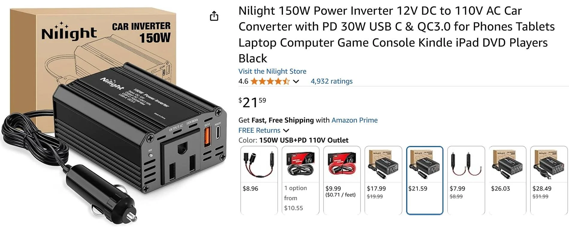

I'm thinking about getting a couple of those 12v lighter plugs for the bed of my truck from maverickinnovation on etsy, but I haven't found any clear guidance on the maximum wattage for a plug-in inverter to use with them. I'm seeing some say that 150w (maybe 250w??) is probably the maximum like this one -
Ford Maverick 110v plug for bed. invert
anybody have any experience/recommendations for inverters to use with the lighter plug?
