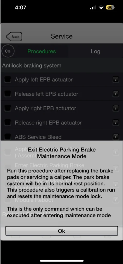

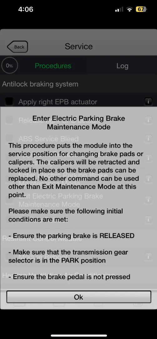

I tried the workshop method to deactivate the EPB and put it in service mode, no joy on our 2023 XLT hybrid. I ordered the OBD 11 adapter and will use our old windows10 laptop and try it with FORScan. Hopefully that will work
Better to use Forscan even if it will go into service mode normally. Mine went in with the standard method, but wouldn't come out. Could have been a PITA without having Forscan.

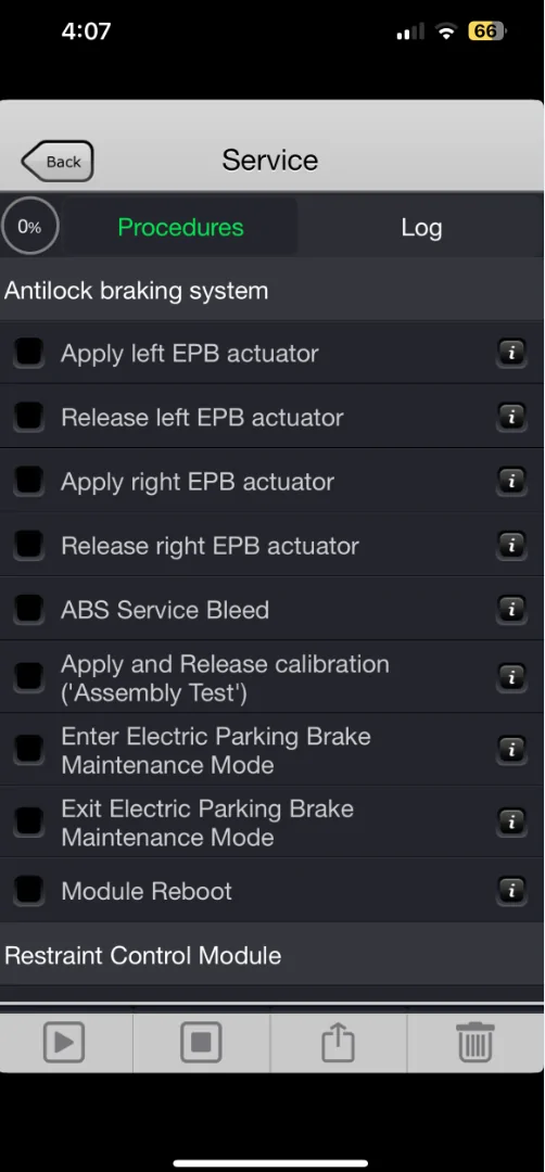

When I was doing the 10k service checks, I went thru the Forscan Lite service method just to see, since I have a '24 hybrid.
But no need for pads yet, though a tad lower than I'd think at 10k.
Rest of the pins/calipers/sliders except for EPB are the same basically as mom's Focus, tad beefier.
Since XLT-Doug has a, XLT - then the SSM may apply. May have been fixed on later MY's, or Forscan improved, or some recall update in software had an improvement added.
SSM 51217 2022 Maverick – Brake Service Mode Inoperative
Some 2022 Maverick vehicles may exhibit the brake service mode is inoperative when using the Workshop Manual (WSM) procedure. To avoid this condition, do not use the brake service mode procedure described in the WSM. Instead, use Ford Diagnosis and Repair System (FDRS) scan tool to activate the Brake Service Mode. Run the ABS-Electronic Parking Brake (EPB) Service Tools app and select enter park brake maintenance mode.
