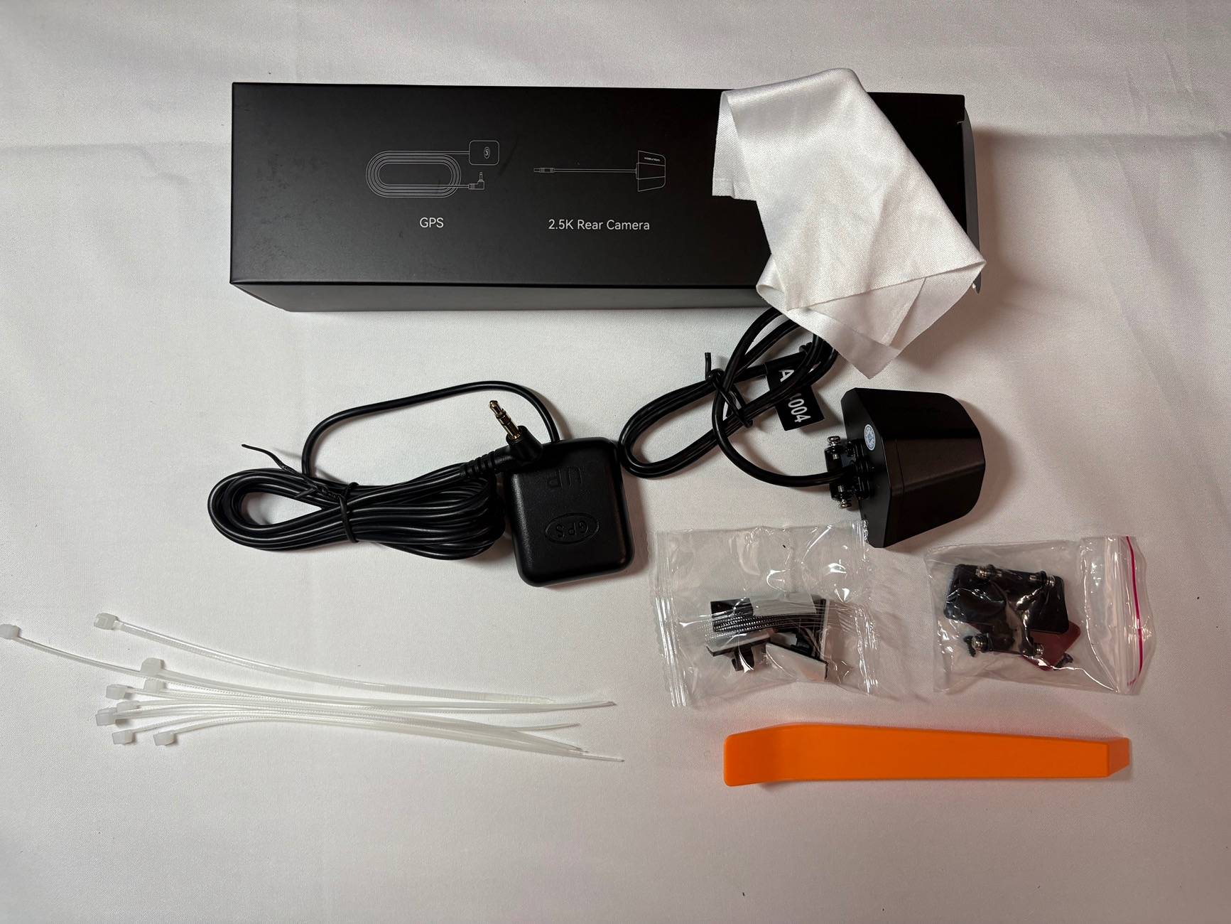

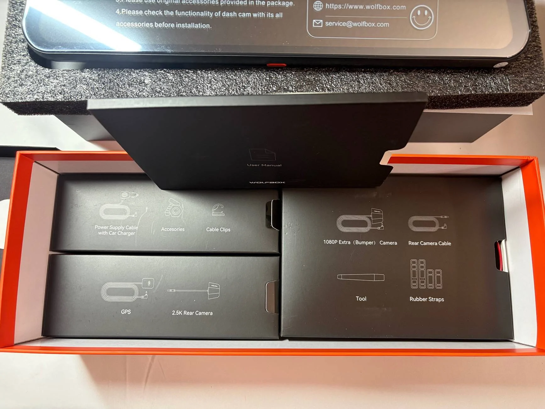

UNBOXING
I got both the G900 TriPro and a hardwire kit.
Ford Maverick WolfBox G900 TriPro Electronic Rear View Mirror IMG_0129

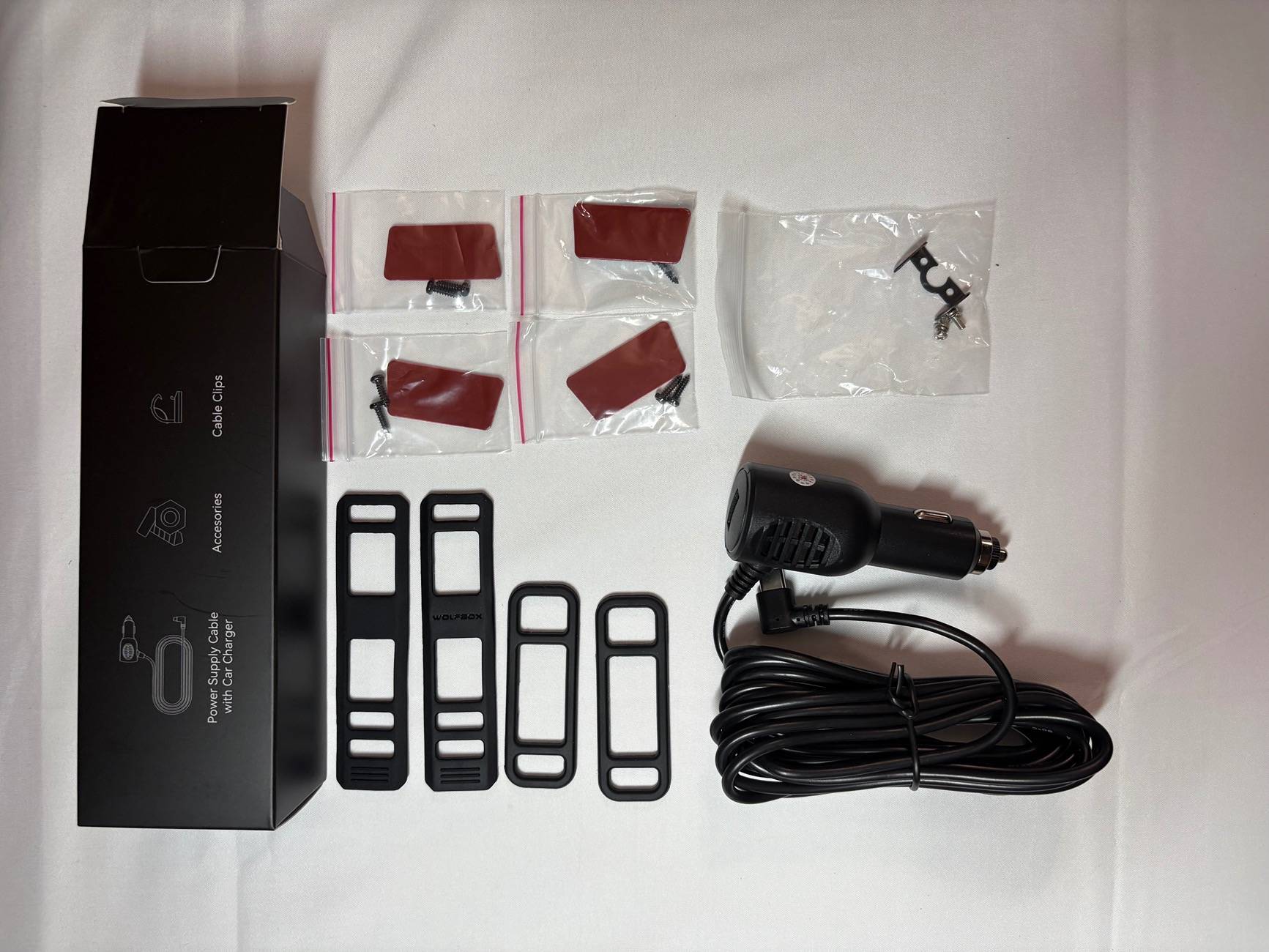

The G900 TriPro does come with everything you need to get started but you will have to power with the included 12V CLA.

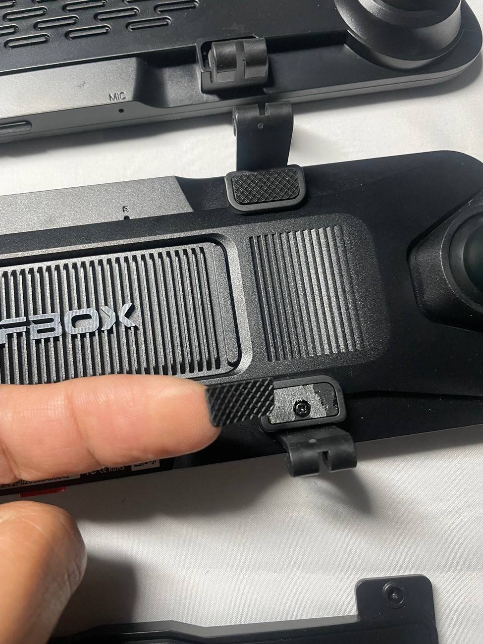

Normally the mirror just straps onto your existing rear view mirror via included elastic bands. I drive on some pretty rough roads and wanted a more robust mount. Fortunately WolfBox does sell a hardware mount which I did use on my G840S. First order of business was to transfer the hardware mount onto my G900 TriPro. On unboxing, I initially thought the G900 TriiPro was bigger than my G840S. After getting them side-by-side, I confirmed they are the same size.

Most people would take of the hooks and straps. I'm generally function over form (and am not concerned with looks) and like that there is storage behind my mirror. Will I ever use it? Probably not. I never did with G840S. But I like to know that I could if needed.

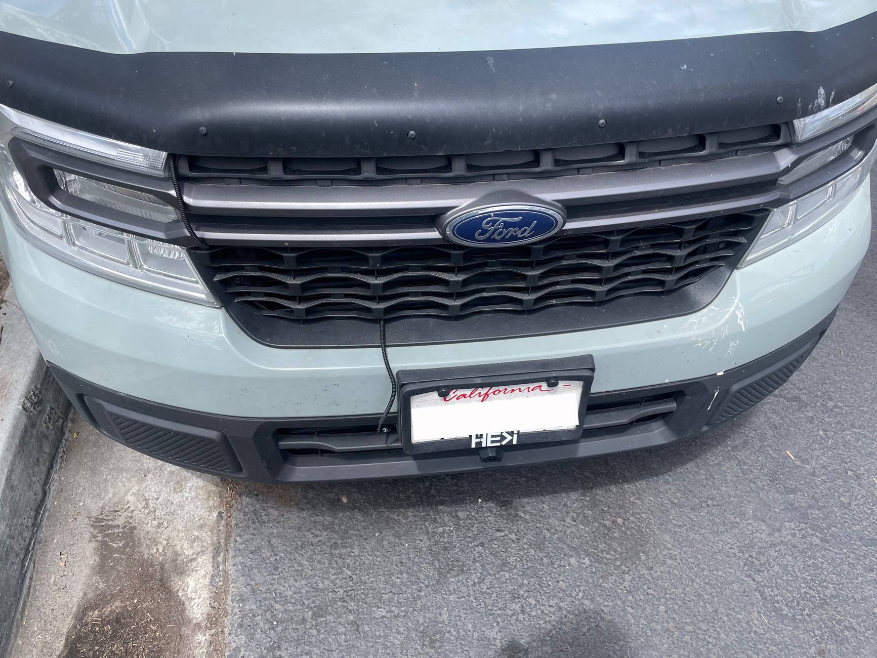

I then mounted the mirror in the rig and started wiring. First the front camera. I didn't take any pictures of the install but I mounted the camera under my front plate.

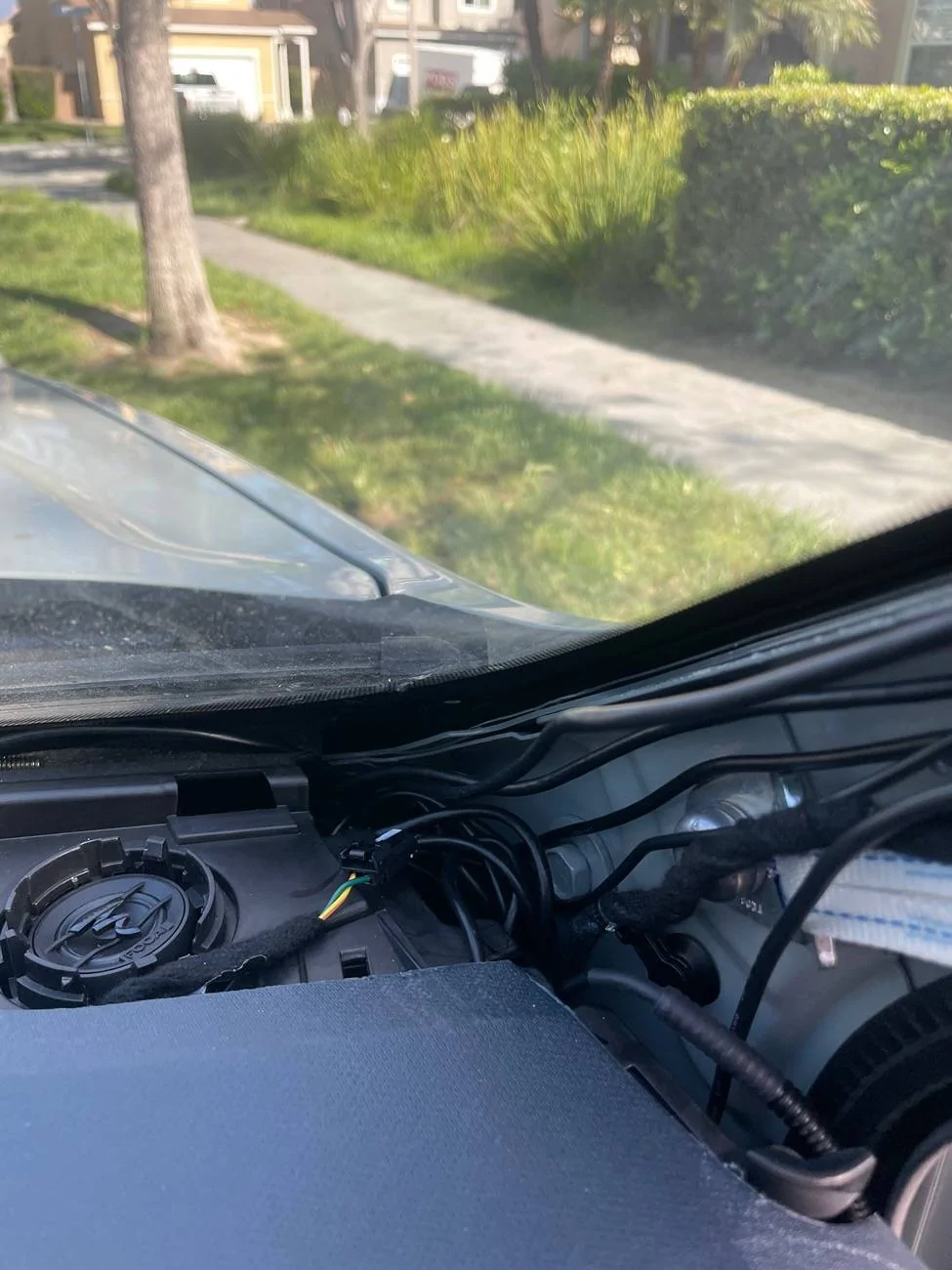

I routed the wires through the engine bay being careful to keep the cable away from any hot components. It runs from the engine bay through the passenger side fender then up the A pillar.

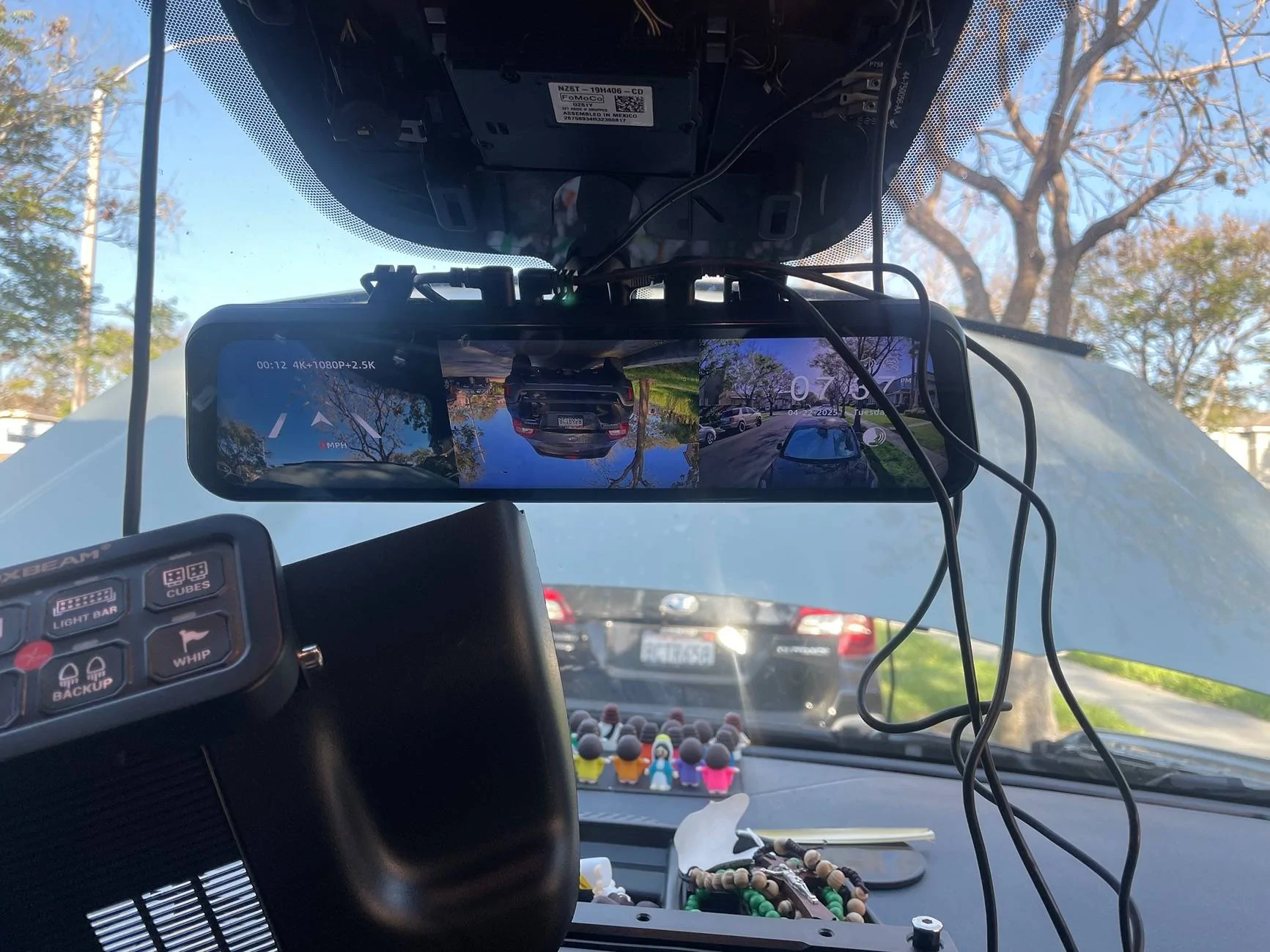

I was now at a point where I could test the display and cameras (with rough wiring).
Ford Maverick WolfBox G900 TriPro Electronic Rear View Mirror IMG_0052
There are four wires at the top of the camera. From left to right, power, front camera, GPS, rear camera. All looked in order so I started to button things up. The wires go down the stalk of the mirror mount then up through the center-roof console into the headliner. I have a black cord wrap that wraps around the mirror mount stalk and wires so you don't see them. The wires then go back over to the top of the A pillar and down the A pillar. If you follow this same install be mindful and careful with the airbags in the A pillar. Tread lightly, and run your wires behind the airbags. At the bottom of the A pillar in the passenger corner of the firewall there is a nice spot to stash excess wire.

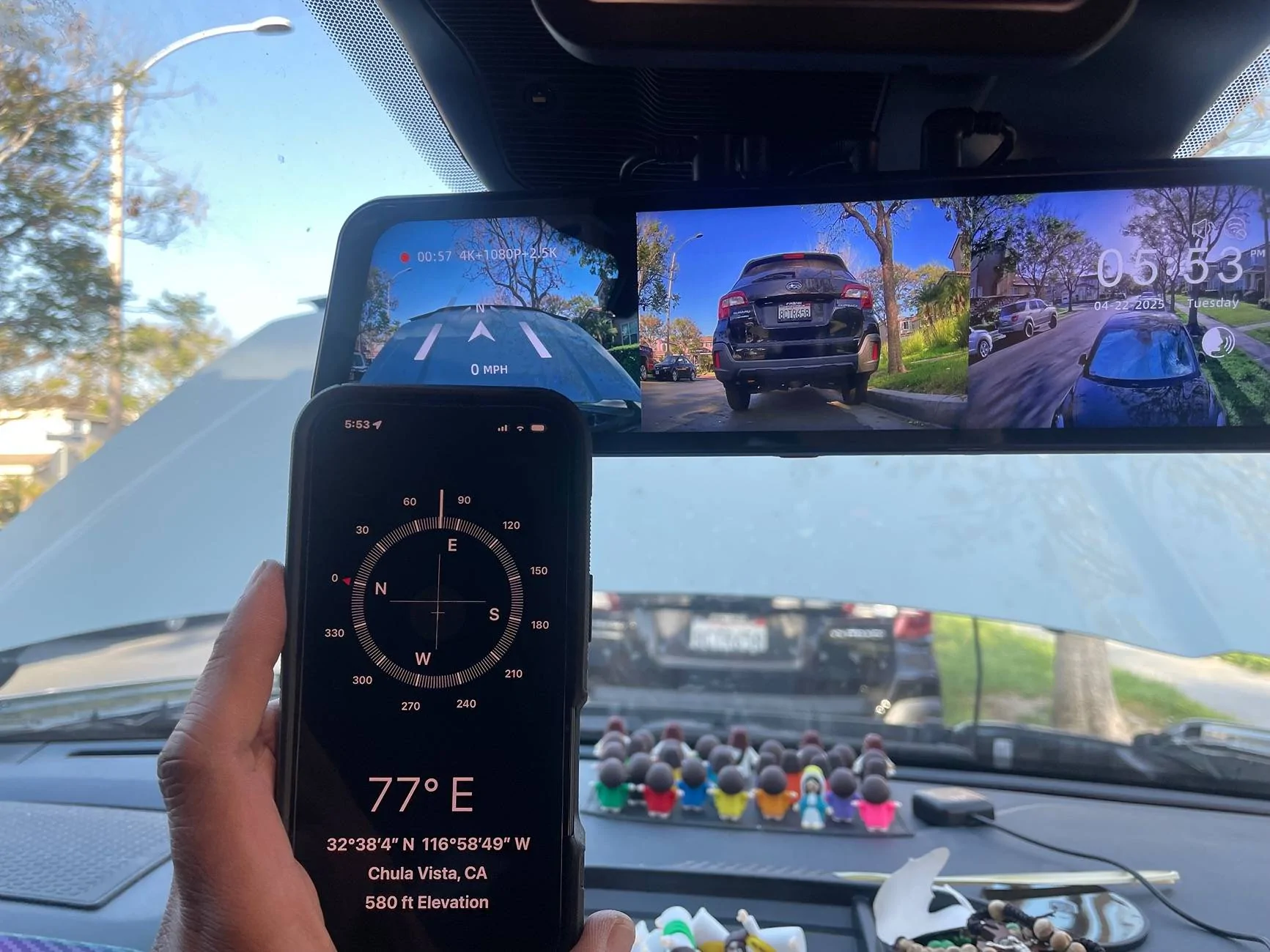

Then I placed the A pillar panel back in place and install was done. To my dismay, the G900 TriPro still has the same incorrect GPS heading as my G840S. I am still working with WolfBox to get this resolved (hopefully).
Ford Maverick WolfBox G900 TriPro Electronic Rear View Mirror IMG_0056
Ford Maverick WolfBox G900 TriPro Electronic Rear View Mirror IMG_0181
G900 TriPro in top pic. G840S in bottom. Not sure if it comes through in pictures but G900 TriPro is brighter.

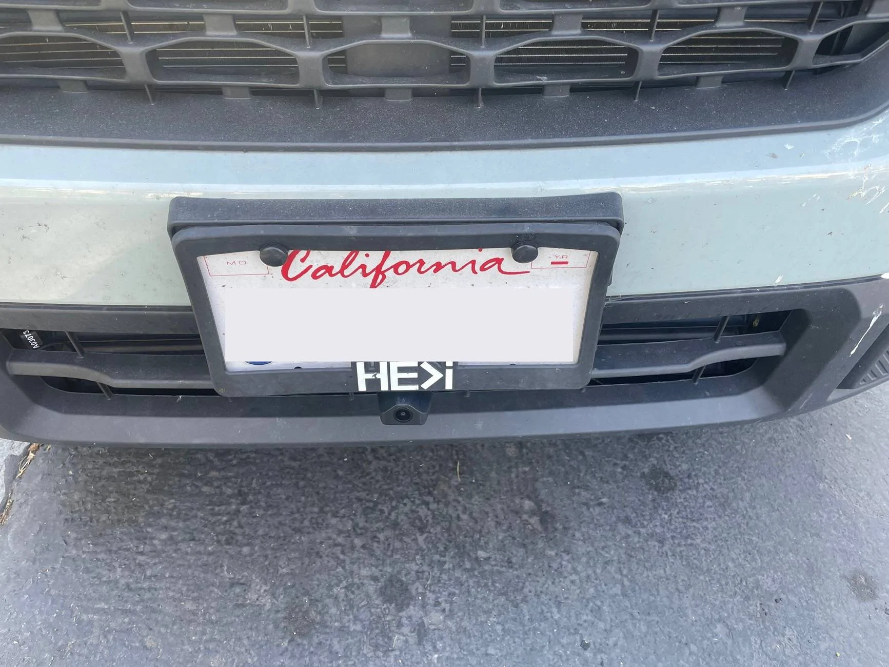

It would be good to show how you routed the front camera - assuming through the firewall somewhere and over the radiator.
For now, I just have it ran outside the bumper. I have it on the project list to pull my bumper to perform the ACC conversion and to install my foglights. At that time I’ll permanently route this cable behind the bumper.

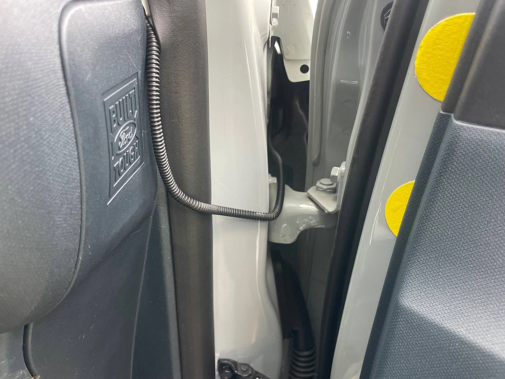

It is routed through the channels in the passenger side fender, through the door, and up the A pillar.

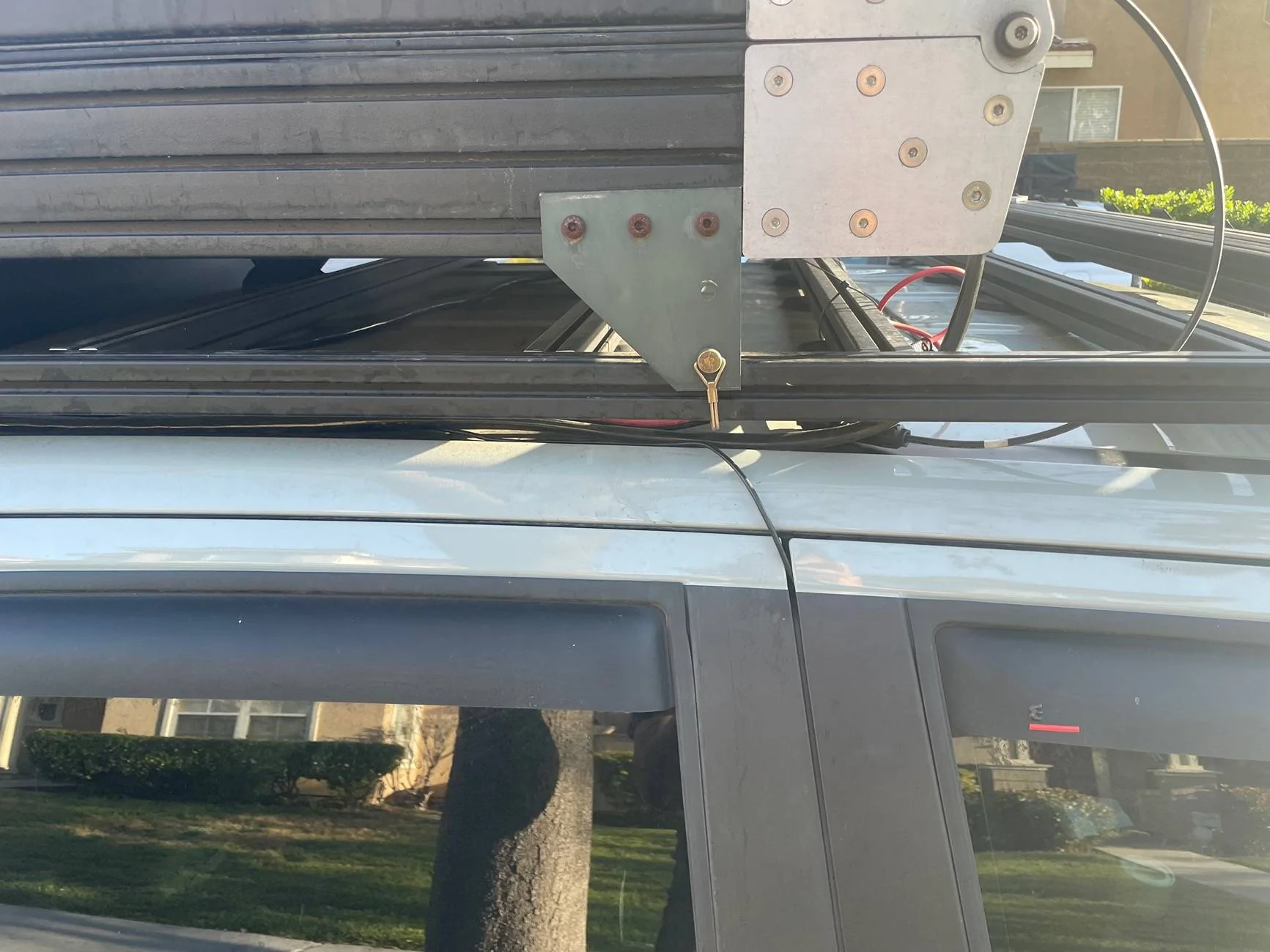

The rear camera is routed through the dome light assembly?
No. It’s routed down the side of my camper right into the front passenger door then into the headliner.
Ford Maverick WolfBox G900 TriPro Electronic Rear View Mirror IMG_0121
Lots of work to do on the camper including swapping out the rusting hardware, cleaning up (solar, cell booster, Starlink, lighting) wiring.
