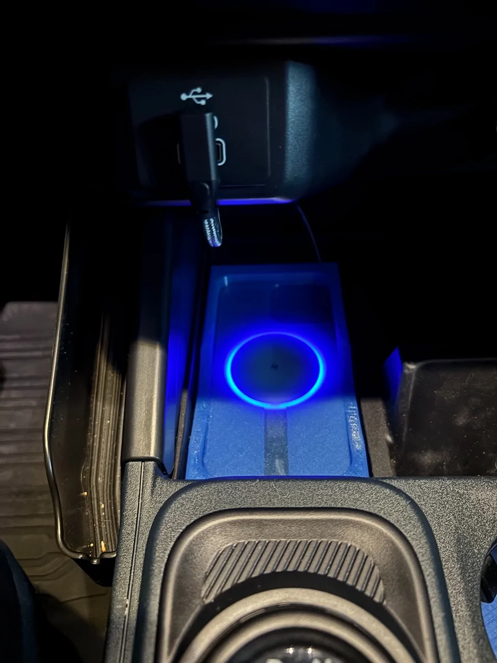

A lot of phone cases lift the electronics of the phone up high enough off the pad to make wireless charging problematic. You'll also want to center your phone on the charge pad front-to-back and side-to-side.
For my iPhone 16 I pushed it all the way forward, measured the resulting gap at the base of the phone, then 3-d printed a little bumper that was 1/2 the gap width and put it on the charge pad in the front.
Now when I plop my phone on the charge pad, I just push it all the way forward against the bump stop and it's centered. Works best there, though I do keep it in a case, so it can still be a little wonky. Out of the case charging it works fine.
You don't need a 3-d printer. A chunk of wood, plastic, cardboard or Styrofoam would work too.
