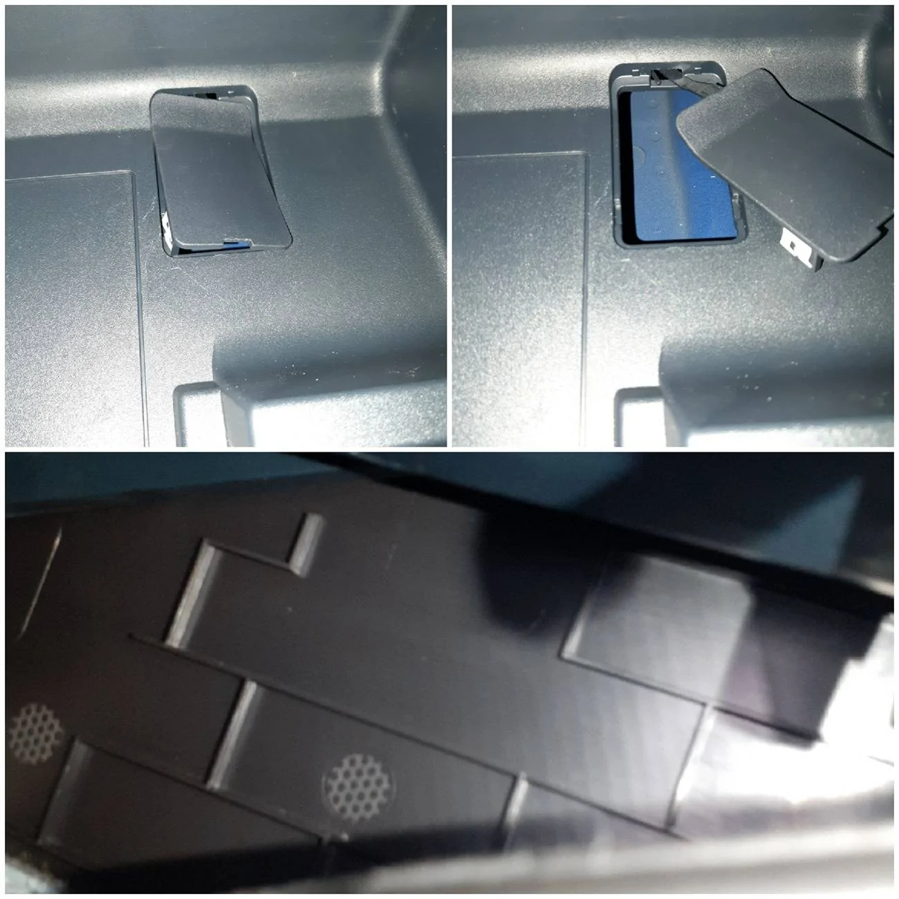

My 2023 Maverick hybrid in XLT trim with the Lux package does not have a wireless charger.
I removed the orange insert then I popped open access panel, put my phone into and under the console. I took a picture of the bottom area of the console that would have a charger attached and there is none.
Here are the pictures. It is not hard to verify for yourself. Remove the orange insert, loosen access panel. Reach your fingers in and feel for the charger or lack thereof. Easy Peasy.
I hope this helps.
