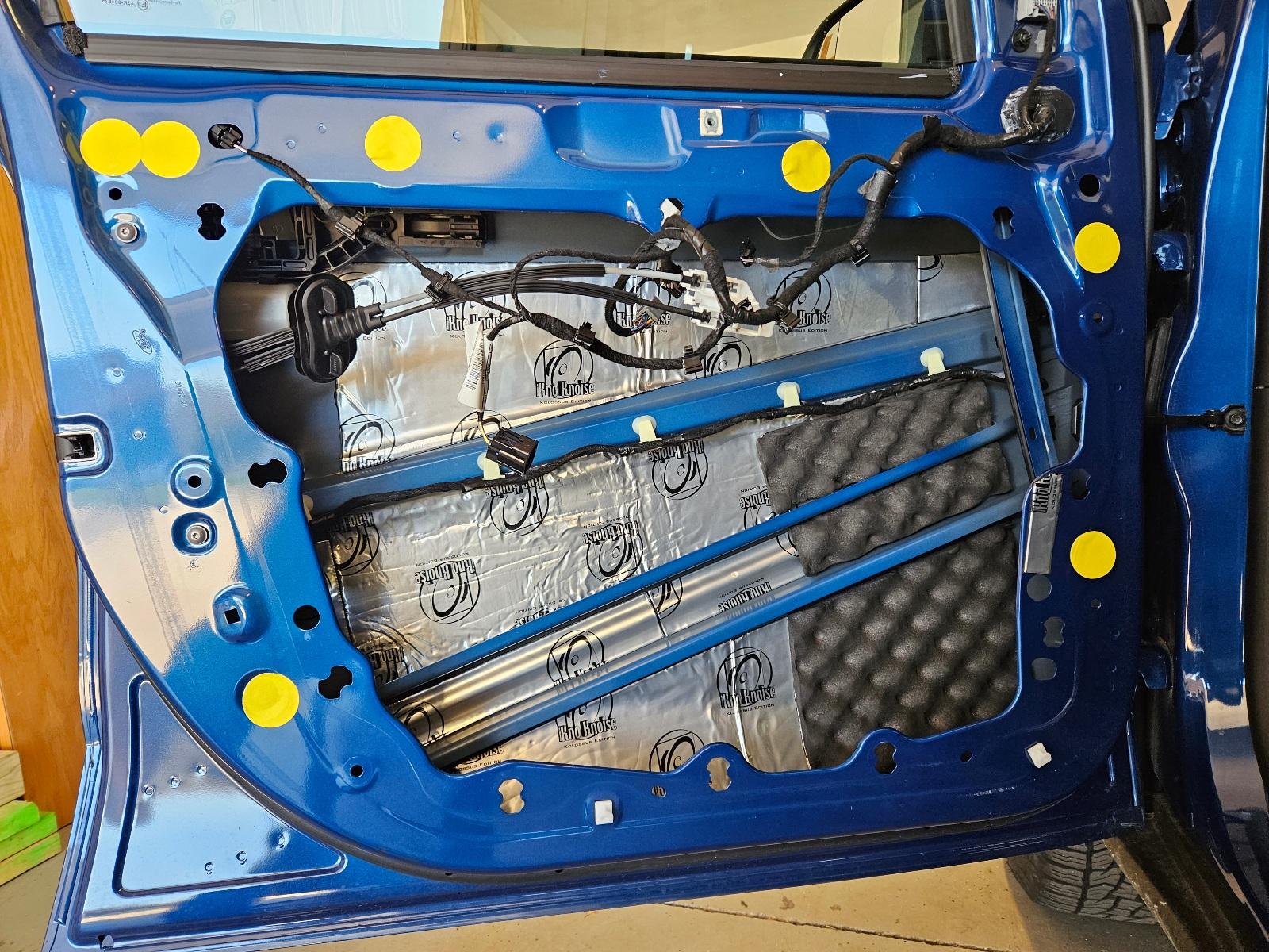

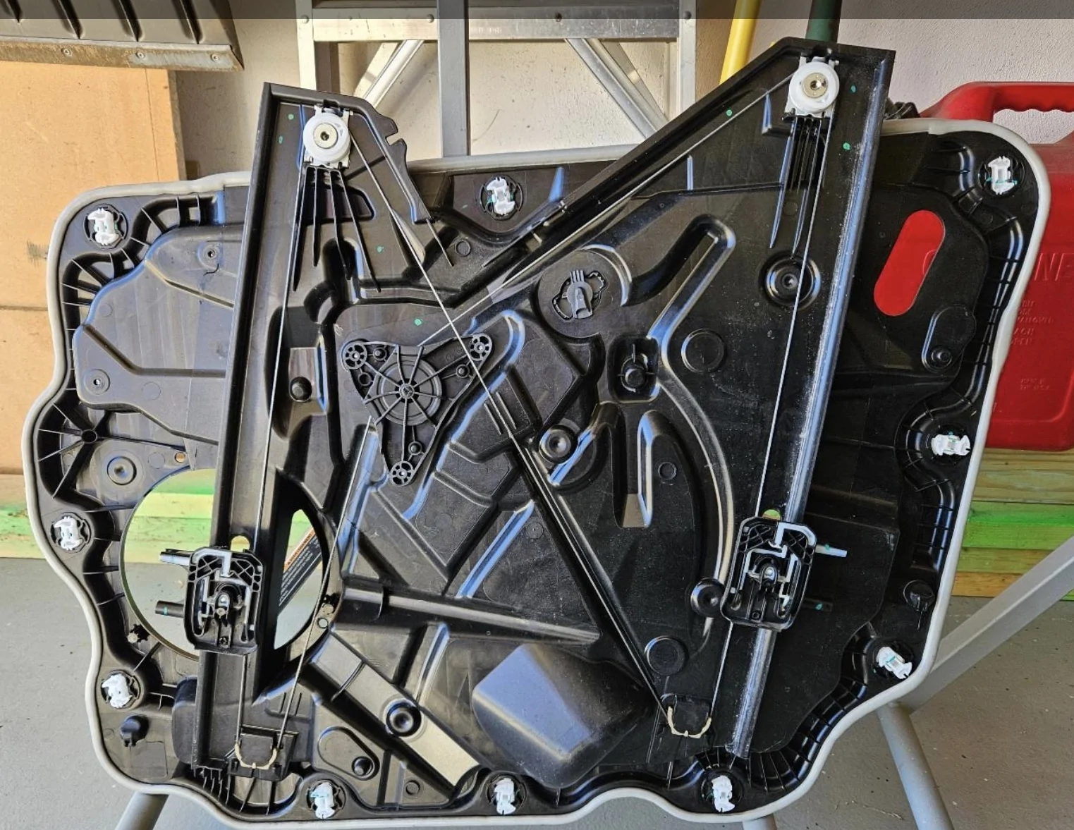

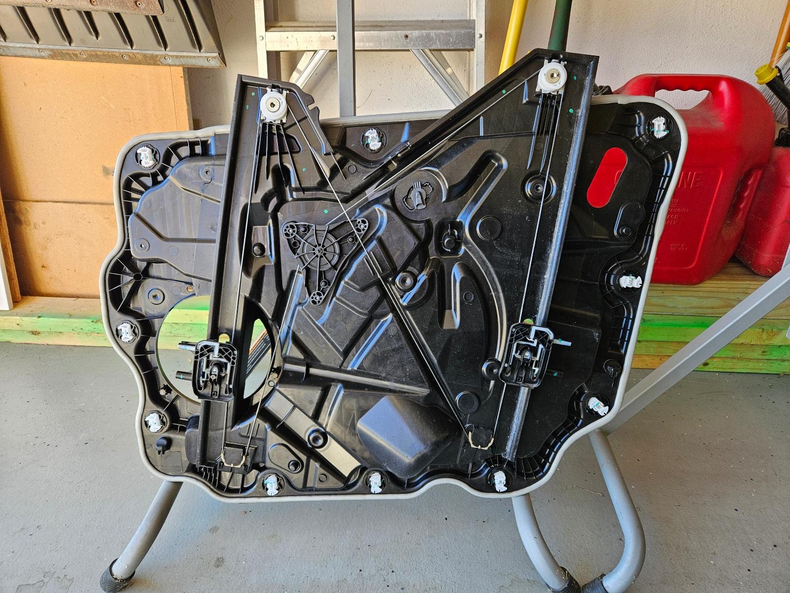

I can take pics of the driver's side door when I do that side. I've already closed up the passenger side. I plan on tackling that side on the weekend. On the passenger side I used Kno Knoise Kolossus CLD on the large exposed portions of door skin and then put some thick closed cell foam deadener directly behind the driver.
These pics are great for my issue. When I was replacing the front door speakers the small clip on the connecter for the cables that operate the interior door lock and the interior door pull broke. Thank you eBay for selling just the cable with connector on it.
Do you have to go through the steps involving the glass have to be done to get the window regulator panel off? It seems easy enough following your steps, but thought I would ask.

Do the two pieces come out together?

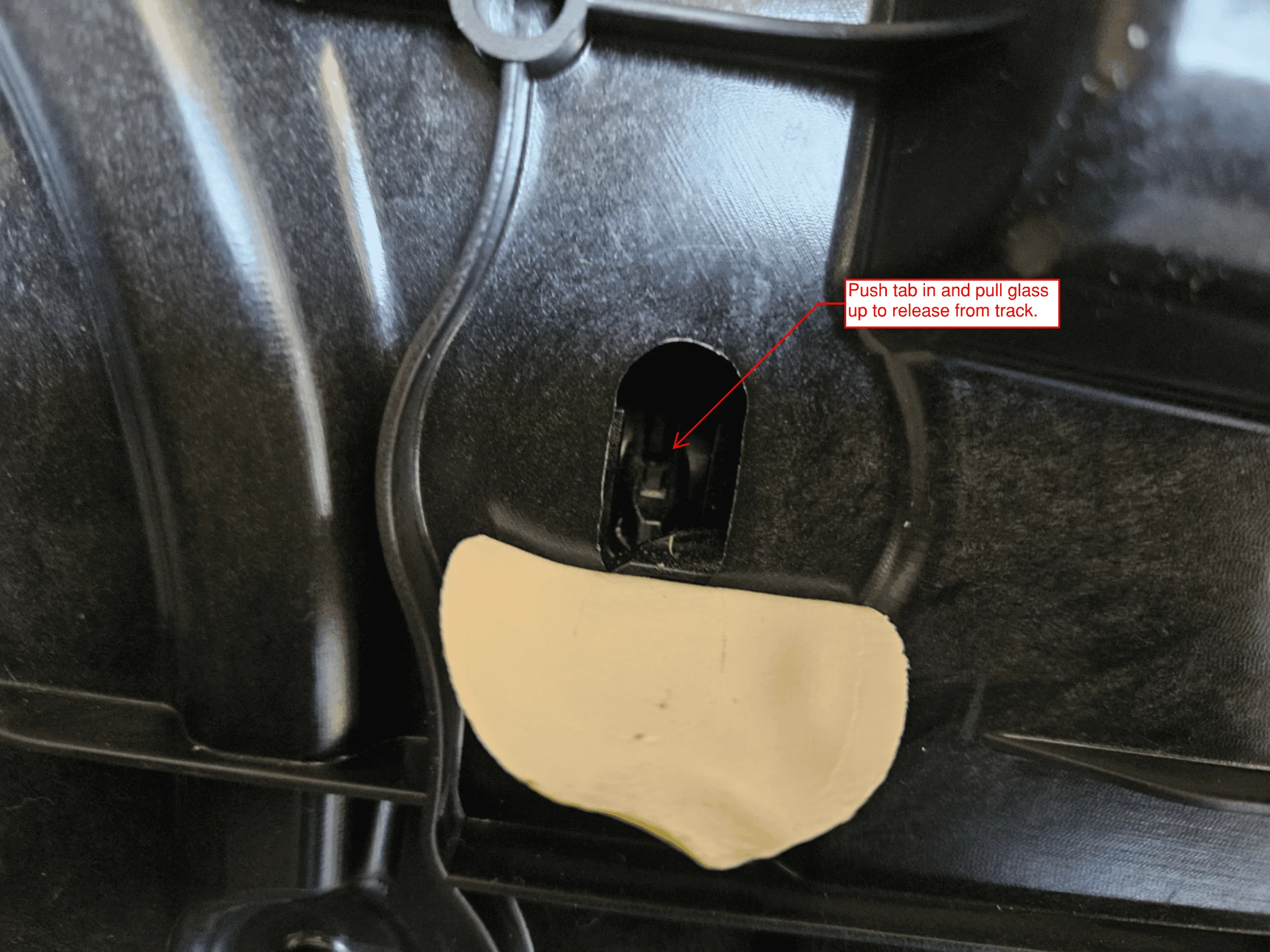

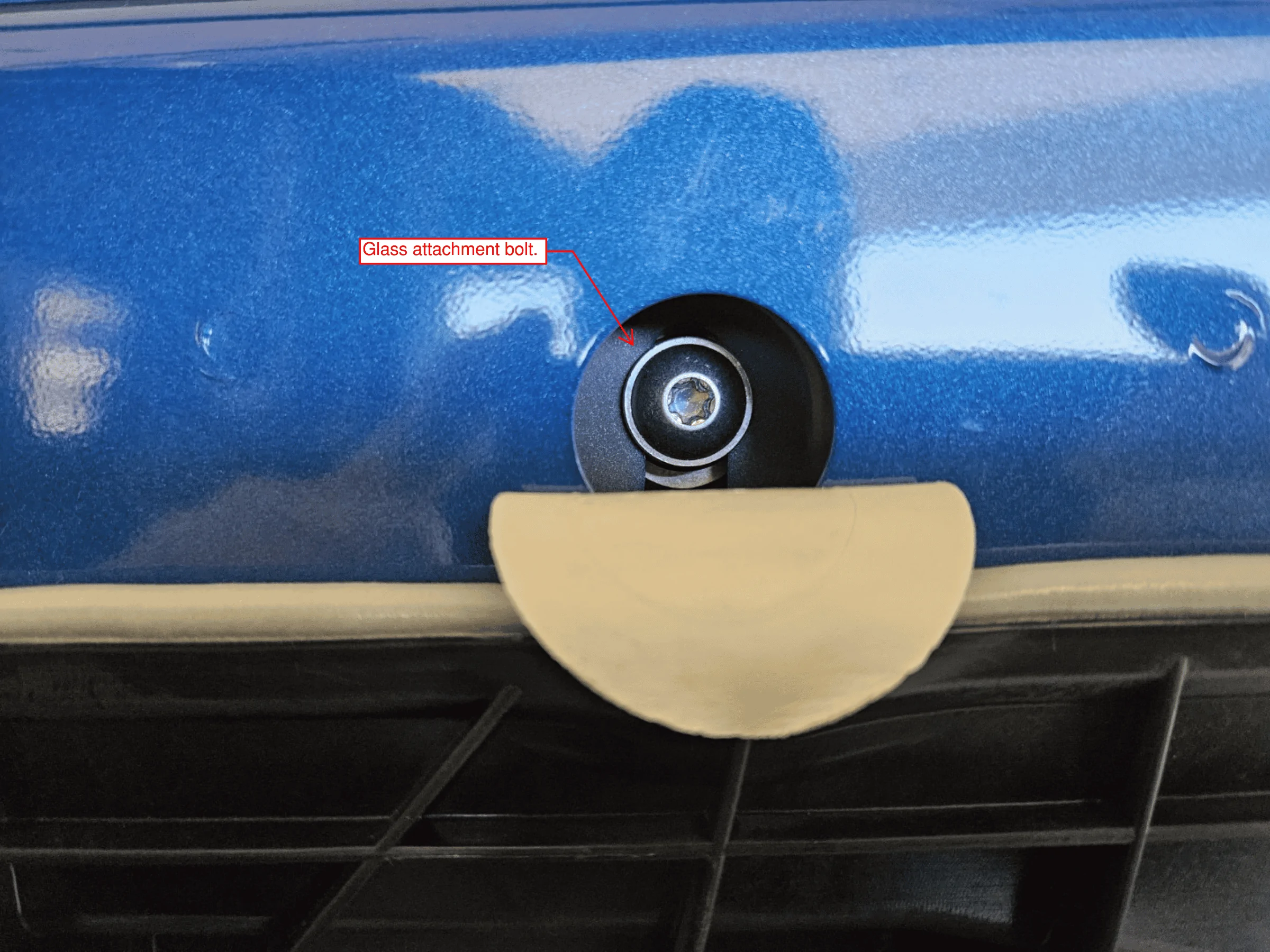

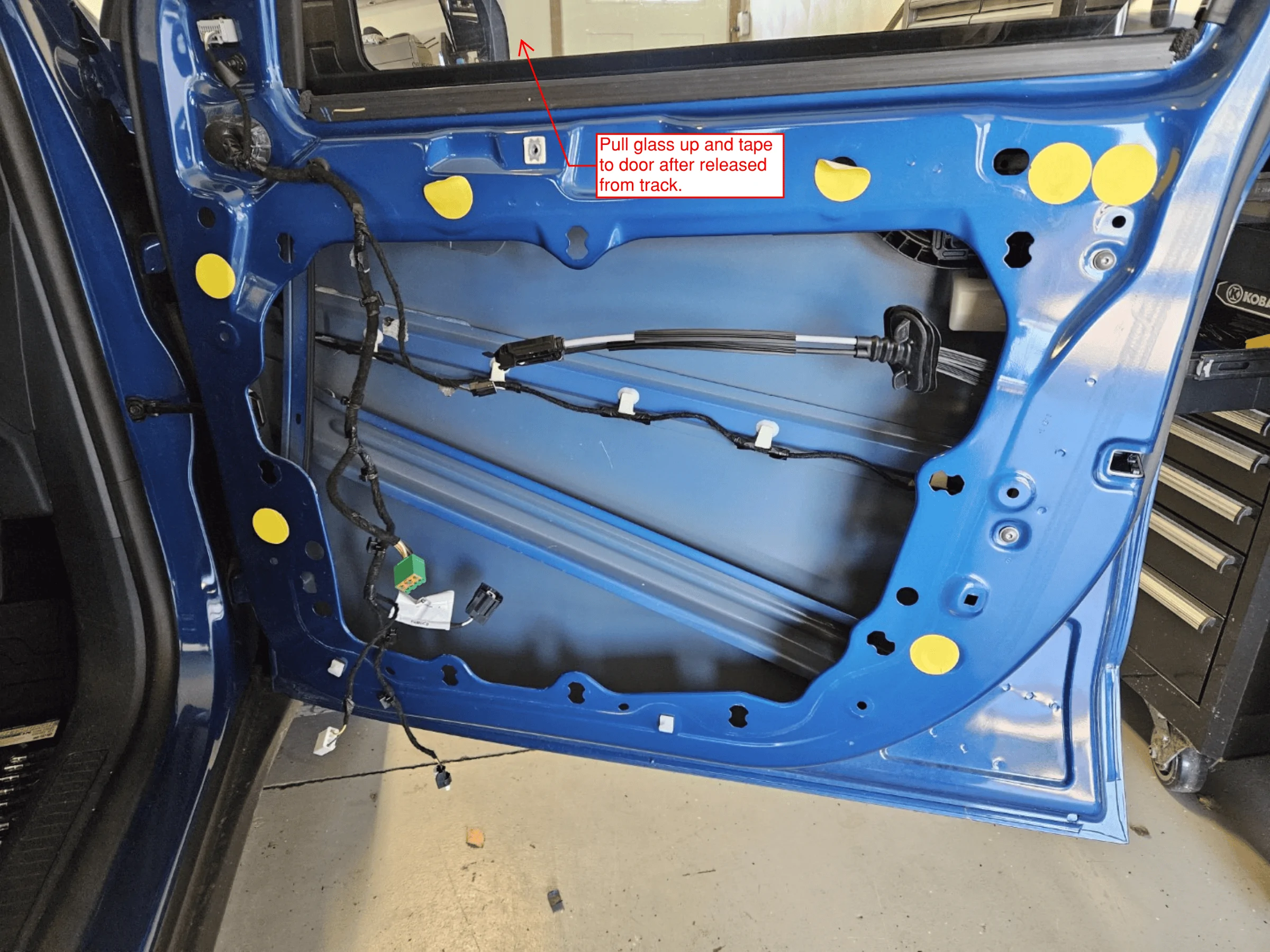

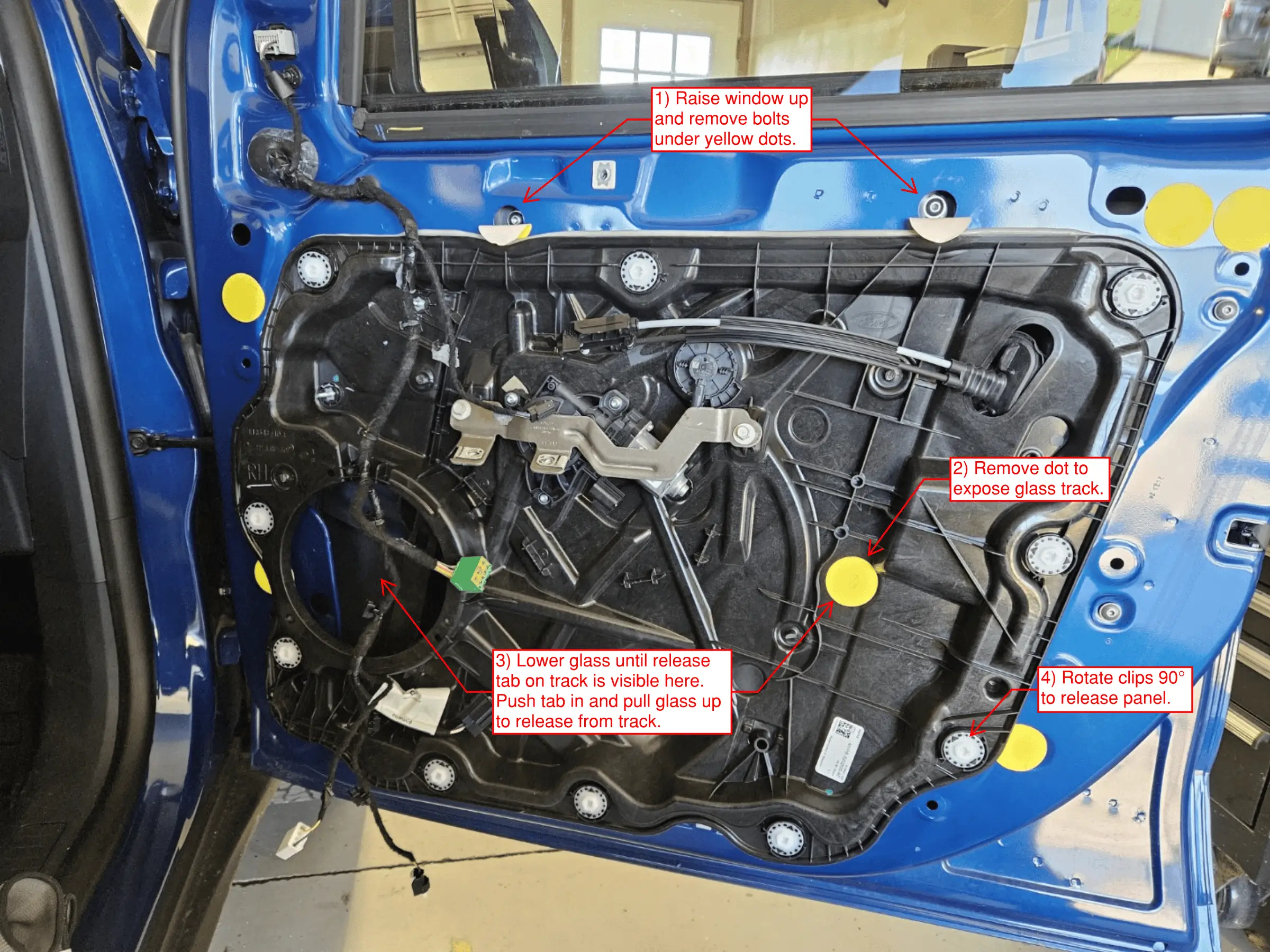

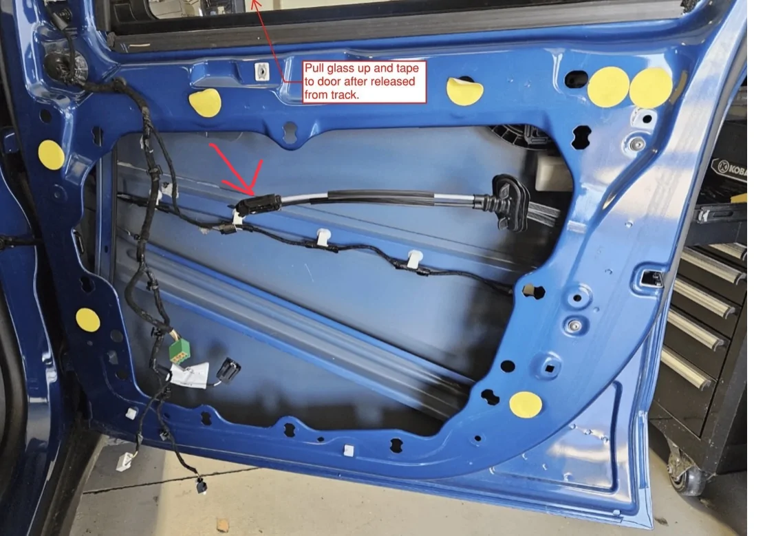

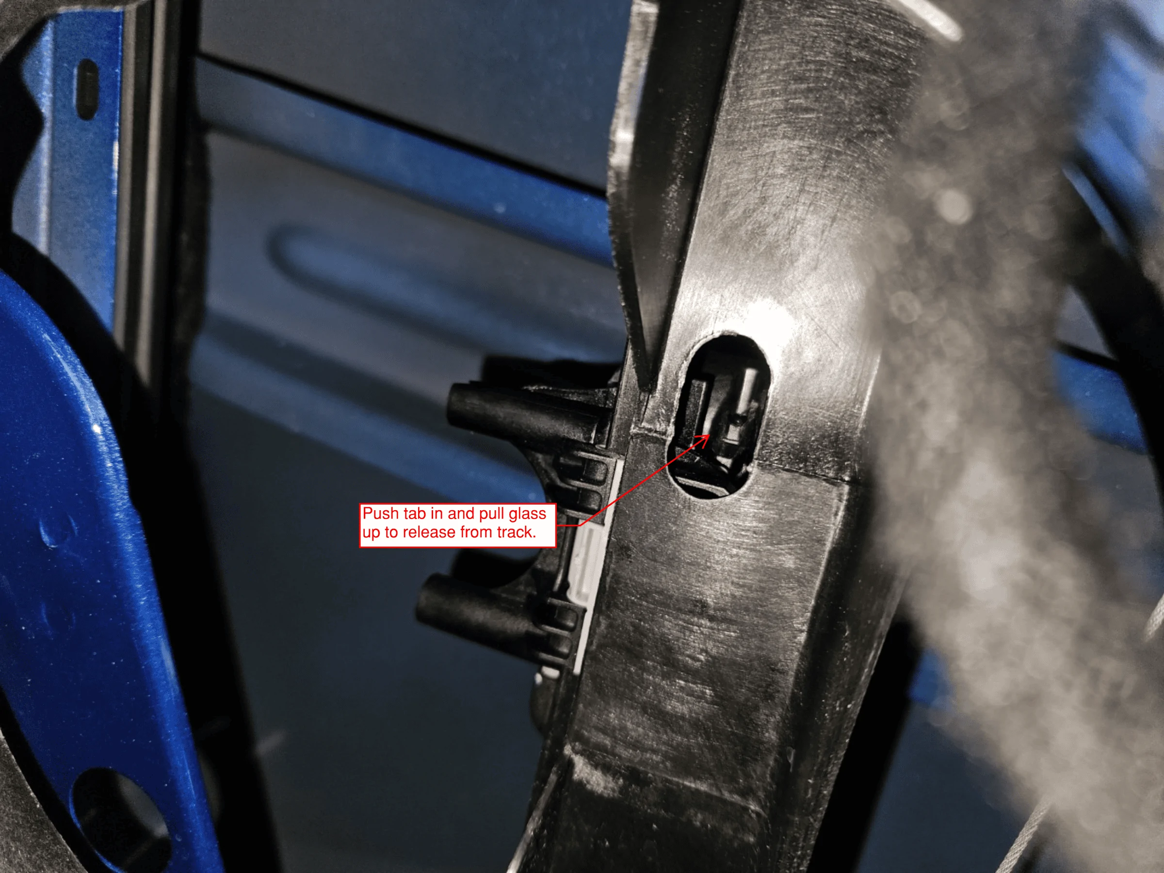

When I started my stereo install I knew I'd want to get some sound dampening inside the door. Unfortunately, I couldn't find a tutorial on how to get the window regulator panel off. After some research on similar vehicles I was able to sort it out. It is actually pretty simple once you know what to look for. Kudos to Ford for making it easy.

When you say you want to lower the glass until the tabs are visible, does that mean lower it with our hands or lower it using the buttons that normally control the windows?
Seems like the buttons are disconnected so it seems like we lower it with our hands. Would I want it taped up before I do that?
Never tackled something like this so unsure of what to expect.
Aaron F
Aaron
Jan 31, 2023
196
170
Sterling Heights, MI
2023 Maverick Lariat Lux w/ 4k and BAP / 2025 Maverick AWD Hybrid Lariat w/ 4k
This is great, I’m going to start on this tomorrow with my speaker upgrade.
Lower it with the buttons. They are still connected while the door skin is off. When you press the tabs to release the glass, then you can move it by hand and tape it to the door
