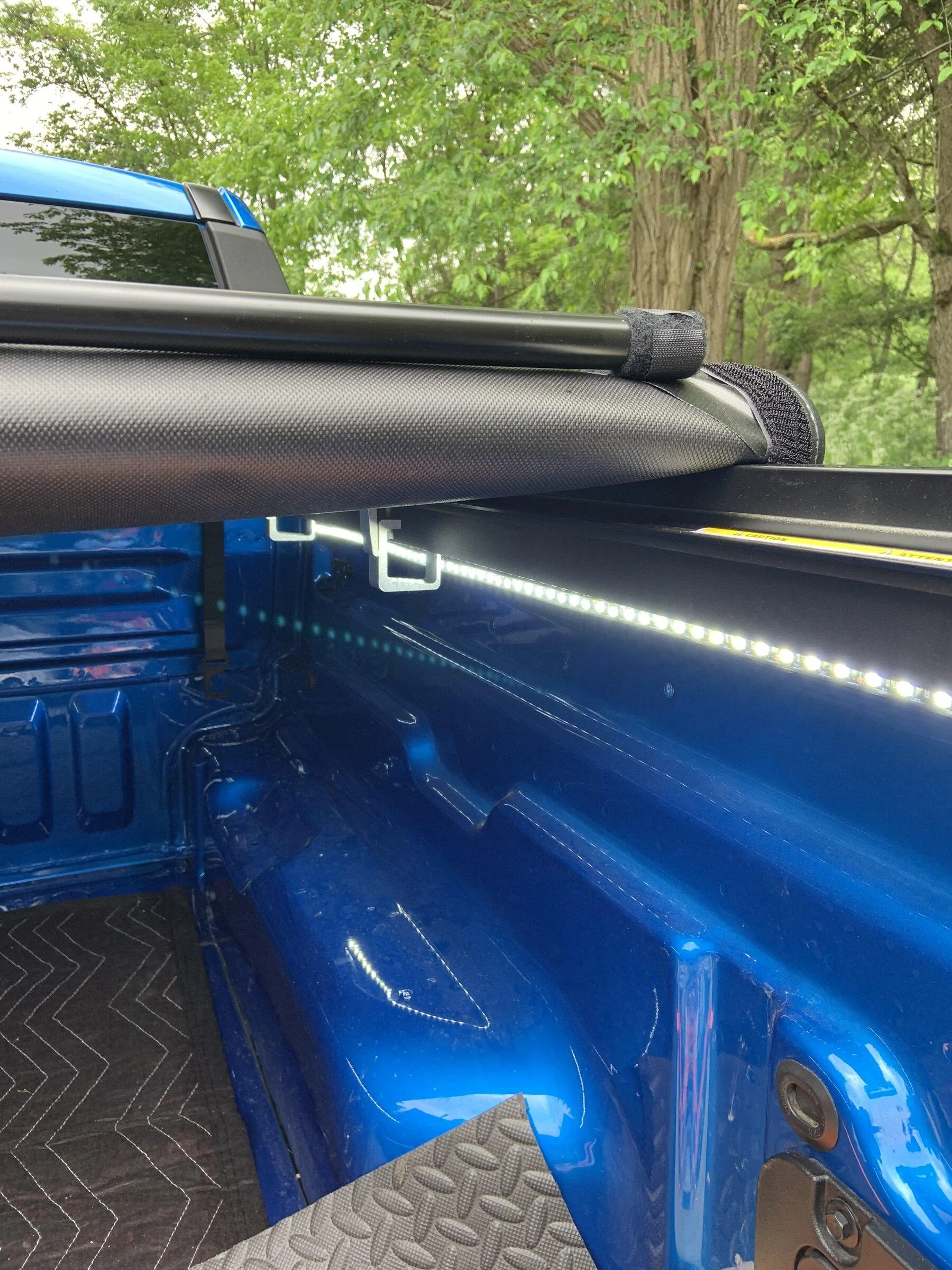

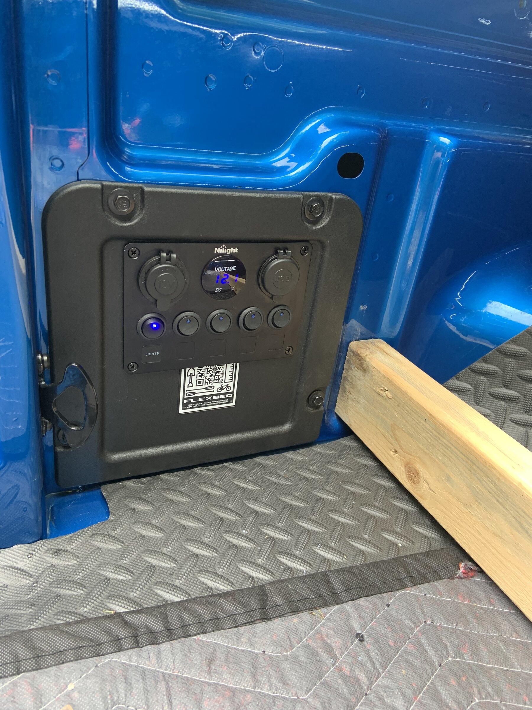

Finally got my lighting, 12 volt, USB, and switch panel installed. 3 hours start to finish.

I love it, except you made your QR code useless :ROFLMAO: :ROFLMAO: :ROFLMAO:
On a serious note I may be concerned with gear hitting switches and turning things on and draining the battery. You could install a thin rail across the front of the switches that would block that from happening without impeding usability. Some switches already have safety bars between them or toggle covers but since you are already installed just take a hollow aluminum tube put 2 90 degree bends in and tap the ends then screw it on from the backside of the panel. Should be sufficient. May not even need to tap it just use hex head self tapper screws that fit the hole in the tube .

Looks great. Any plans for the other four switches?

That’s a great idea, thanks!

Maybe an under bumper light for when I’m using the hitch. I have the volt meter and the usb plugs switched as they are always on until the truck sleeps.
This is not an issue since power is shut down to this circuit after 15 minutes or so.
Im not sure I like that for camping and working type stuff. Even a lil tailgating I would want some power for a bit. I keep a fridge freezer in whatever my main vehicle is, we run it when we are out doing laundry or shopping or at the beach. I may have to run a separate circuit back there for full time use.
