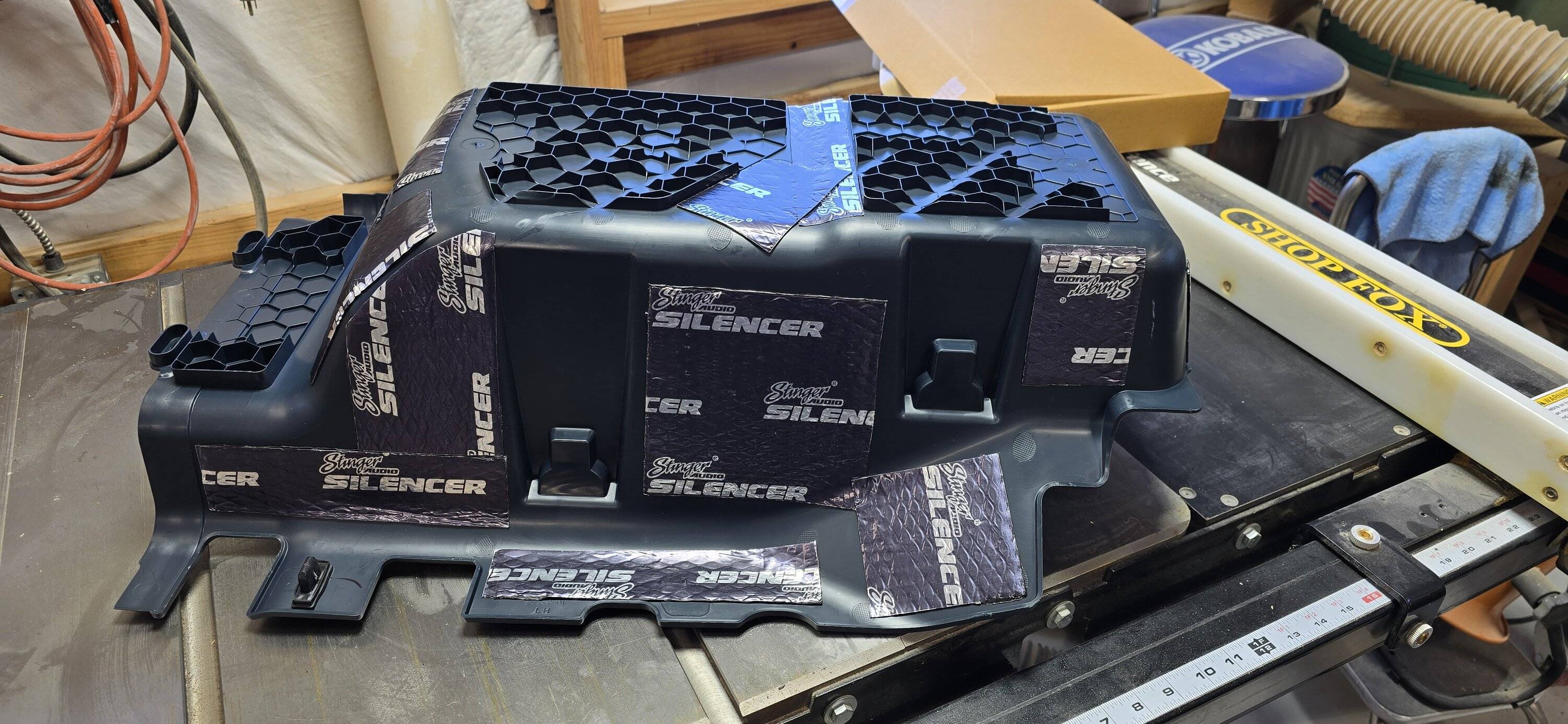

Doing the back cab wall made such a big difference for me, probably the most noticeable.
I did under the seat bins, the bins themselves, the back wall and an admittedly half-ass job on the front doors. I used butyl deadener and siless foam everywhere I could reasonably fit both.
In the spring I'll yank the windows and do all 4 doors properly even though I think it'll start to be a case of diminishing returns.
The back of the cab is on the list, I'm really dreading it.

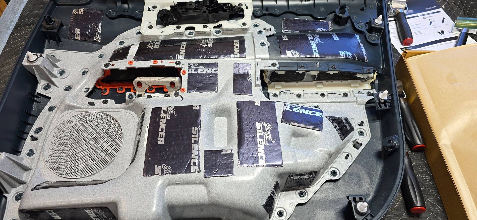

Todd, you weren't kidding about doing the doors. Made a world of difference to the way the doors sound when opening and closing but also road noise is knocked down while driving. It just seems like a tighter vehicle. I also did the door panel.
Hmm, how difficult was it to take the inner panel off and more importantly back on? I took my panel off and changed the speaker and matted want I could from the speaker hole but was hesitant to get the next layer off.
Pretty easy. There's a thread on here how to do it and a video on YouTube by a guy that calls himself LazyMexican but he misses a few steps. I'll find the post and video.
Yea, I think I found a write up in this forum,
Window Regulator Panel Removal for Sound Dampening Install
Now my wife wants her Bronco done. :censored:
It really wasn't bad but I would recommend pulling the seats, or at least the back. It's two bolts per side and a little wrassling but it makes the job so much easier.
Cool, thanks for the tip.
