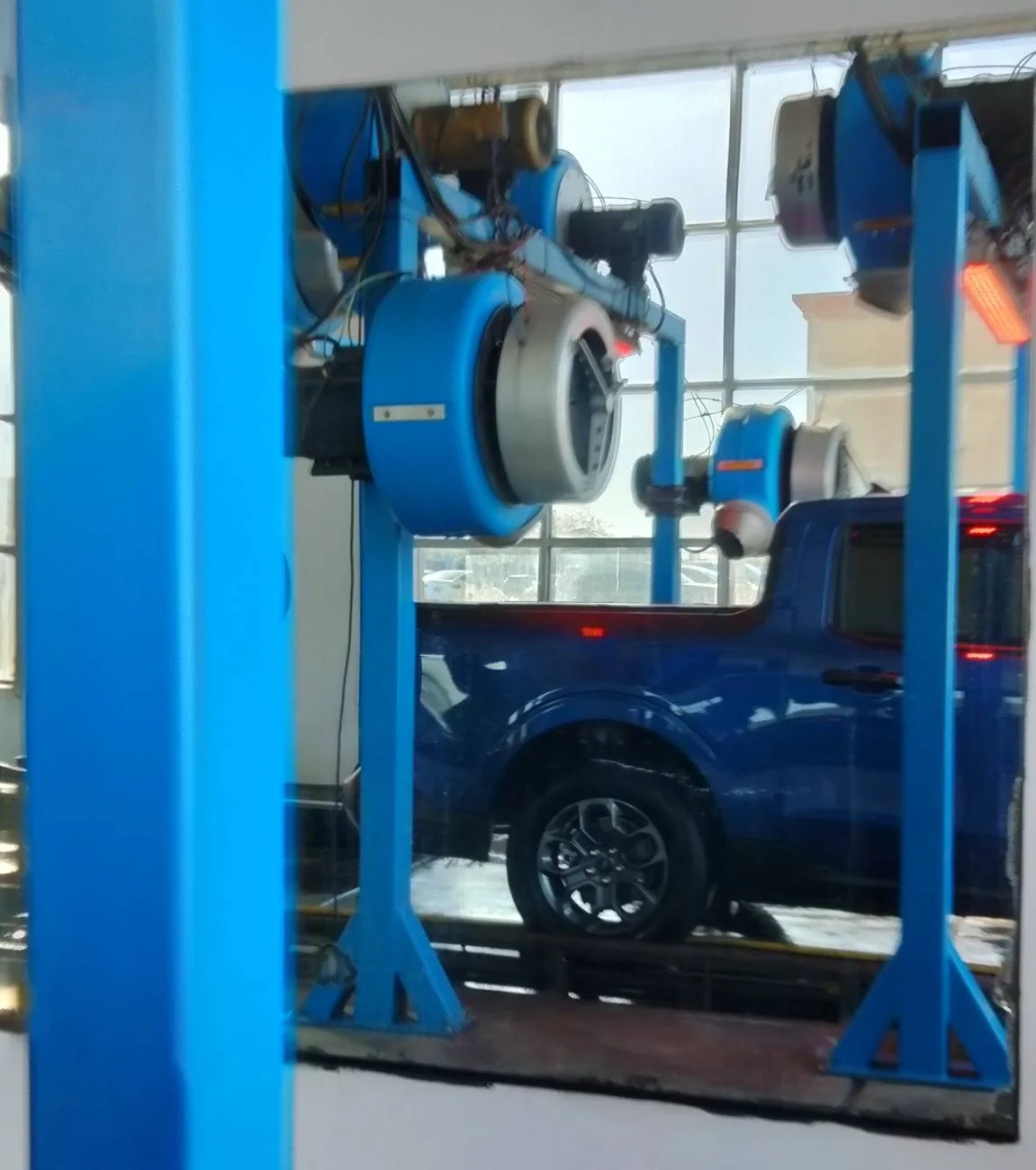

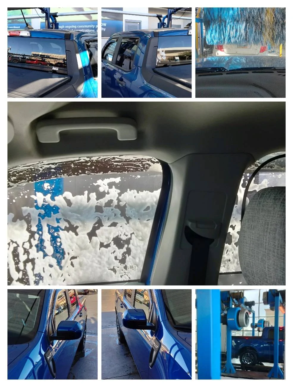

No problem and Great timing.
I got my Maverick washed at the tunnel of torture. I took pictures showing before and after of my window vents and antenna still intact.
I never remove the antenna....
Ford Maverick Window deflectors IMG20241025144047
The torture begins.
Window vents made it.
Ford Maverick Window deflectors IMG_20241025_163105
Antenna is still there.
