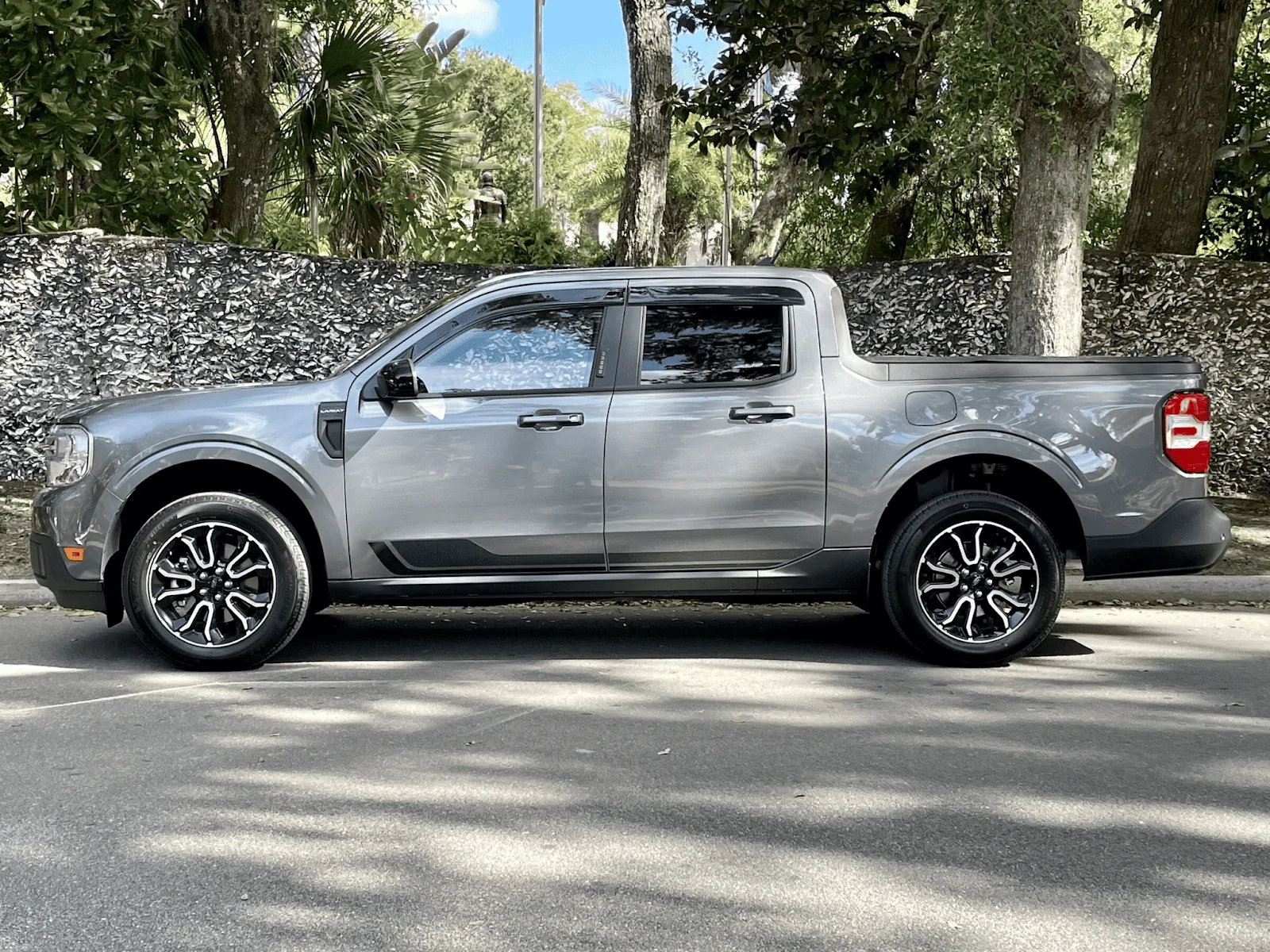

Mounted as high up as possible

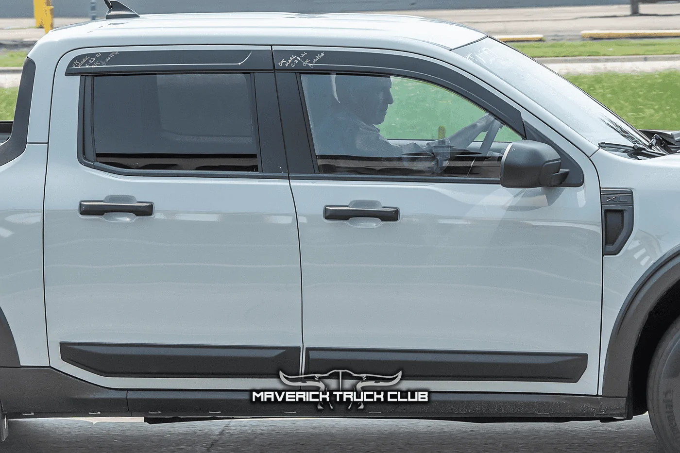

Mounted at the mid-point, (On a Maverick displaying a bunch of prototype mods).

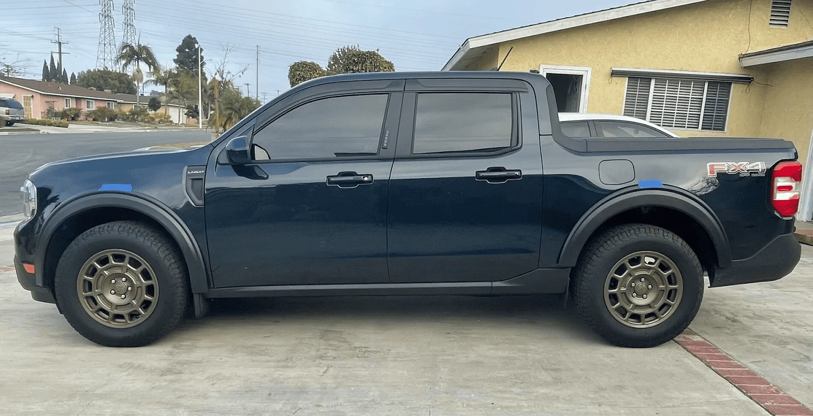

Mounted low, (correct placement?) so the mirror trim and air deflectors transition seamlessly.

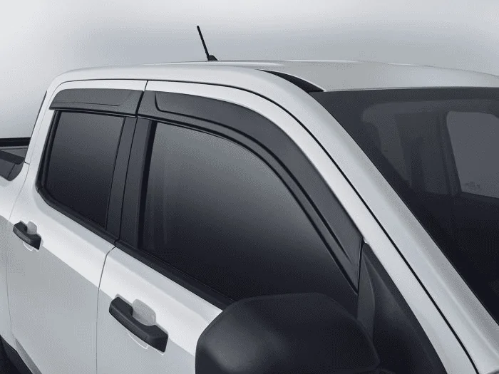

Another photo showing low mount. (From Ford accessories).

The Lund ones that Ford offers are just fine. However, I see that many people install them incorrectly. They don't install at the very top of the door frame. They actually install on the rubber seal at the top of the window and will align with side mirror lines. The 3M adhesive works very well provided that you prep the area before hand. I've used these types on a few vehicles and I've never had an issue with them when installed properly. The issue is most people don't install them properly. I've seen at least a half dozen Maverick on this forum that don't have them installed in the proper location and in some cases they were installed by an idiot dealer tech.

i thought the whole point is to be able to open the window a few inches and it be covered by them? if mounted up on paint they are almost even with top of window. all pics from avs and lund show them more on rubber molding
