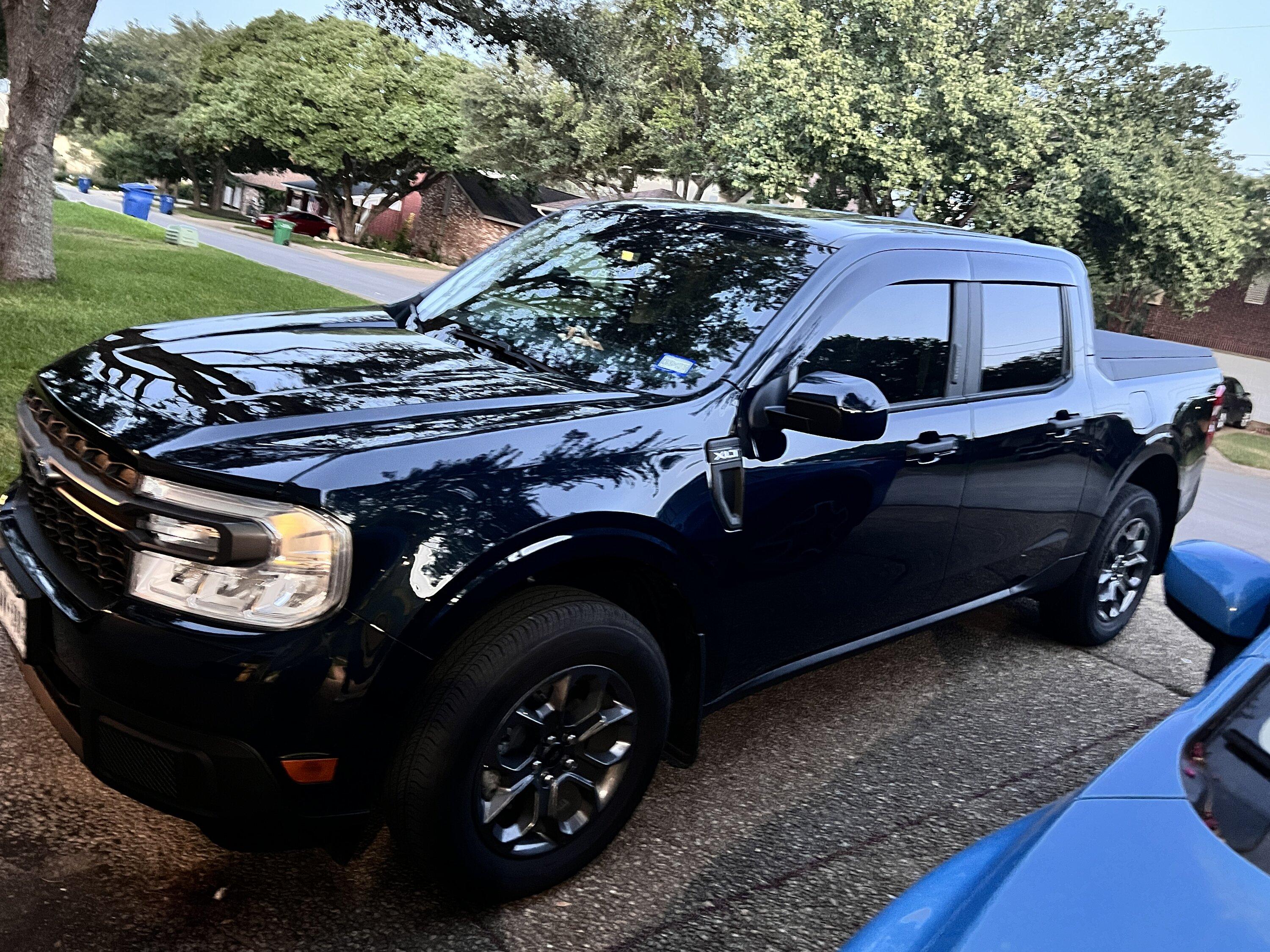

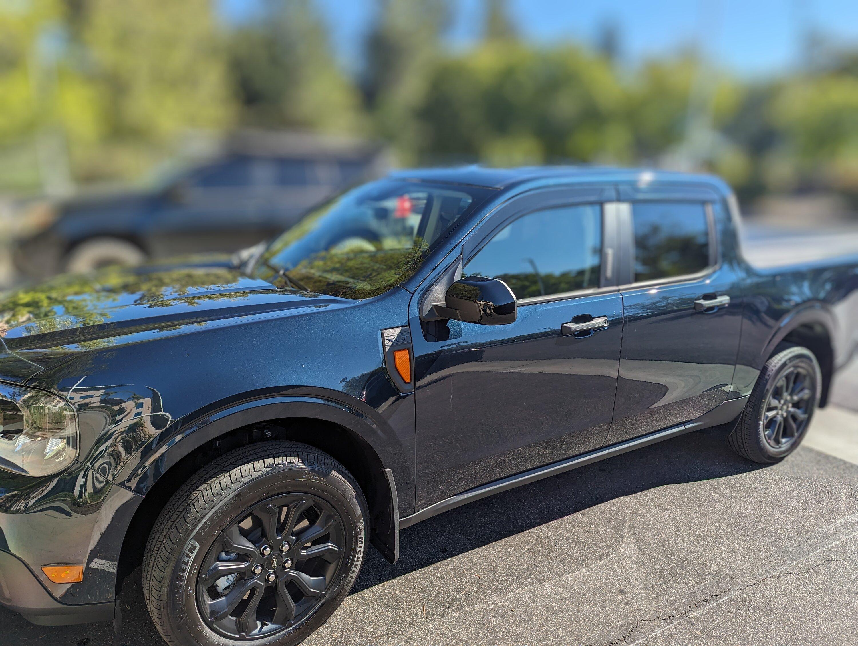

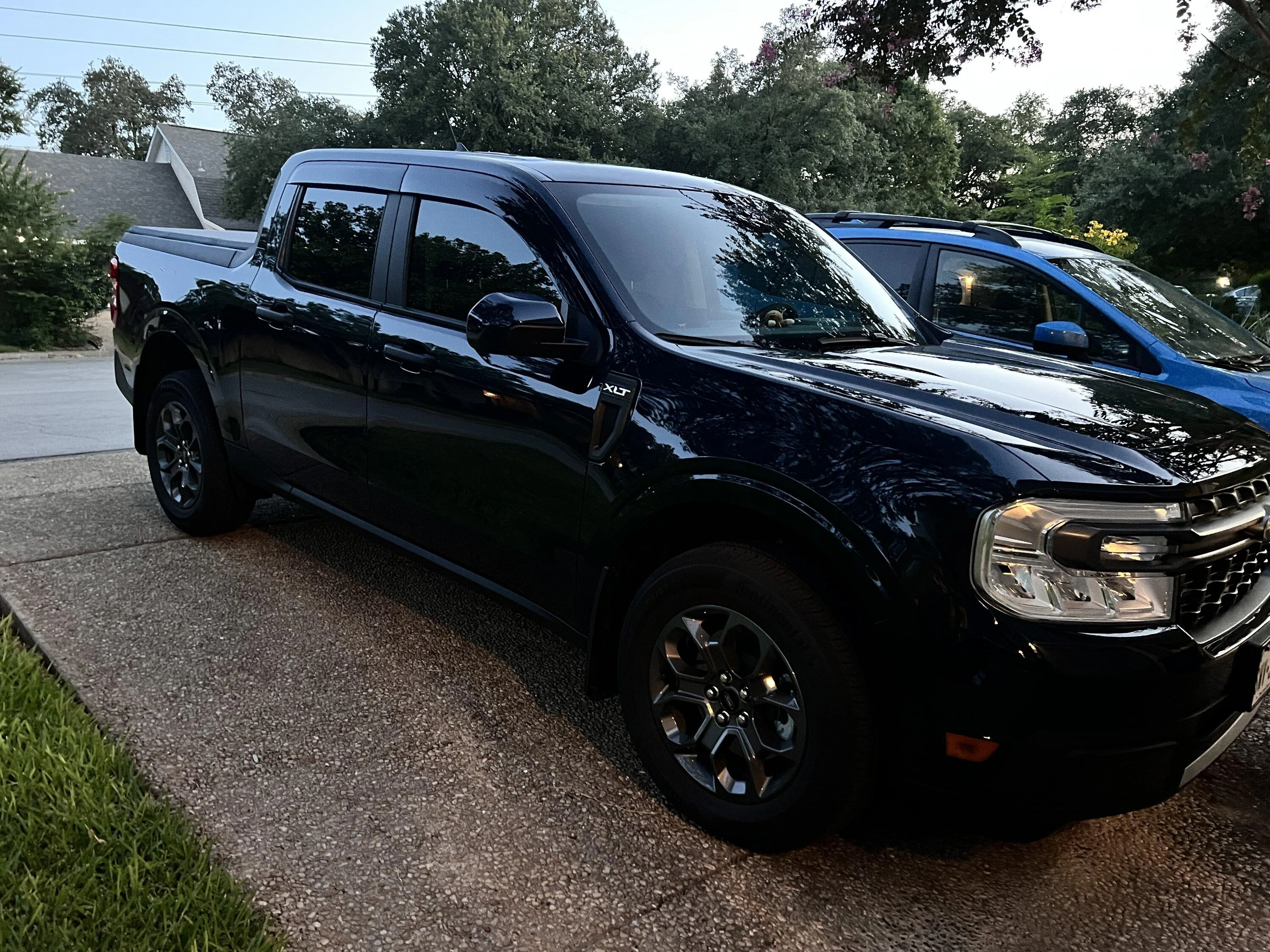

The Lund ones that Ford offers are just fine. However, I see that many people install them incorrectly. They don't install at the very top of the door frame. They actually install on the rubber seal at the top of the window and will align with side mirror lines. The 3M adhesive works very well provided that you prep the area before hand. I've used these types on a few vehicles and I've never had an issue with them when installed properly. The issue is most people don't install them properly. I've seen at least a half dozen Maverick on this forum that don't have them installed in the proper location and in some cases they were installed by an idiot dealer tech.
I think they help with sun, but also when it rains and you go up to a drive thru the rain will roll off outside your door instead of inside on it. Plus as others said, you can crack your windows down a bit to give some ventilation when you car is parked on hot summer days.
Good post. The easy way to get them right is after cleaning the area with alcohol then a go a couple of inches in from each end measure 1/2" up from the edge of the metal and stick a small piece of masking tape at each spot. Then just line up the top edge of the vent with the bottom of the tape and it will be perfectly aligned.

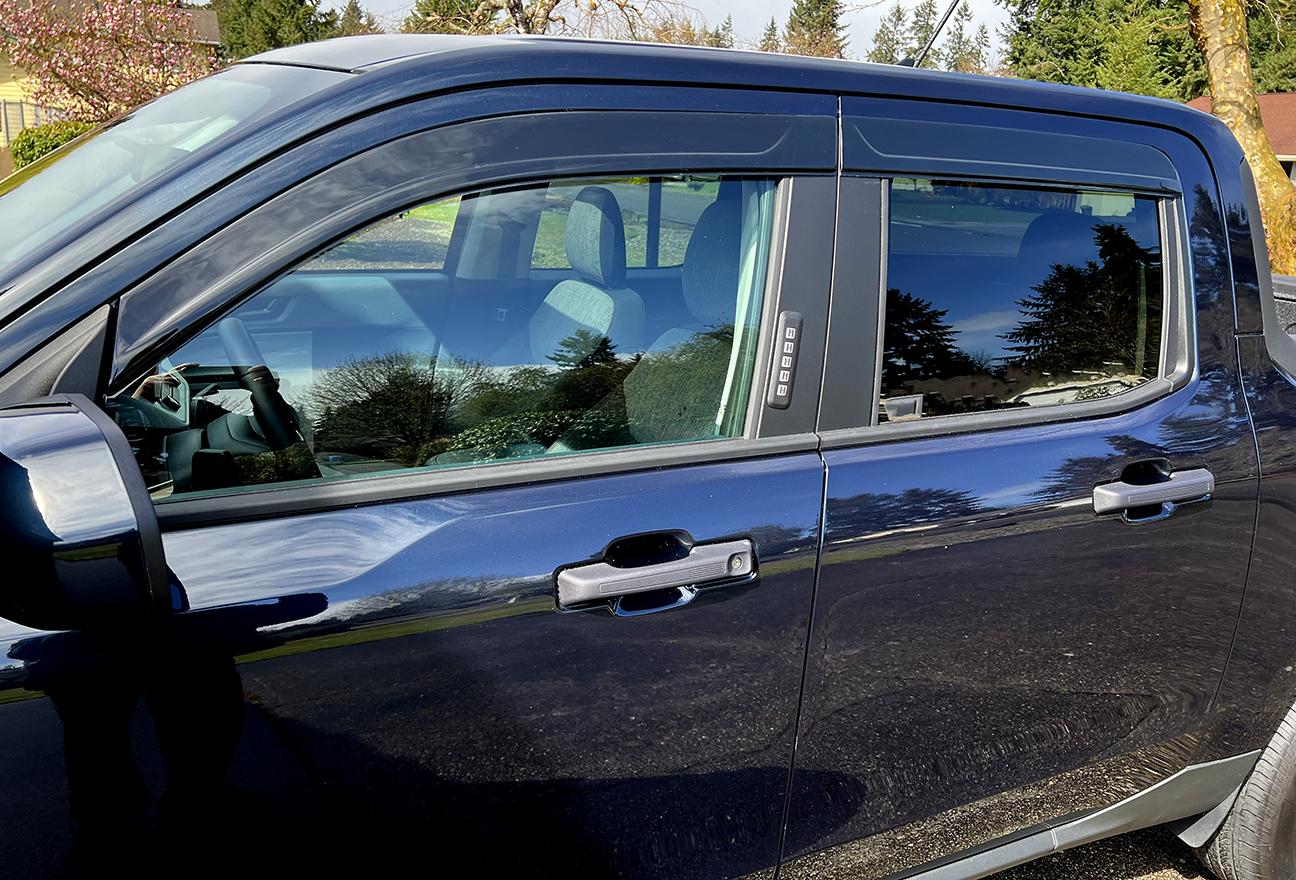

I ordered the Ford factory deflectors with my Maverick. When I picked up my Maverick the dealer had not installed them yet, they asked me if I wanted them to do it while I waited. I told them that I would install them. Glad I did that as so many dealers have installed them incorrectly.
I didn't like how the rear deflectors ran past the window, don't understand why they were designed that way. So I cut off about 2" and they now line up with the window opening area:
Ford Maverick Side Window Deflectors Window_Deflectors_01

This is how they should look!

What did you use to cut the 2 inches off
