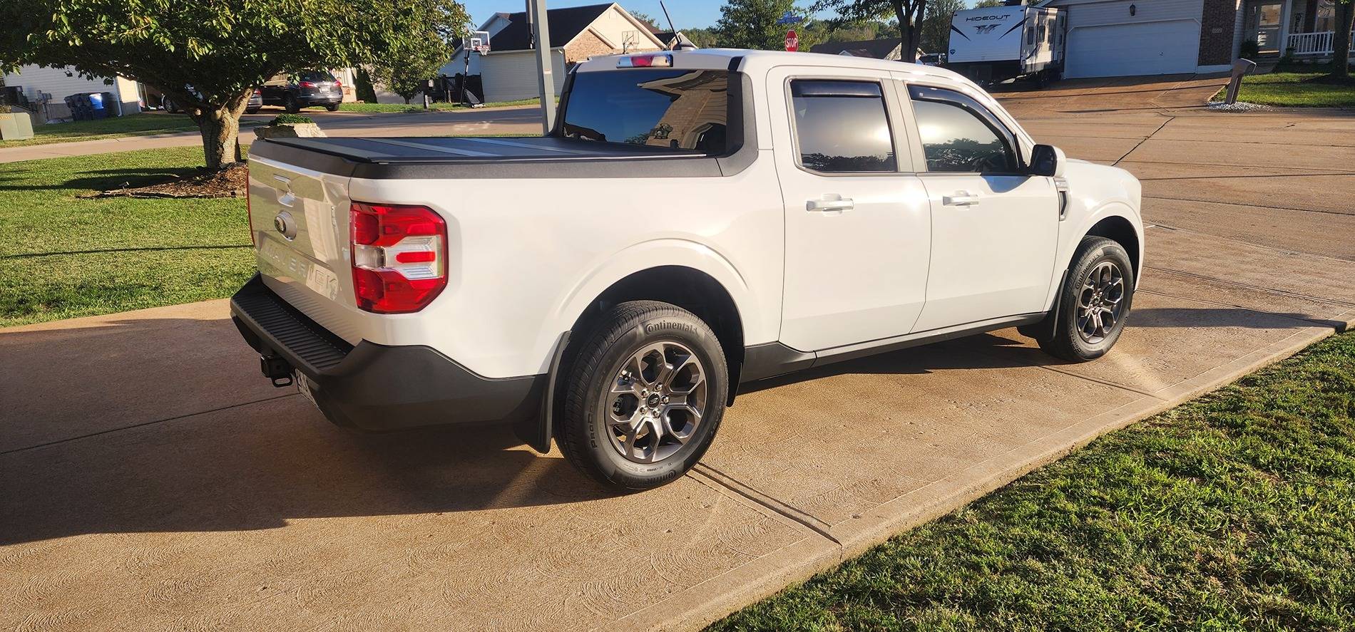

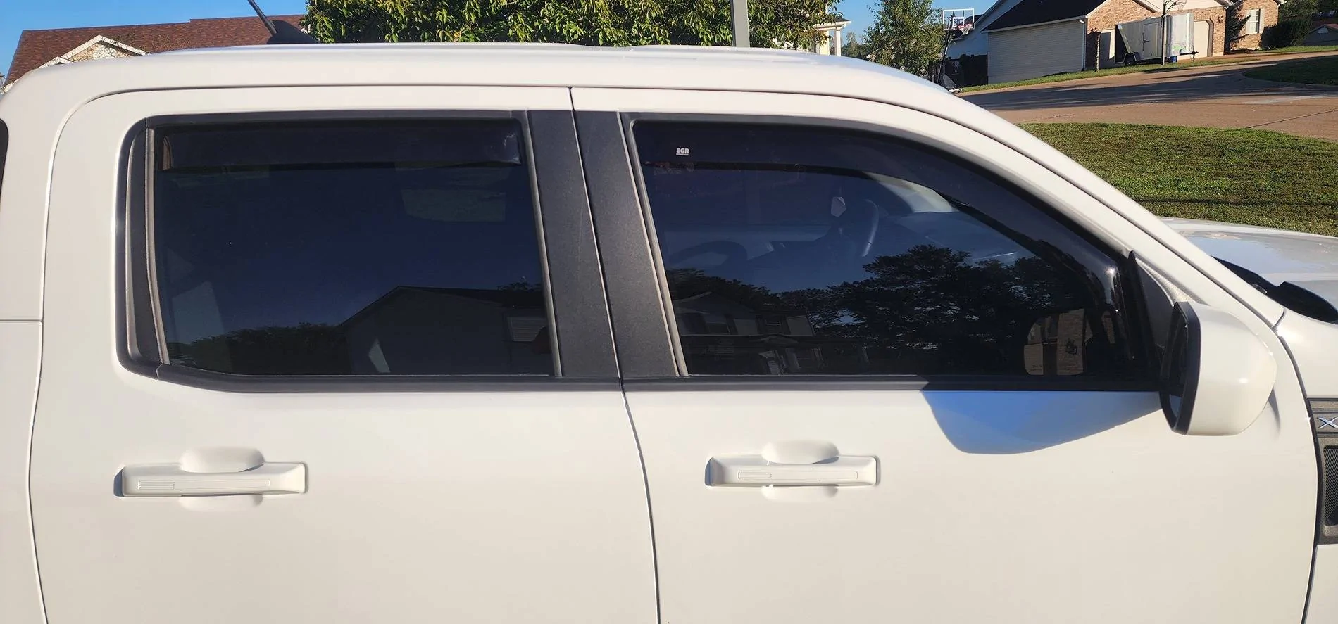

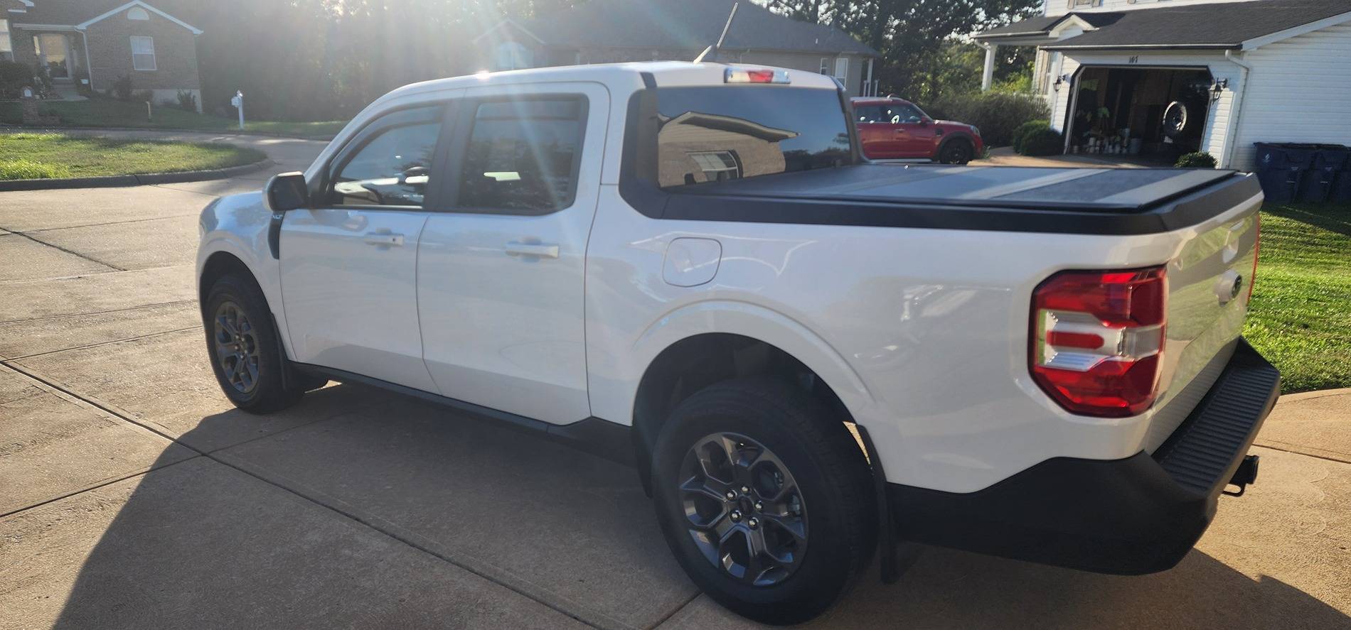

Arrived today and installed... If it wasn't for the laser etching on the fronts, you almost wouldn't be able to tell they're there.
Update: I've been using these daily, and experienced zero bounce back. 👍😎
I thought they were before pictures.
I had to enlarge the pictures to see them. Very slick 👍
