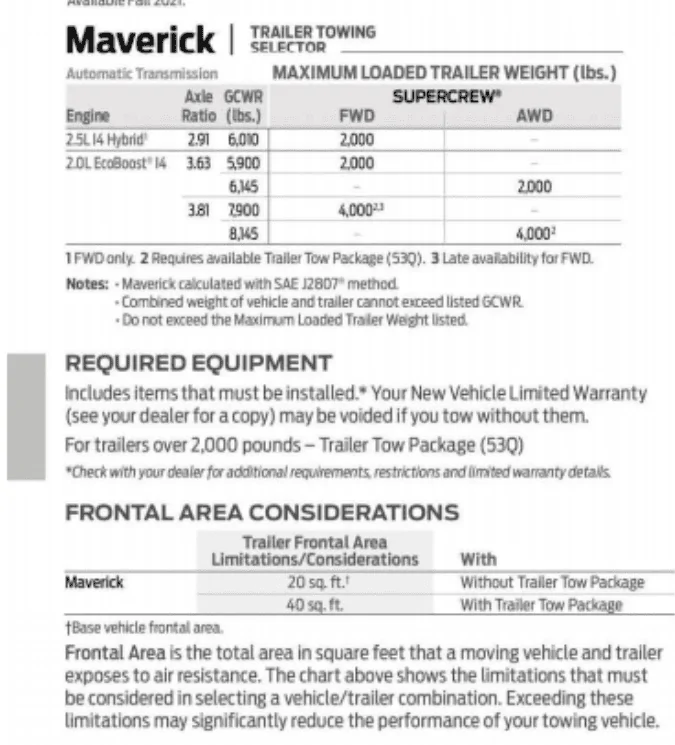

Because most Americans are stupid. They ignore the GCWR and think they can haul a 4,000# trailer, 1,500# in the bed and 5 passengers in the cab! LOL.
The max your truck and trailer can weigh if it is a hybrid including truck, passengers, cargo, fuel and trailer is 6,010 pounds.
The Max an AWD EB with 4K tow package can weigh is 8,145#.
That is for truck, passengers, cargo, fuel, and trailer. Deduct 245# if a FWD with 4K tow.
Ford Maverick Wimpy US Tow Ratings Screenshot (415)
