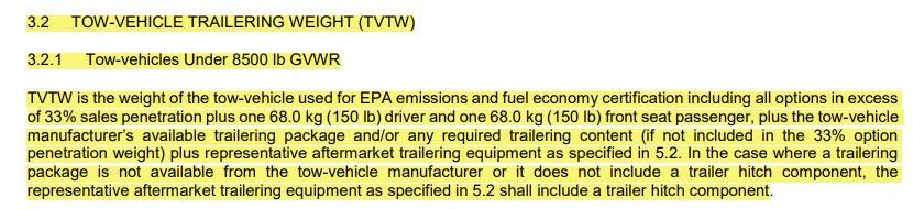

Some quick definitions:
TVTW = weight of the tow-vehicle used for EPA emissions and fuel economy certification including all options in excess of 33% sales penetration plus one 68.0 kg (150 lb) driver and one 68.0 kg (150 lb) front seat passenger, plus the tow-vehicle manufacturer’s available trailering package and/or any required trailering content (if not included in the 33% option penetration weight) plus representative aftermarket trailering equipment as specified in 5.2.
TWR = what Ford calls max. loaded trailer weight rating = the rated value for the maximum allowable weight of a loaded trailer for a specific tow-vehicle model and hitch type, as determined by the tow-vehicle manufacturer. A specific tow-vehicle may have multiple TWRs for weight carrying hitch, weight distributing hitch, fifth wheel hitch and/or gooseneck hitch. A tow-vehicle may also have a TWR for an unbraked trailer.
You can approximate your TVTW as follows:
- Take the GVWR value from your white door sticker. Subtract from it the vehicle-specific payload value from your yellow door sticker. The result is what your Maverick weighed when it left the factory with a full tank of gas. This is NOT the “base weight” we see in Ford literature, it’s what your unique Maverick weighs before you slap on all those aftermarket things.
- Add 300 lbs of passenger weight (as per how the Maverick was tested per J2807) to the above result. That should be an approximation of TVTW. I say “approx.” because we don’t know all option content details on what the Maverick actually used for J2807 testing was.

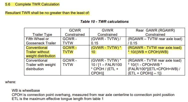

If you look at the “GVWR constrained” calculation for TWR, you’ll find that it’s much larger than the above calculation. So since it’s not the lesser value it can’t be used.
I’m not 100% sure how you calculate the “rear GAWR constrained” case for TWR. You know the wheelbase, you can measure the CPOH distance, but I don’t know what exactly is meant/what the value is for “TVTW rear axle load”. This case may or may not be less than the “GCWR constrained” value.
If you do quick & dirty looks using base curb weights (from Ford literature):
- 2.0 AWD w/4K: 8145 lb GCWR – (3731 lb + 300 lb pass. weight) = 4114 lb TWR (close to 4000 lb max. trailer weight rating Ford has in the 2022 Tow Guide).
- Hybrid: 6010 lb – (3674 lb + 300 lb pass. weight) = 2036 lb (close to 2000 lb Ford value).
- 2.0 FWD: 5900 lb – (3563 lb + 300 lb pass. weight) = 2037 lb (close to 2000 lb Ford value).
- For a 2.0 AWD with FX4: as per Ford you have to use the plain 2.0 AWD GCWR, so 6145 lb – (3731 lb + 300 lb) = 2114 lb (close to the 2000 lb Ford value).
So, if you add the FX4 option to a 2.0 EB AWD vehicle, is that an “on at least 33% of Mavericks” item? It’s certainly not considered an ‘available trailering package’ nor is it ‘required trailering content’. I don’t know for sure why Ford didn’t test/rate an FX4 variant but they didn’t, and that’s why it falls under/is rated at the same tow rating as a 2.0 EB AWD without it.

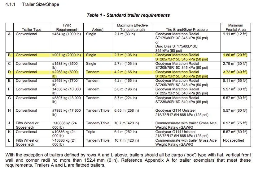

FRONTAL AREA
Ford is one of the few manufacturers that actually mentions Frontal Area considerations for towing. GM doesn’t mention it at all in any of their owner’s manuals or towing guides. I found on this forum (and all other truck forums) that many people are confused about what it really means.
Anything Ford says about Frontal Area and all the values they list are directly related to SAE J2807 and exactly correspond with how the vehicle was tested and what it was tested with. That’s it in a nutshell.
Ford did not come up with these frontal area values. They are not ‘ratings’ per se. They directly and exactly correspond with Table 1 – Standard Trailer Requirements of J2807. Mavericks were tested according to rows B (< or = to 2000 lb TWR requirement) and D (< or = 5000 lb TWR requirement).
Take a look at page 16 of the 2021 Ford Towing guide. Every frontal area value listed can be directly compared with rows A through K. From Mustang to F-600 Super Duty.
What Ford says:
The chart shows the maximum trailer frontal area that must be considered for a vehicle/trailer combination. Exceeding these limitations may significantly reduce the performance of your towing vehicle.
What Ford is telling you is this: “Hey, your Maverick was tested against J2807 standards, that’s why you have a xxxx lb max. loaded trailer weight rating and a yyyy lb GCWR rating. And as part of that testing it towed a trailer with a zzzz ft2 frontal area. The Maverick as configured passed the tests and didn’t blow up or stop dead in its tracks or overheat and go into limp mode. Now, if you’re thinking of trying to pull a much larger parachute (i.e. travel trailers way bigger than the ones we used to test it with), your powertrain will have to work harder (more aero drag), things will probably get way hotter, bad things like overheating could happen, because we don’t know your actual towing conditions, we just know what criteria we tested it against. So, you’ve been warned, Buyer Beware.”
There is no way to quantify how much “above” listed frontal area limitations you can go w/o actually encountering a problem other than trial and error. So, most people don’t try to “greatly” exceed listed limits when buying a travel trailer. I doubt any experienced travel trailer tower with a Maverick 2.0 EB AWD 4k tow package will lose any sleep if their TT has a 45 ft2 frontal area. Maybe not even with 50 ft2. Maybe more. Throw in a long trip up with high winds and/or down mountains in 100 deg. F ambient temps and maybe you’ll have to seriously adjust your driving habits.

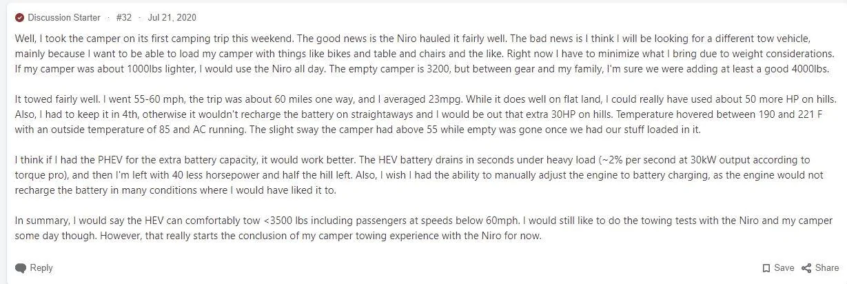

My favorite ‘what can I really tow’ is this guy I am pulling a 3200lb hi-lo popup with my 2019 niro HEV, and I will be doing the SAE J2807 tow rating tests with it. | Kia Niro Forum . This Niro Hybrid’s tow rating per KIA (they didn’t do J2807 testing) is…zero. “Not recommended”. But he didn’t just hitch up his trailer and hit the road. Lots of clarifiers:
- It has a 6-speed DCT (not a CVT ‘slush-box’ as he calls it), used only Sport mode while towing
- He fully instrumented it (loads, energy draws, temps, etc.) with Bluetooth OBD module and Torque Pro software
- Installed a hitch receiver (and may have used a weight-distributing hitch he bought, not clear), installed air bags (to prevent rear ‘squat’), installed trailer brake controller (TBC) (his pop-up has trailer brakes)
- A controlled route, a couple hours max. tow distance, 55-60 mph max. tow speed
- He’s an automotive engineer
