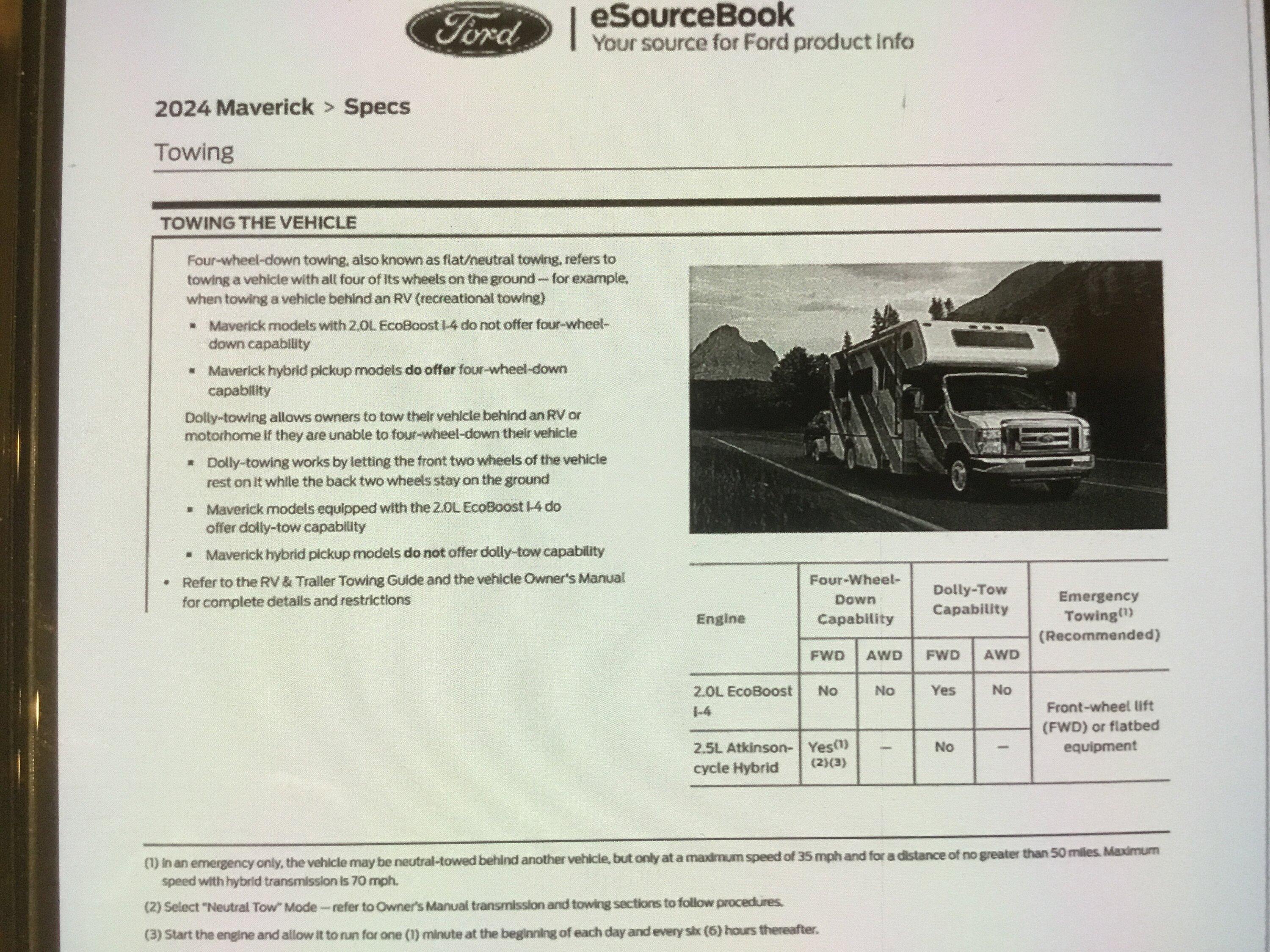

I just ordered a maverick hybrid 2024 to tow behind my RV on a tow dolly. But after reading on Ford site,, it seems like the 2024 cannot be towed on a tow dolly. I did read other comments about people having problems with warning lights coming on after towing it on a tow dolly. I really like this truck.is there a fix for this one
Ford Maverick Tow dolly image

I saw you post over on the other dolly thread. Not sure what others have found but on my 22 i pulled up in slippery mode and got no warning lights. Also similar to what others have found driving a half mile or so all the warning lights clear out. I didn't think Ford has changed anything major from 22 till now. So maybe they just don't have an answer to the problem.

Pager 16 of the 2023-Ford-RV-and-Trailer-Towing-Guide
Ford Maverick Tow dolly 1698285399947
