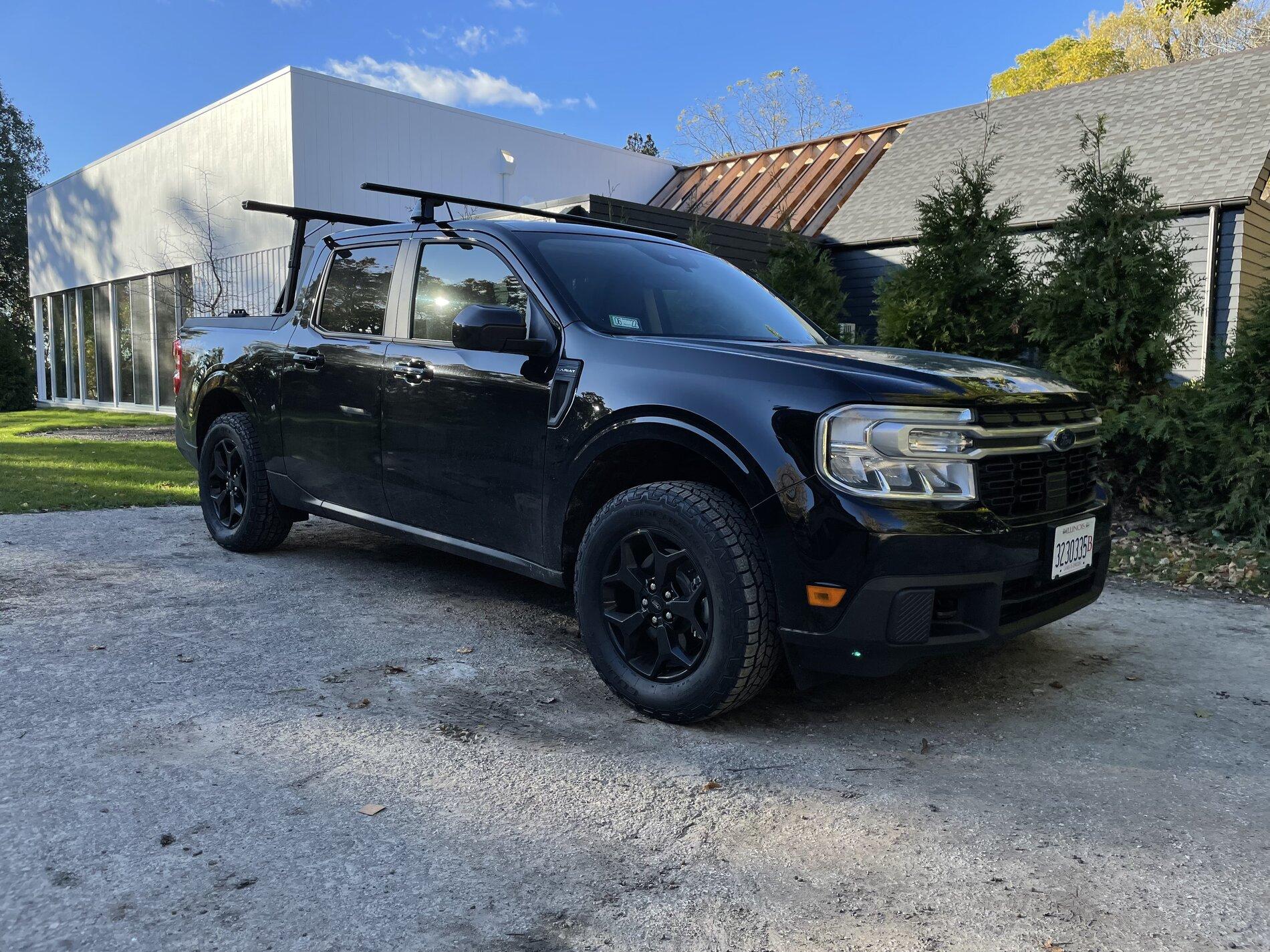

I like the idea of at least one rack on the roof to protect the roof/antenna. and probably only need the back rack when carrying longer loads. How easy are they to add/remove?

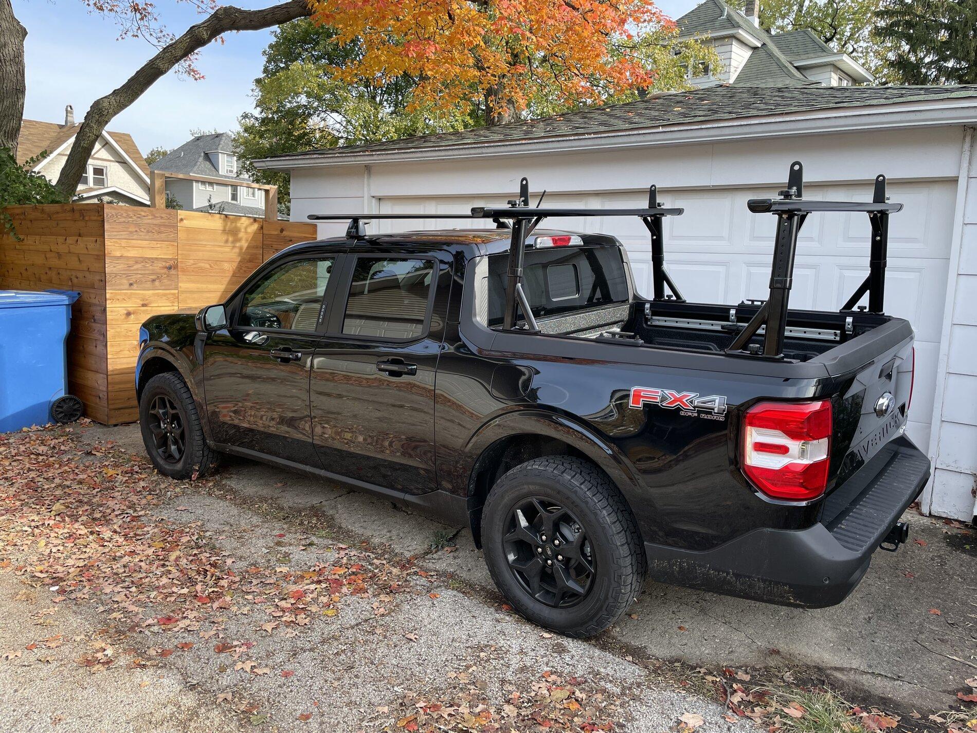

Here is the full setup. Now I just need Bak to ship the Tonneau cover and I’ll be GTG.
Very easy to remove the rail sets once everything aligned appropriately. The tightening to the rail is a knob so you just hand loosen both sides and they slide right out.
I made a mistake during install so I had to take it on and off twice as one unit, not a problem at all.
really pleased and everything is rock solid so far.

I've never had a clamp on roof bar/rack, I imagine they have some kind of rubber padding to protect the paint?

Looking forward to the install video for the tonneau. I am very curious to see how the two get mounted together.

Is the Antenna above the level of the rails? Planning to do something similar with a rooftop tent but I think the longer antenna might be in the way .
Honestly I just removed the antenna. Hasn't messed with my reception at all for local stations but I live in a city so that might be why. I plan on keeping it in my glove box unless I need it.

I'm so jealous of your truck.
Do you think you'll have issues like this guy did?
Revolver x4 fitment issues with elevate rack
Also, can the uprights be cut down so they can be lower? I can't imagine anyone would need to go higher than the lowest setting you have now. I was hoping I could be just below flush of the top of the cab and when I need it raise it up for lumber.
