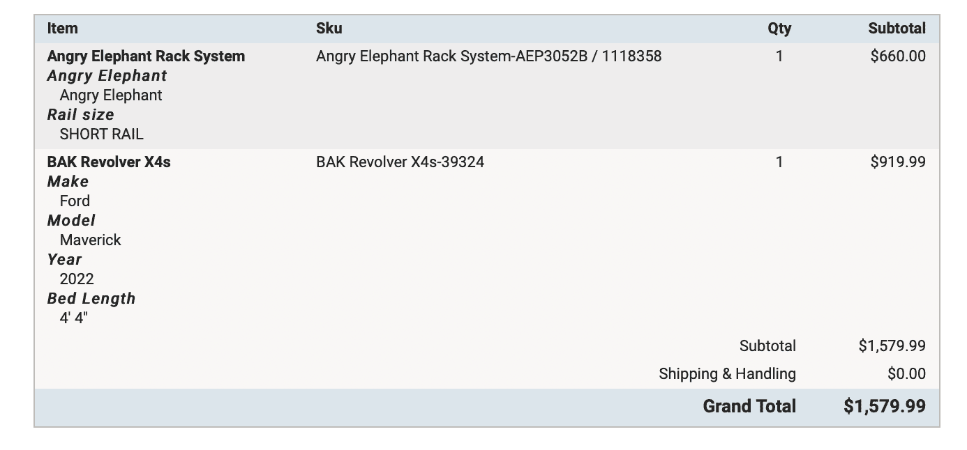

Ok so I pulled the trigger on the Elevate Rail + Angry Elephant (P3000 rack) + X4s Hard Rollup cover package from Tonneau Factory Outlet.
https://www.tonneaufactoryoutlet.co...-revolver-x4s-angry-elephant-rack-system.html
Only $1579 - Which is crazy because I had already paid $1000 for the cover on it's own - an order I'm going to cancel, as it's taking a few weeks for them to ship out the maverick cover anyway.

Great find, I got a similar price and also placed an order. They added more rail size options as well very recently, they didn't have them all before.
An FYI for anyone else looking at Tonneau Factory Outlet, the website doesn't show the latest and greatest stuff (aka most Maverick options aren't shown), but if you call/chat/email them, they can get you all configured and price quoted on a tonneau/rack package.

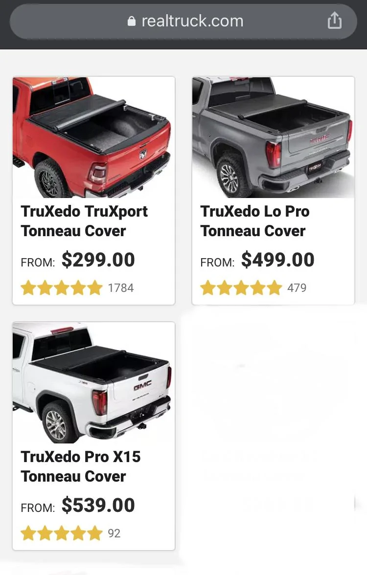

Truxedo Pro x15 supposed to be avalible for your Maverick
I’m not sure I see the point of this reply. However, that cover will work with the elevate rail system, just like any low profile cover. Nothing unique here regarding cover / rail integration.

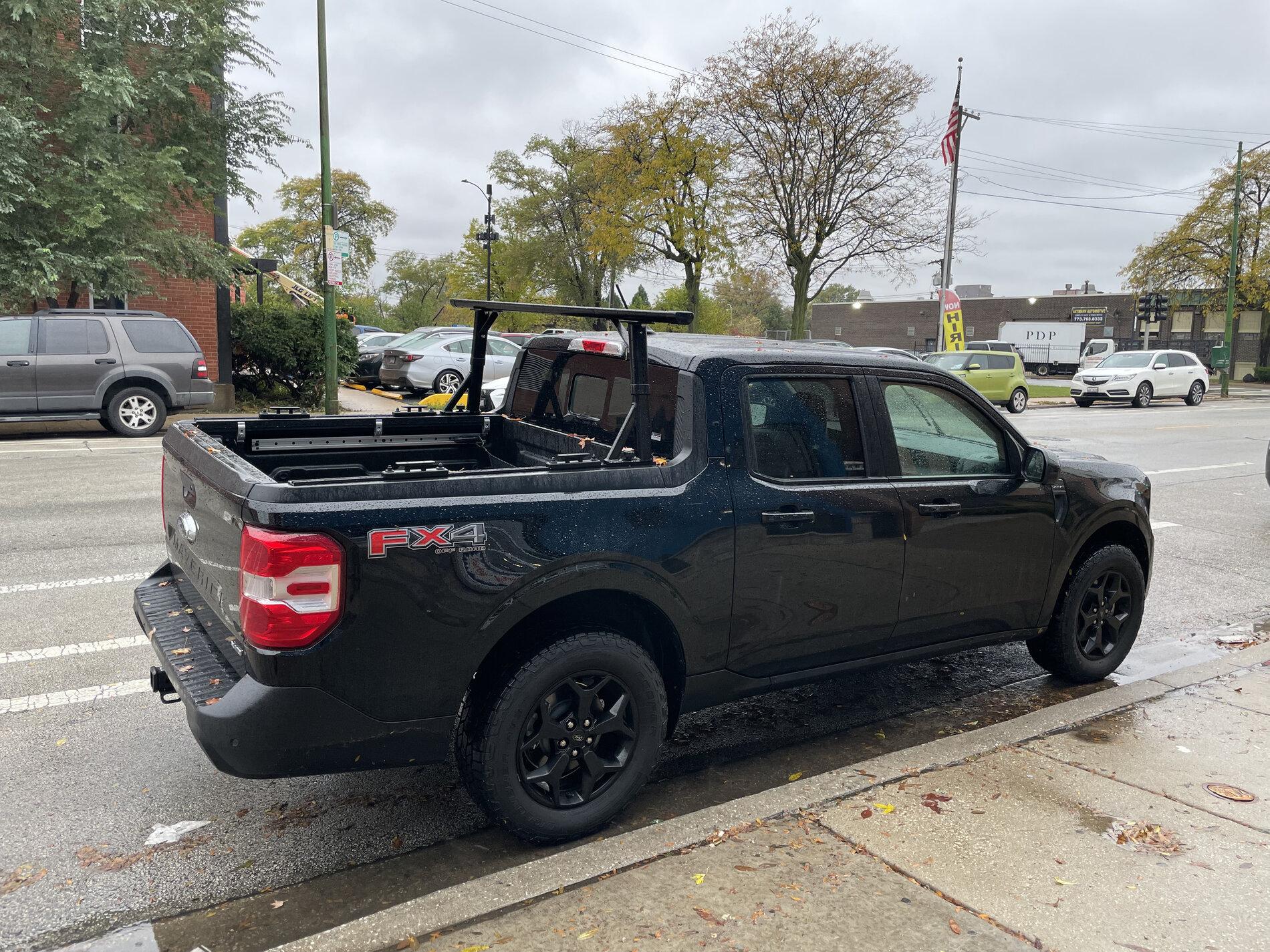

2 more videos below and got the first set installed, pic at the bottom. My rack was missing 2 pieces for the other vertical/crossbars so I could not install, will be coming Monday.
and the Bak X4s won’t ship until early November so it will be a while until the full system is setup. But I can already see how easy it will be to install over the elevate rail.
final rail install fit
Rack T-slot hardware install
I dont have a video of the cross bar install but I’ll show that with the final set. Early feedback is the system feels very solid overall, I will be hauling some lumber in the next few weeks so I’ll be putting it to the test! I also have 1 Yakima roof rack to install so I have 3 points of contact for my 17’ Canoe or long lumber, probably do that this weekend.

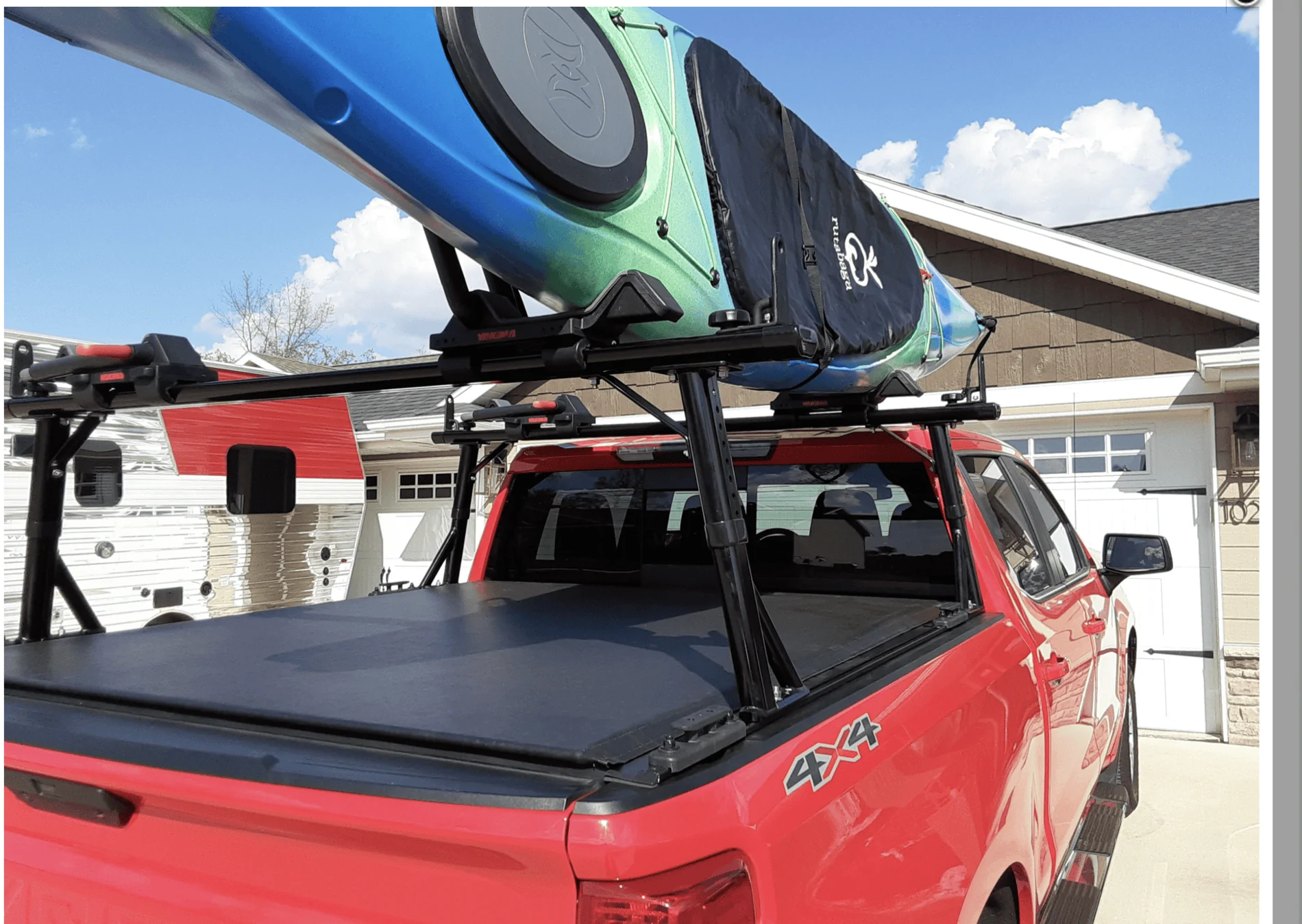

Update with the Yakima Rack added. Finishing the Angry Elephant Rack today.
oooh, i like that. so only one rack in the bed and one roof rack?
I’m adding the back rack today, but yes I may go with just 2 most of the time. Because the back rack can be adjusted on the fly I can space them however I want.
I like the idea of at least one rack on the roof to protect the roof/antenna. and probably only need the back rack when carrying longer loads. How easy are they to add/remove?
