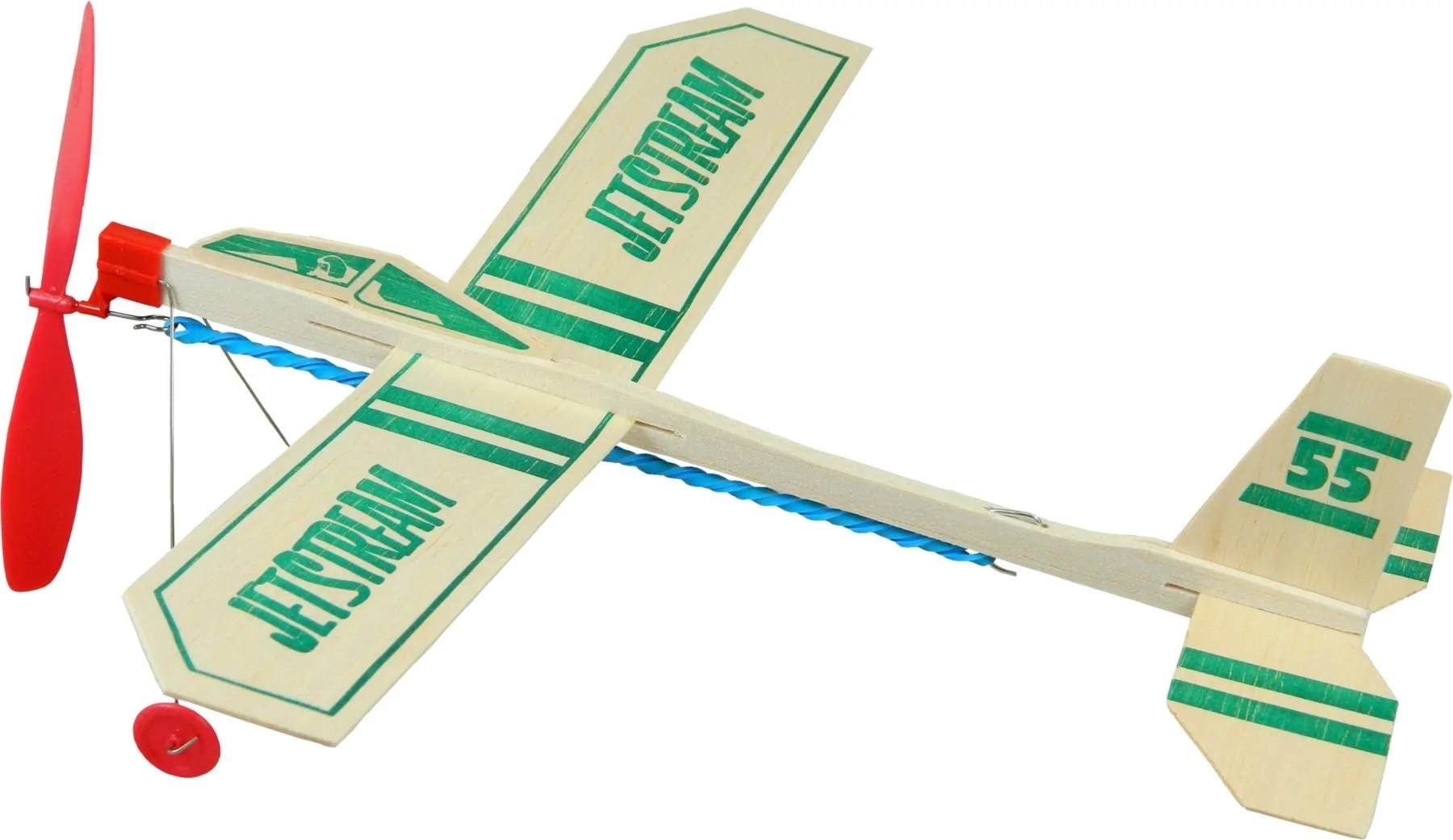

BWAHAHAHAHA
Thanks - I needed that this morning. A good chuckle and some fond memories.
(BTW - that shouldn't fly according to what they teach in school - and FLIGHT school - about airfoils, lift, and why planes fly. LOL)

those things actually"plane" the air angle of attack,consider most kites,not all laws are immutable.

At the risk of a total thread hijack - I get that. Bernoulli's theorem (taught almost universally as why things fly) doesn't cover a lot of things like ground effect, symmetrical airfoils like on at least one Pitts version (that oddly enough flies faster inverted) etc.
Kites are a special case as they pull against the tether.

consider angle of attack,its critical to airflow and stall,you will notice on modern plows the "angle of attack" is critical,to shallow they skid,too steep they bog,who would have ever thought the first"flying bathtub" lifting body(check out "dynasoar" while testing being towed those things would become airborne before the tow plane,theres a lot more to aerodynamics and bouyancy then first meets the eye,chamber lift is very important,watch crows fly( wing warping on the next level) there was talk of building high performance aircraft with no conventional control surfaces( induced drag from active wing skins etc,causing the aircraft to yawl and skid in the desired flight envelope,you watch things like a super hornet take to the air( must be why they are so noisy) with all the junk hanging in the airstream its a wonder they can get airborne( thrust very important)
