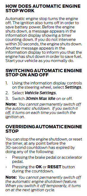

Most vehicles like Ford have a Max Idle Setting for 30 minutes within the vehicle. This CAN be turned off if you wish.
That is correct. From the owners manual:
Ford Maverick Push button start - will vehicle shut itself off if you forget to power off? 1638304051097
Also, if you leave the vehicle with the key while the engine is running, you cannot move it out of park.
