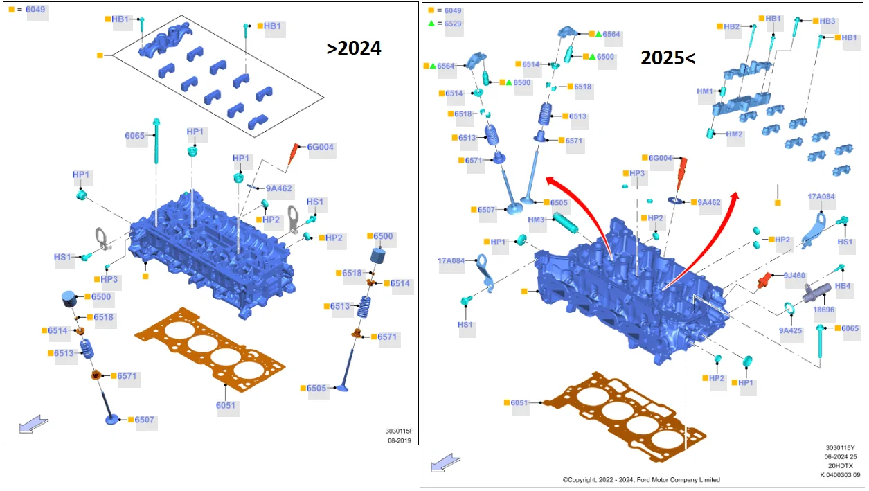

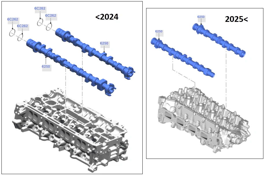

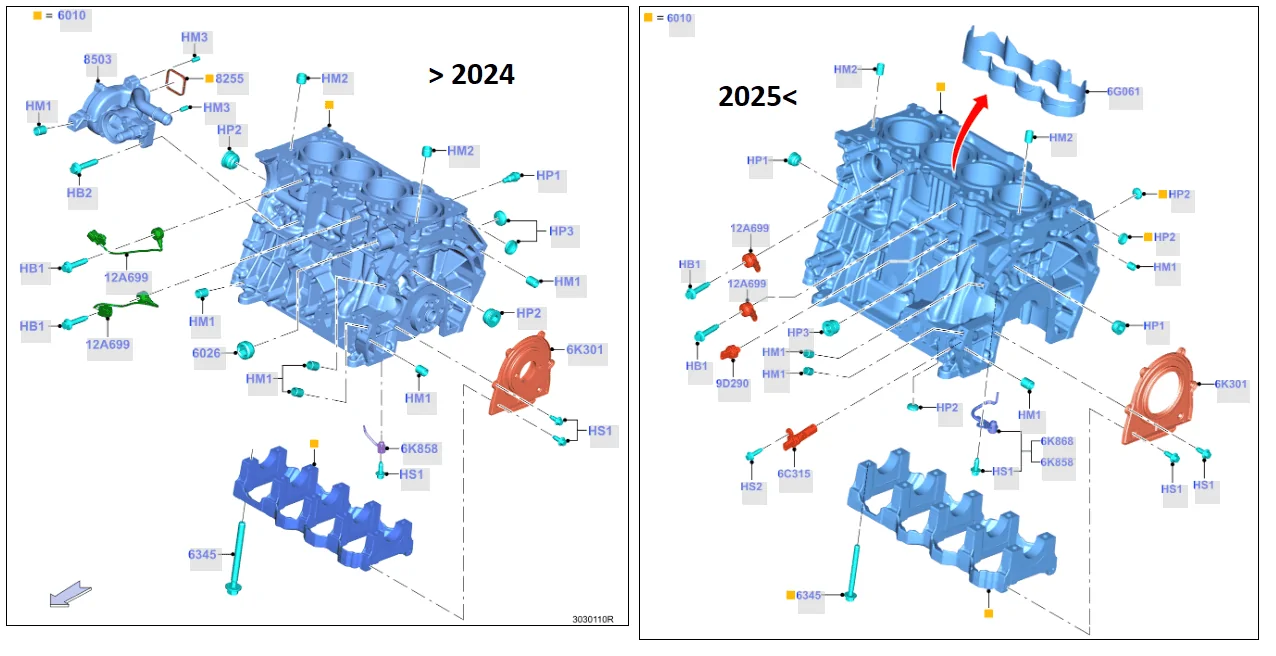

What would you consider a major engine component? The block? Same. Cylinder head? Same. Crankshaft? Same. Pistons? Same. Connecting rods? Same. Valve train? Same. Turbo? Same. Direct injection system? Same.
You'd be wrong.
It's a completely new engine. Different block, different heads, different cams, different fuel system, different valve cover, different intake, different flywheel, different water pump, different thermostate housing, different crankcase ventilation system, etc...
