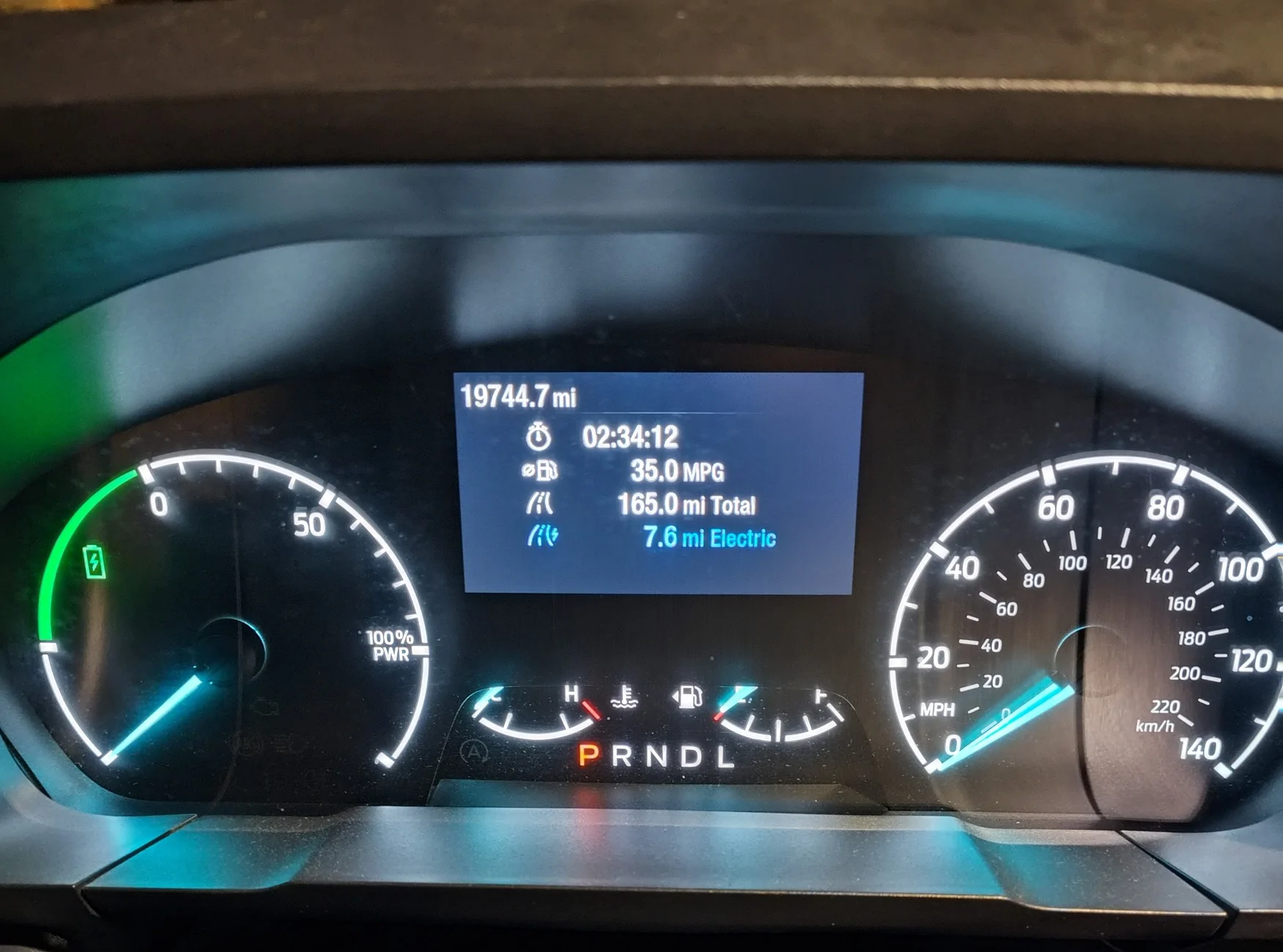

If you have some hills available to you - it's very interesting to watch the instant MPG - which is actually pretty accurate because it knows the exact fuel used and distance traveled, on different slopes or speeds. Especially matters at highway speeds.
As mentioned - the correct RPM range for ICE efficiency, which also means correct eCVT gearing range - makes for some incredible MPG on hills that seems unbelievable.
Just did a trip from KC Metro to Arkansas Ozarks - so pretty flat down to Clinton until approaching Springfield, MO.
Right around 30 MPG.
Start throwing in the hills getting closer and after Springfield - 35 MPG, because the RPM was going up when I needed to go up to an efficient range, and despite speed too fast on the slight downs for just EV use, ICE power barely needed.
Even the steeper hills were still at 32 MPG - until the steepest approaching Branson, those finally got down to 20 MPG.
Part of the reason is because the traction motor torque starts getting thrown in there for assist, but also the RPM band for the ICE. I could distractedly watch the scanner data for RPM and see right when it crossed from less efficient, to most MPG, to less efficient again, on some of the varying sloped hills. Very interesting.
And despite same highway 70 MPH thru that whole area - still 35 MPG. Better than the flat highway constant travel getting there.
And that's why my normal driving routes with city to highway speeds only sees me at 40 MPG on good weeks - too flat.

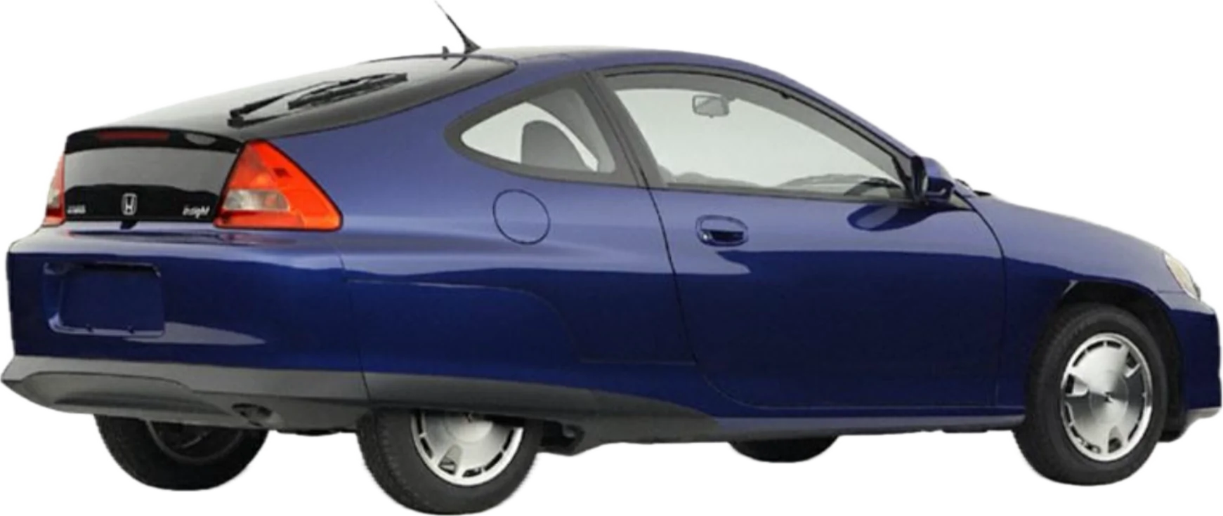

When I get 70mpg driving my Honda Insight Hybrid I would be sure to strategically wait for the downslope to accelerate to speed when the opportunity was available.
CVT or MT?
I used to have a MT. Got me 80 MPG tanks sometimes. 100 MPG possible.
Whole car weighed 1850 lbs I think.
Done right, that car could drive Mexico to Canada on one tank of gas.

I have two MT runners and one CVT to cannibalize. All aluminum and plastic with magnesium oil pan. Super fun to drive!!!
MIMA?
MIMA helped me nurse my stock battery for two decades.
Nice thing of Gen1 Insights: two starters.
Could start with High Voltage or Low Voltage. Also, has there been any other manual transmission hybrids since?
Fun car, yes.
