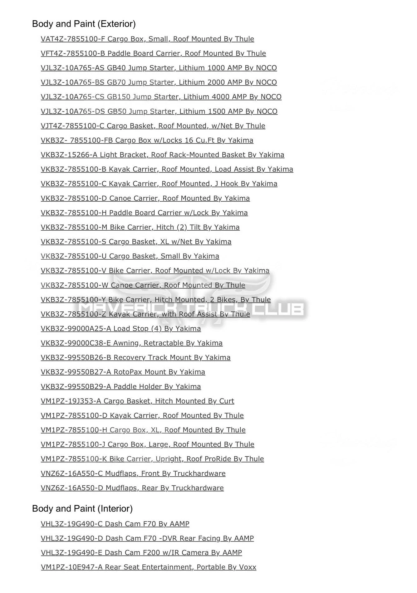

I was thinking since Ford has a list of roof attachments (posted on this forum) then maybe there are already roof mounting areas on each side that you could put a cross bar in and attach to the crossbar.
Ford Maverick Where to put my CB antenna.... 2022 Maverick Ford Accessories Parts list

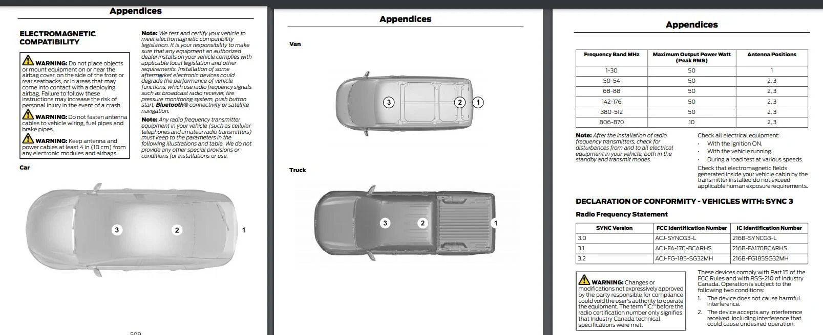

Like I said earlier, the manual for this truck is on this site and it has a drawing that shows 3 places to place an antenna. It also gives power levels and frequencies of your radio not to exceed. I have been a licensed Amateur (Ham) operator for over 50 years. I also have installed many radios in private and government vehicles over the years.
With all the microprocessors and other electronics in modern vehicles, you need to be careful when transmitting RF signals to prevent any damage or interference with the vehicle electronics. You wouldn't want to be driving down the expressway and key the mike to have your truck stop in the middle of traffic. Do your research and be careful.

It's pretty ridiculous that it shows the tailgate/hitch location as the place to mount your antenna for 0-30MHz and 50W? If their system can only handle 50 watts that's ridiculous. People run much more than that in other newer vehicles without issues. The real thing to be careful with is the airbag sensors and not having RF inside the vehicle. An antenna on a roof is usually the best place to minimize RF so weird they mark the tailgate unless they are worried a roof mounted antenna in 0-30MHz would interfere with something inside the cab or engine but that's highly unlikely at even 100W.
I guess I shouldn't second guess the engineers but seems like a low rating to me.
Ford Maverick Where to put my CB antenna.... Ford-Antenna-Mounting
