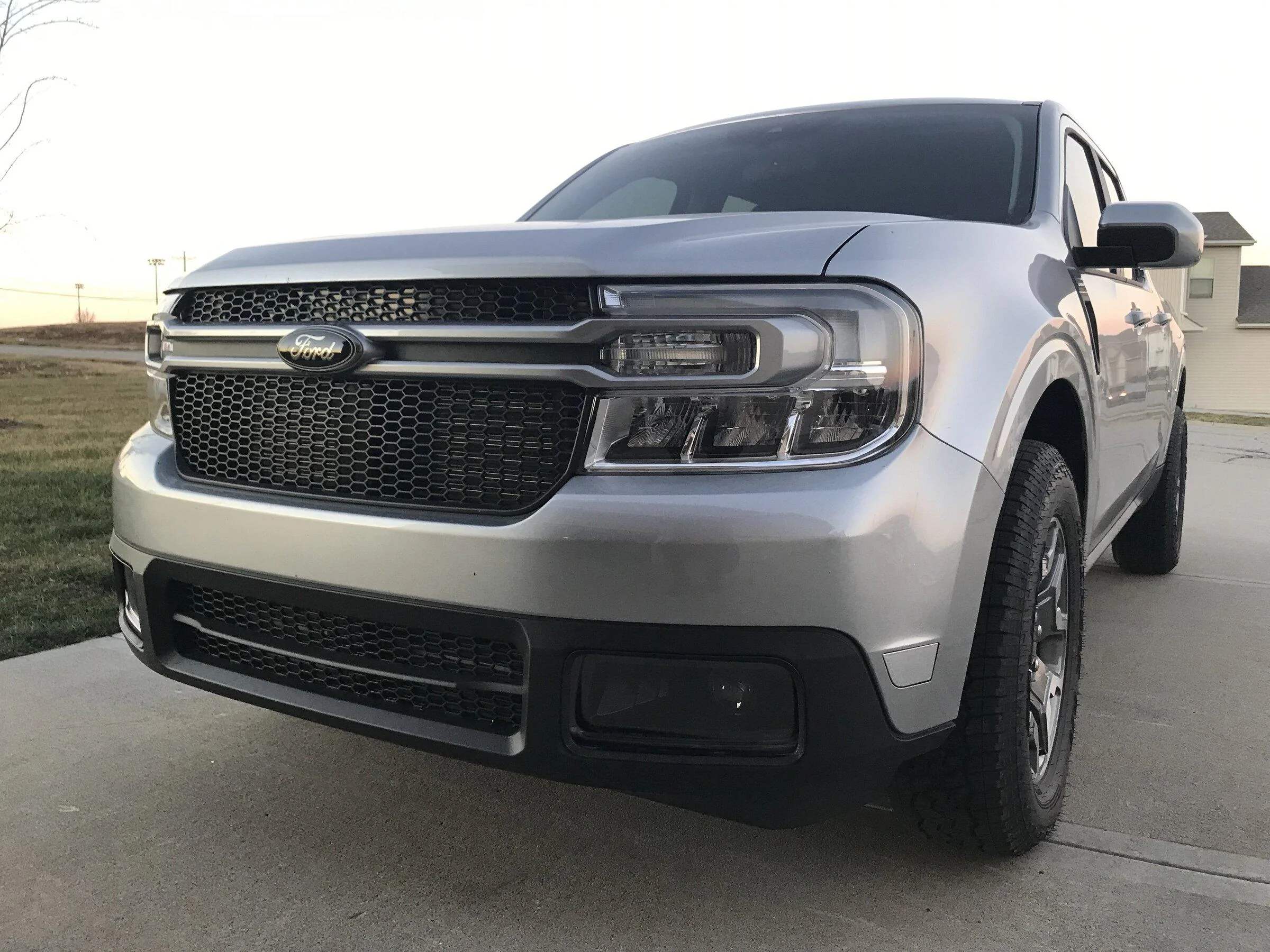

Yeah, I've got them on the rear now with my factory wheels & lugs.
A 25mm would likely get the fitment perfect all around. The 20mm is very close but in this picture you can see the front still sticks out a touch farther than the rear. The tread is still fully within the wheel well though, just the side wall pokes out now.
I appreciate your responses. I ordered the spacers. 20 mm looks perfect! Sweet looking grill!

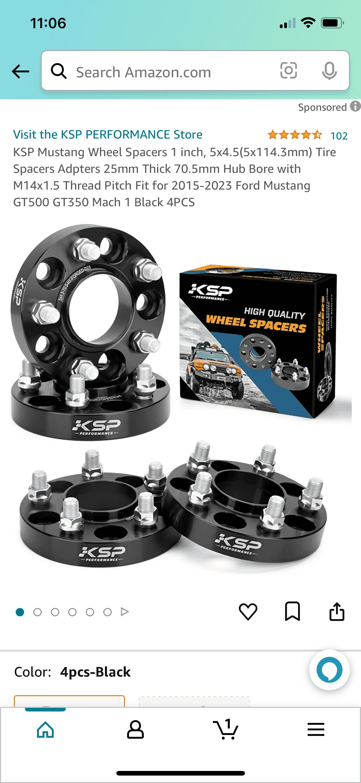

Looking to install spacers on my Maverick. Just for aesthetics, would this spacer work? It’s M14x1.5 if not can somebody post what there using.
