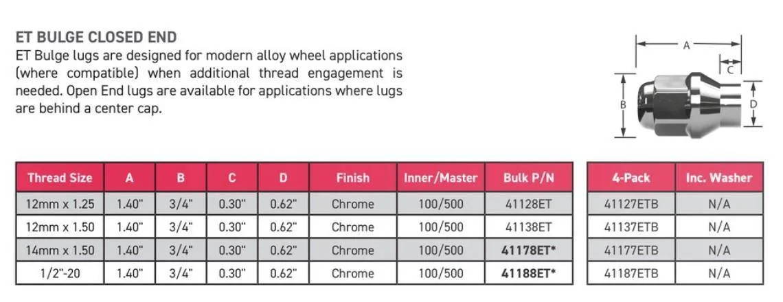

they yield an extra 7.62mm of engagement, which should compensate for the 7mm I'd loose with the 7mm spacers. I just have to accomodate the .62" (15.75mm) diameter of the engaged portion. I no longer have the Optional Maverick 18" Black Appearance Package Matte Black wheels, but the Optional Bronco Sport 18" Big Bend Ebony Black Machine Faced Aluminum wheels. I'll need to check if they have the same .68"(17.25") stud holes.
I also need to look at the lug seat. I know that's been a concern for many who have swapped out lug nuts... Lug seat on these is 60deg but described as Acorn... where as Maverick is 60deg Conical.

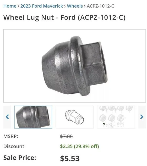

Ford conical (but open ended, not closed)

I'm over thinking this... Are these Acorns really the wrong thing to get if I'm looking to engage a bit more thread?
