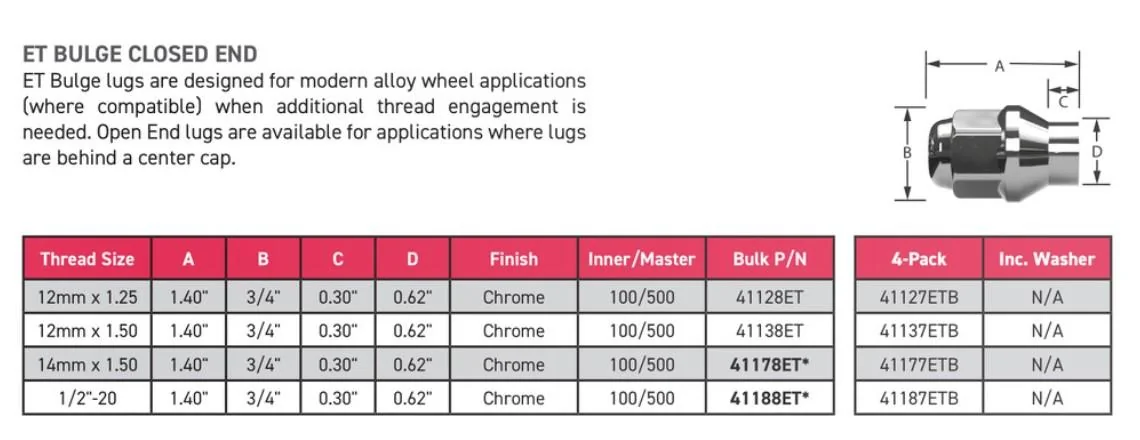

I use those "ET" types on the rear wheels (aftermarket).
you didn't mention what wheels you were going for/have.
They are Shift Spring Wheels. Just from the installation, The holes on them are pretty tight on my studs so I dont see the ET ones having enough room to fit either way.

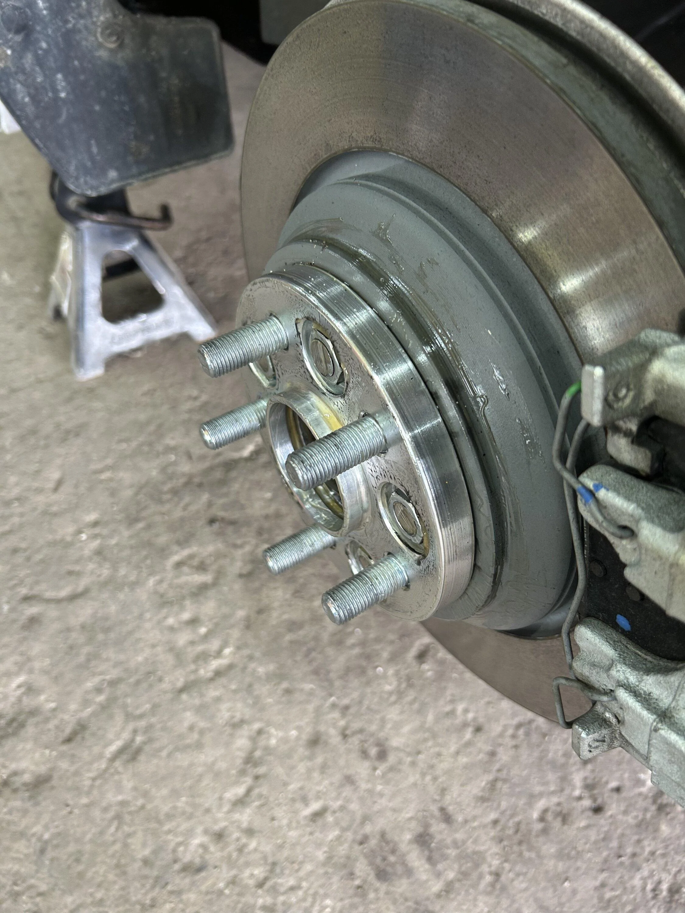

Ford Maverick Wheel spacers options 2096a74d-f13a-4358-836e-6b0d1d35bed4-jpeg
you just don't want to cut oem studs as TugToy did in pic above?
only other thing i can think of is to bore bigger holes in the wheels to fit ET but thats probably more $$$ too (if even possible with those wheels)
only other thing i can think of is to bore bigger holes in the wheels to fit ET but that's probably more $$$ too (if even possible with those wheels)
My concern I guess is that cutting them even if I do it myself will cost just as much later on to fix it if it doesn't work out. Parts alone being $250 or so for 2 hub assemblies as the studs are not maintenance able.

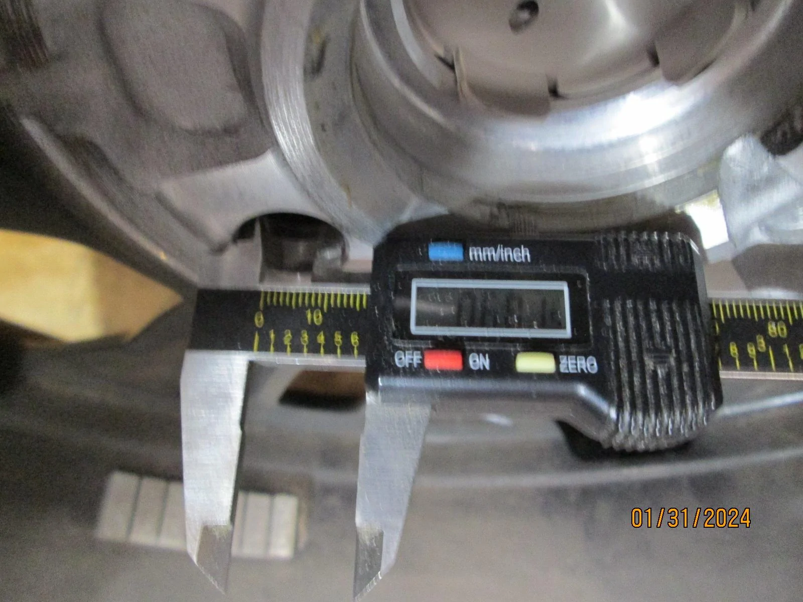

Understood. The (crappy) pic below is of the Ford 18" OEM BAP wheel, sized for 14mm studs. It has .681" stud holes, and recesses between that could allow a stud to protrude.
