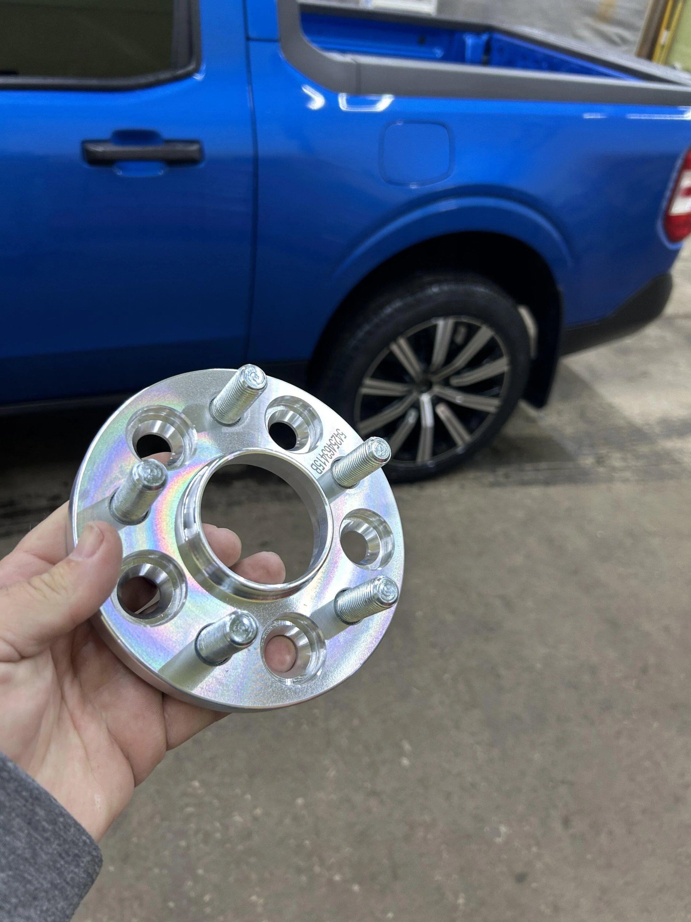

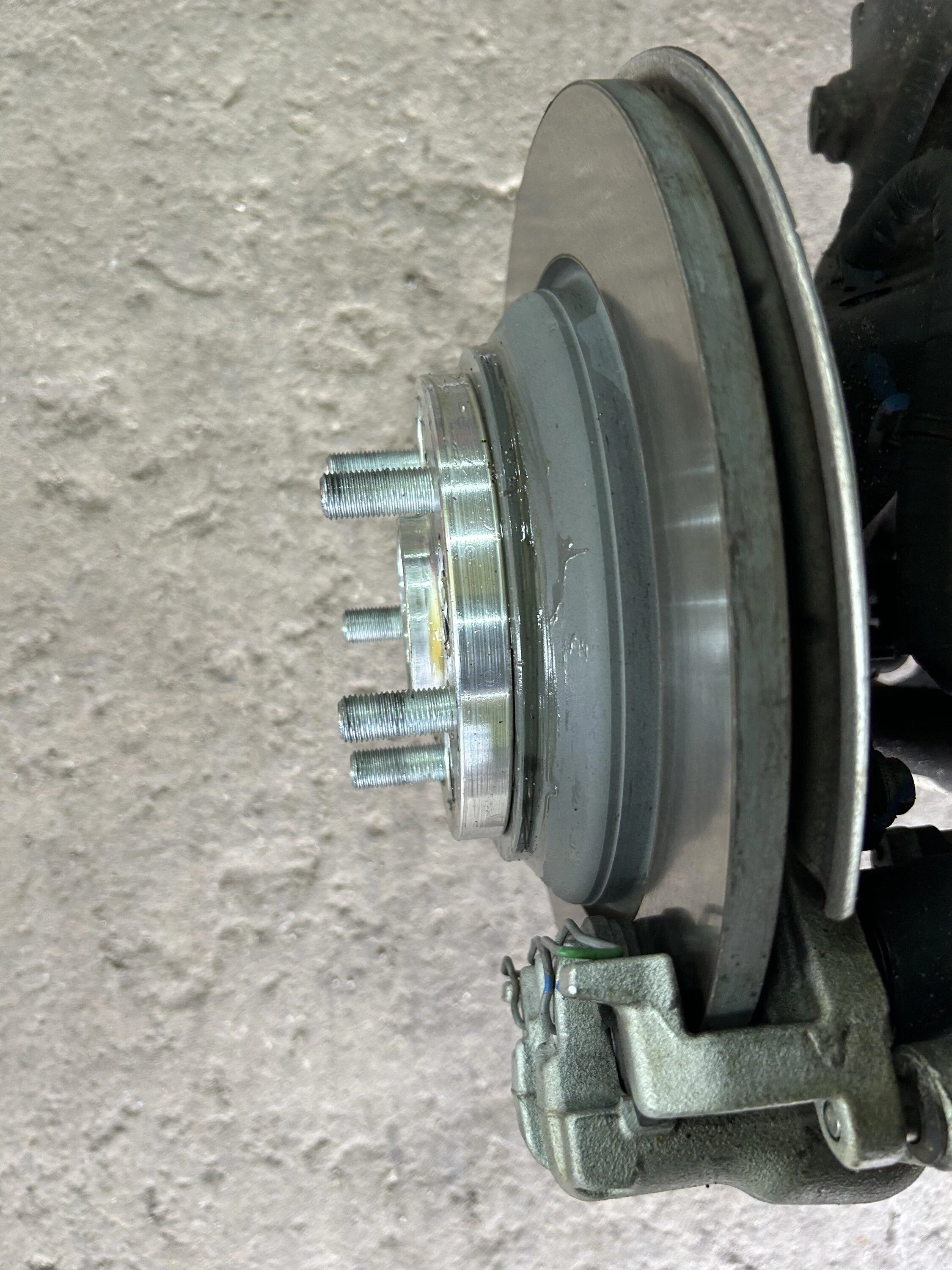

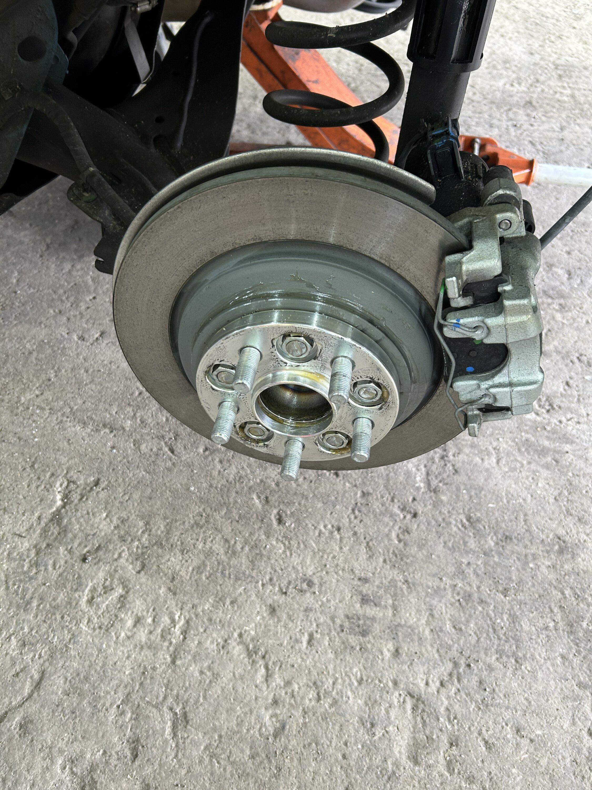

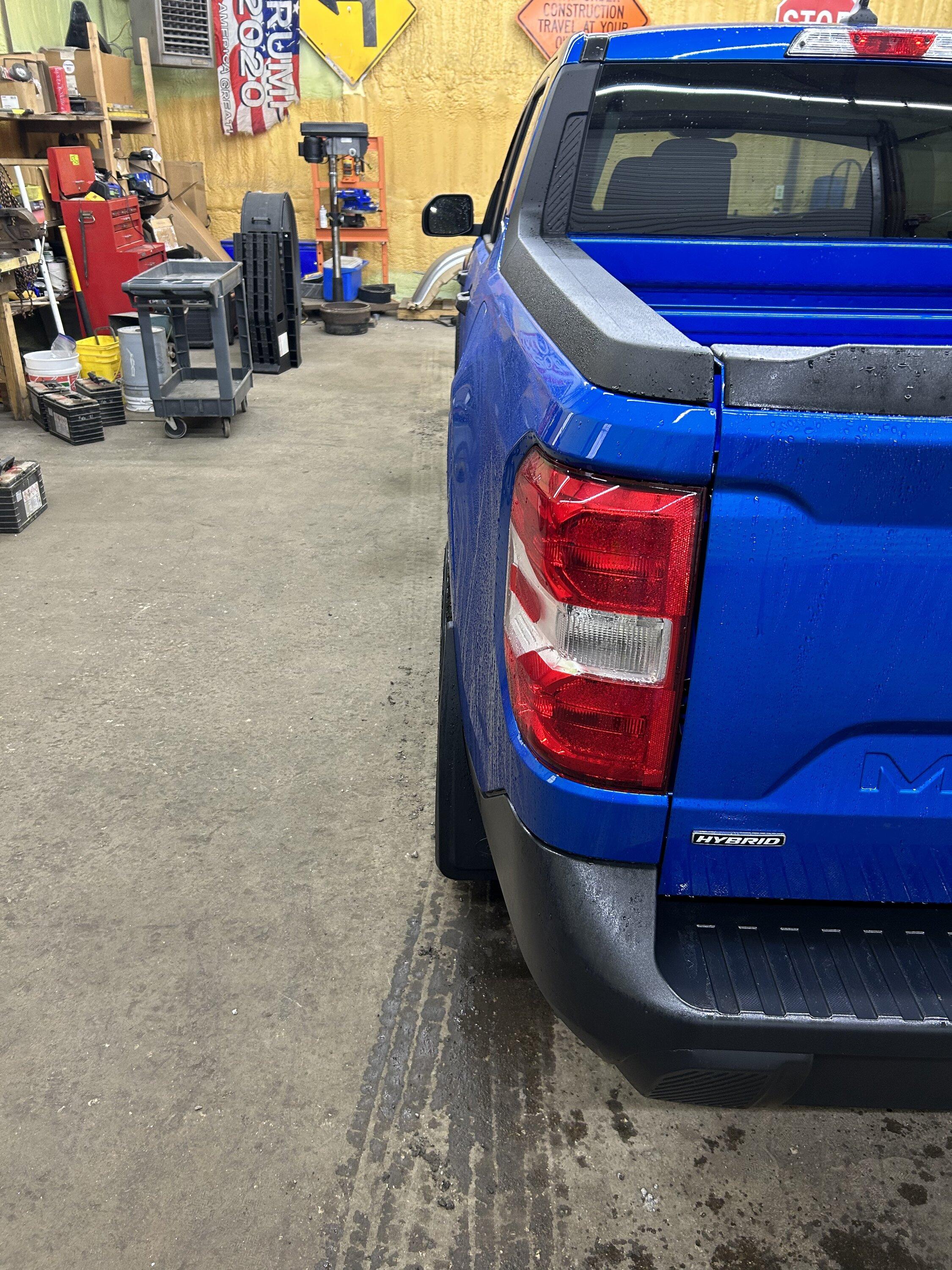

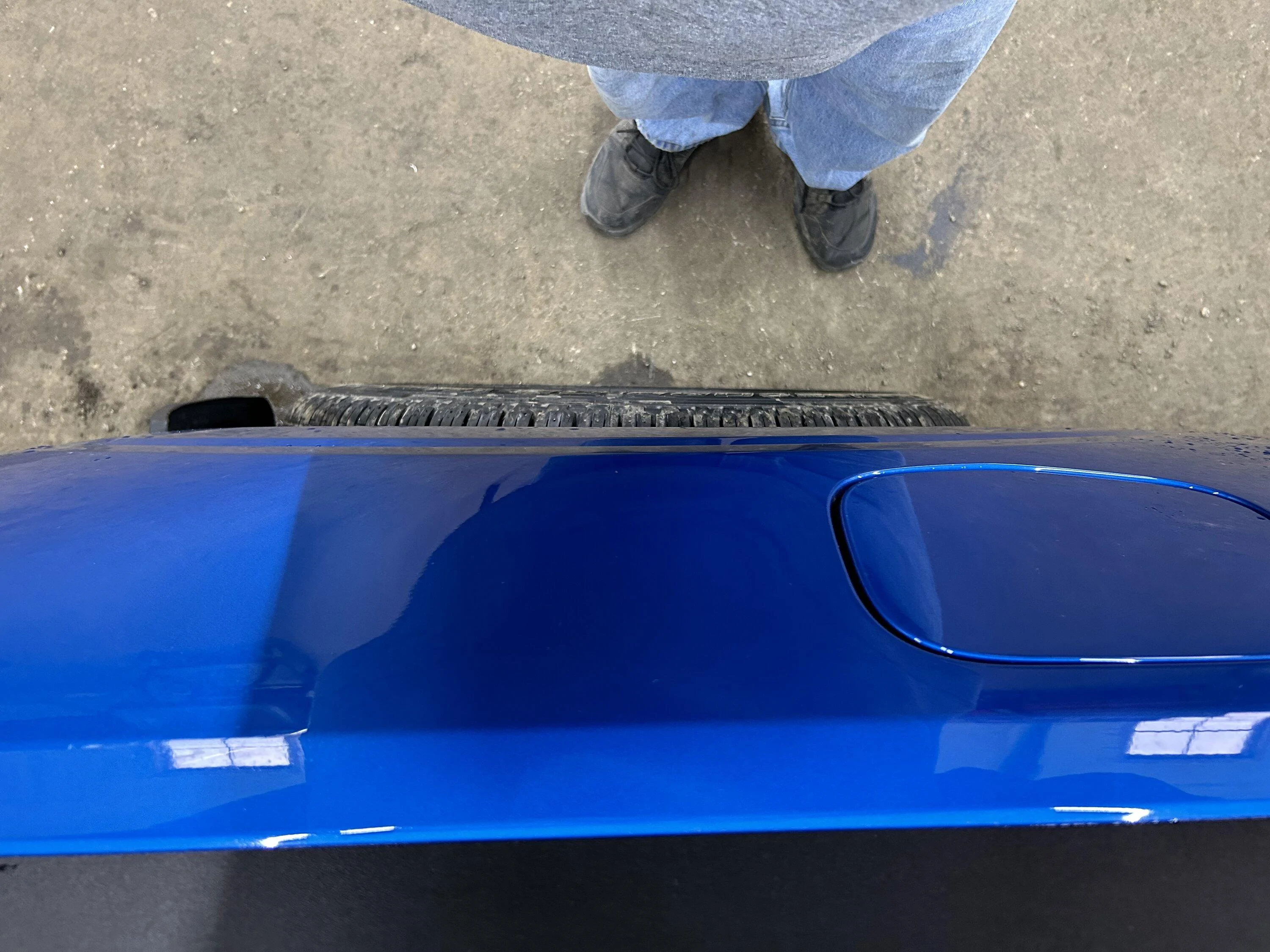

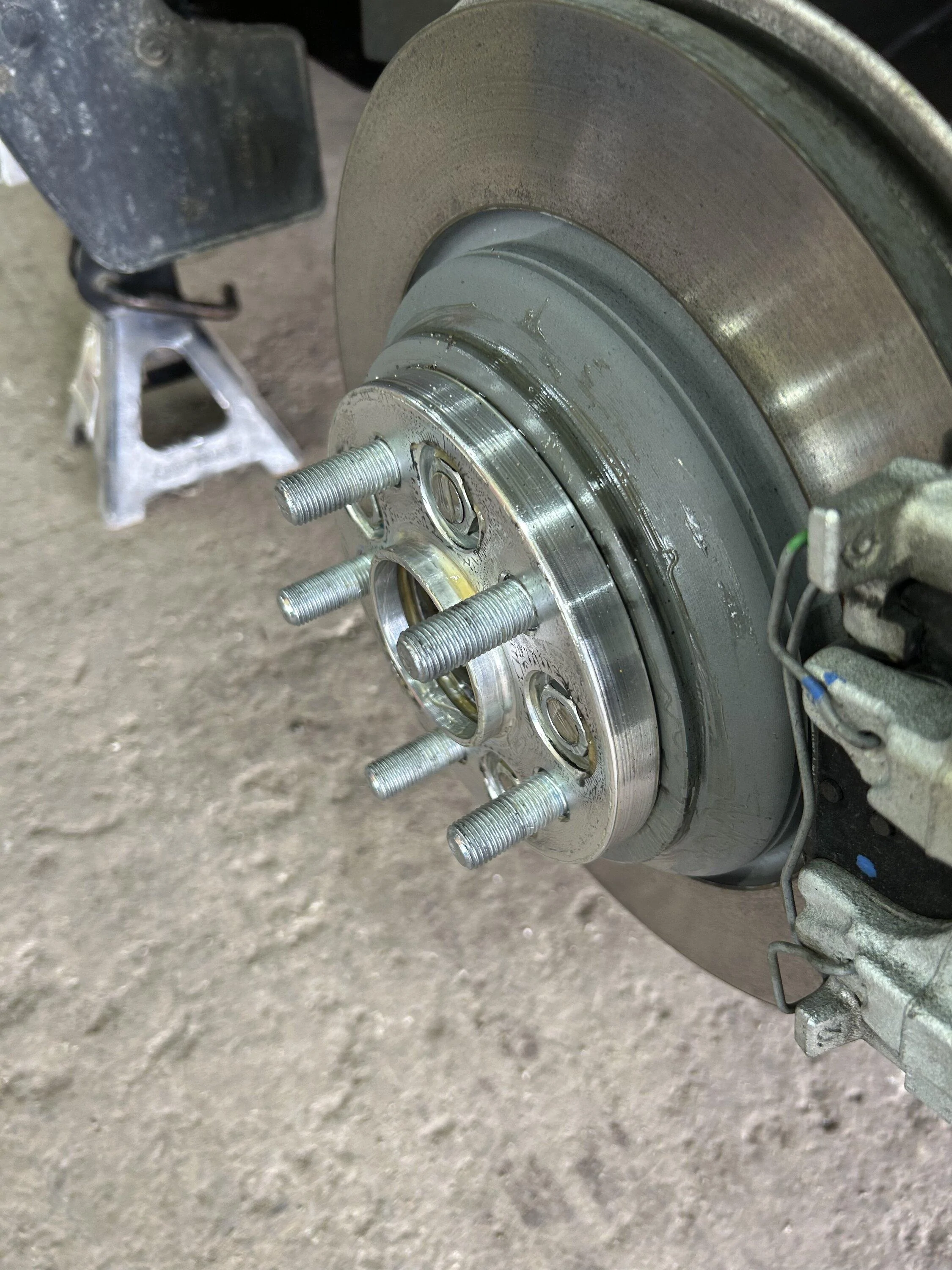

I looked everywhere to find information regarding spacers for just the rear to make the front and rear track withs look more uniform. It’s very hard to actually measure the fender to tire clearance. The fenders duck and dive from front to back and front to rear. I ended up taking the rear wheel off and stacking washers behind the wheel in several different offsets until I came up with 15mm or 5/8 inch as the best look.
So…….

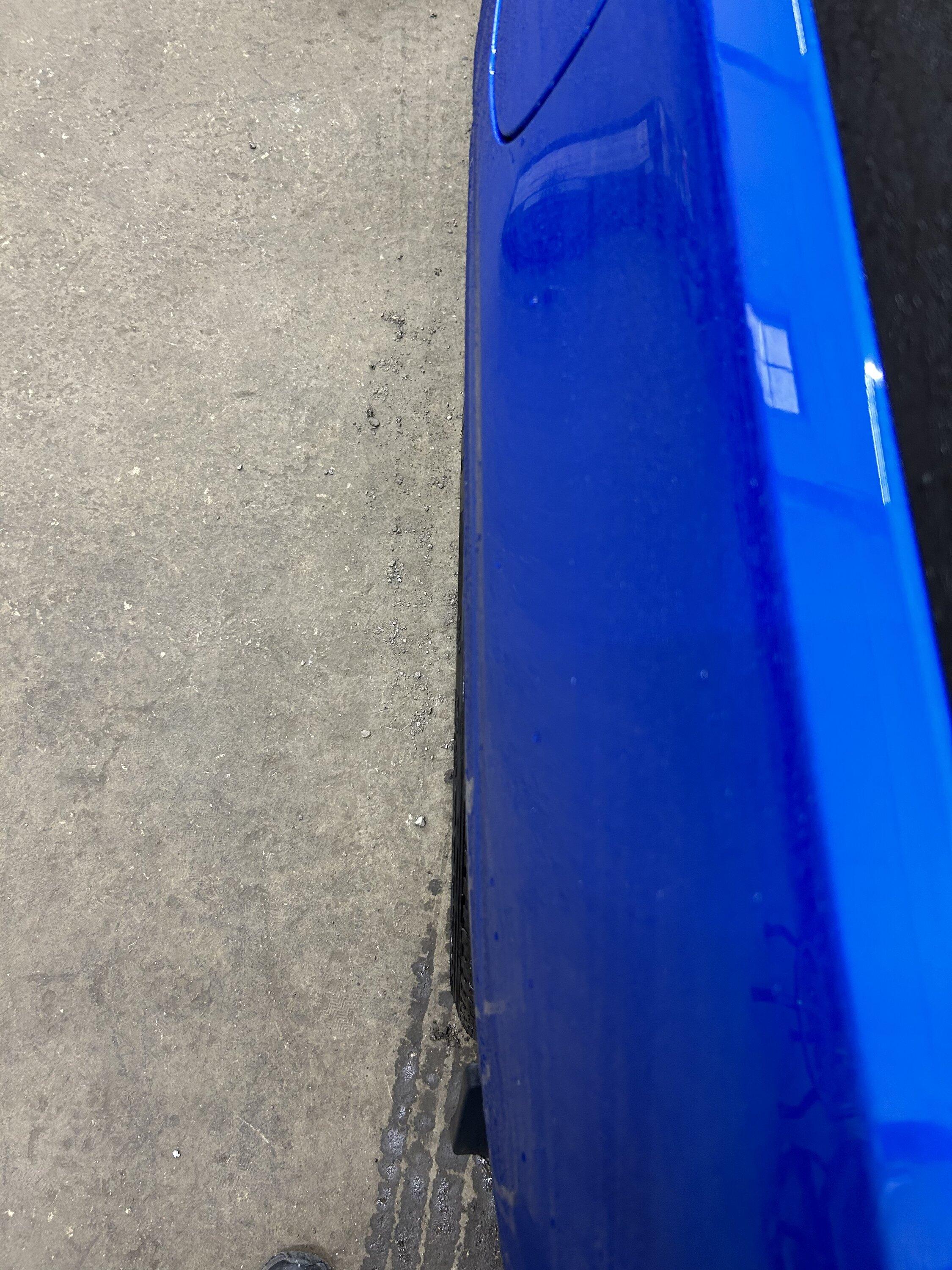

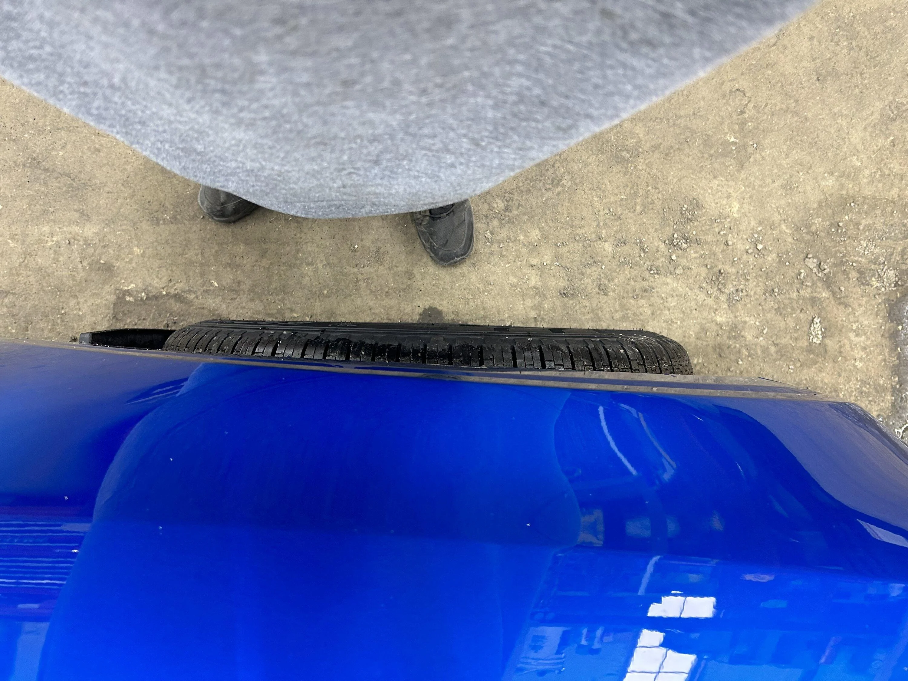

before

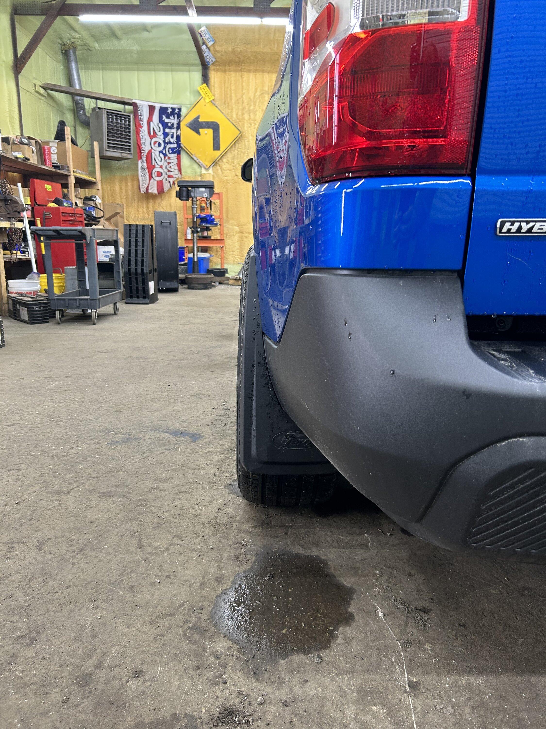

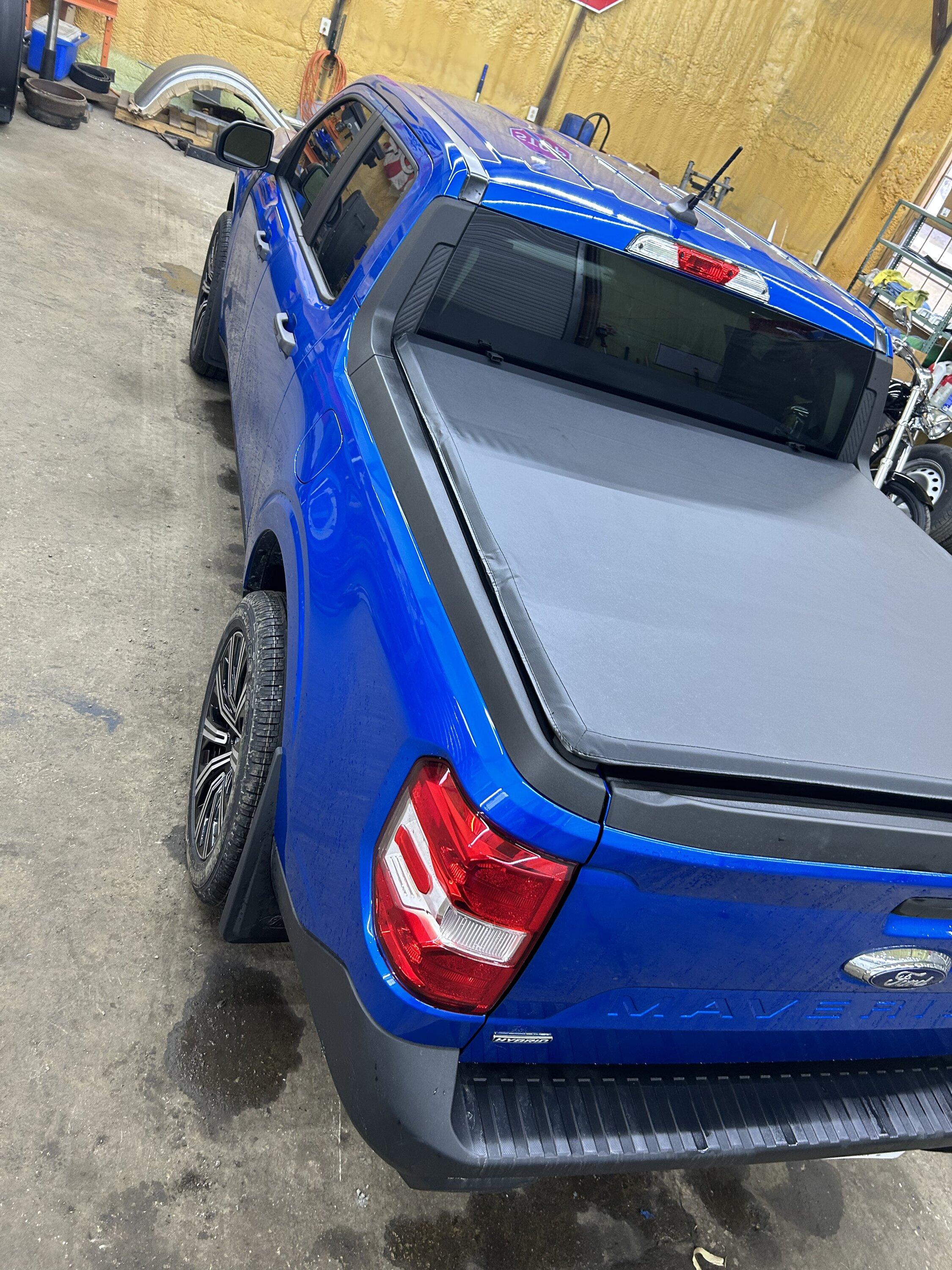

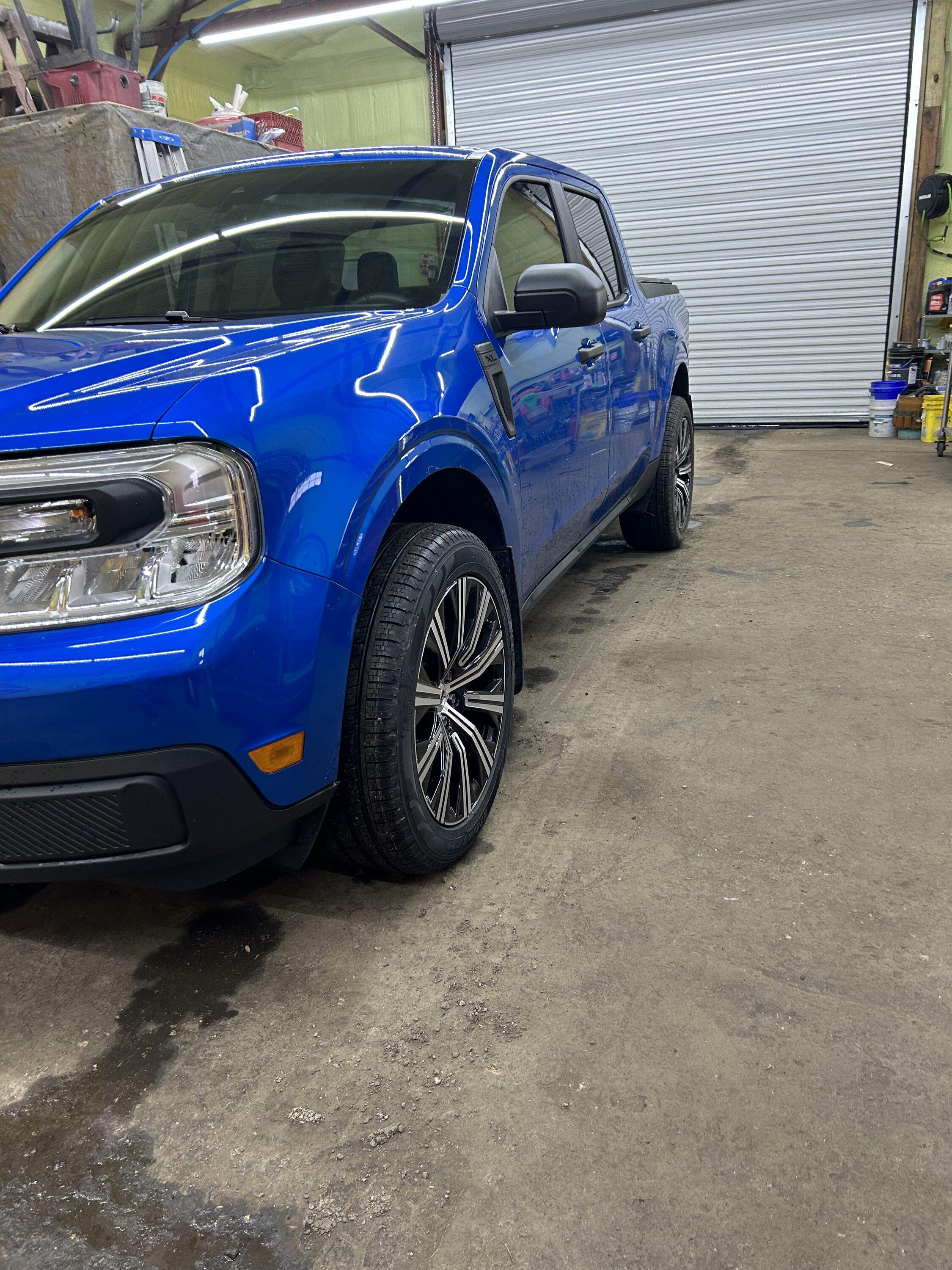

And after

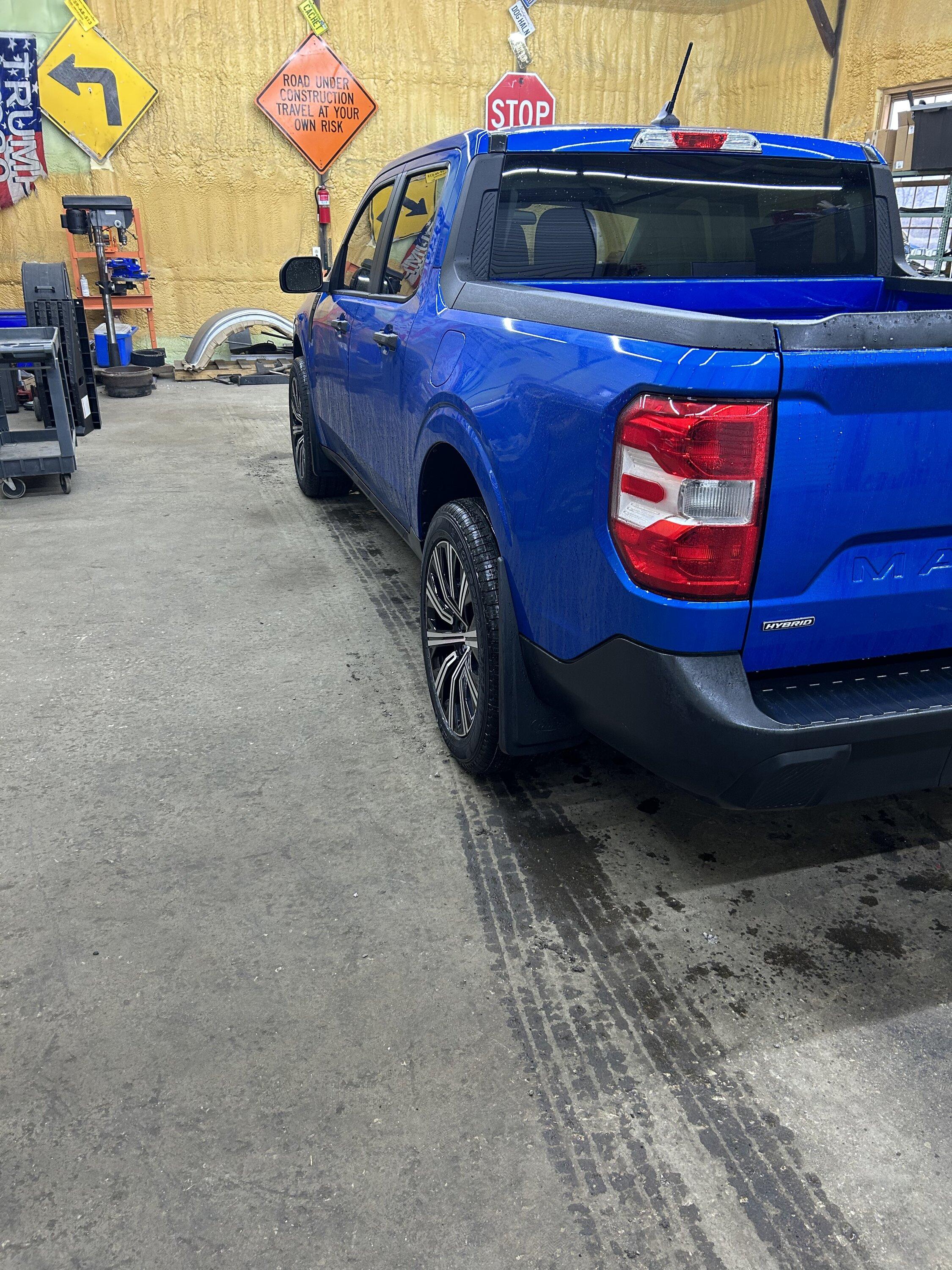

So…….
before
