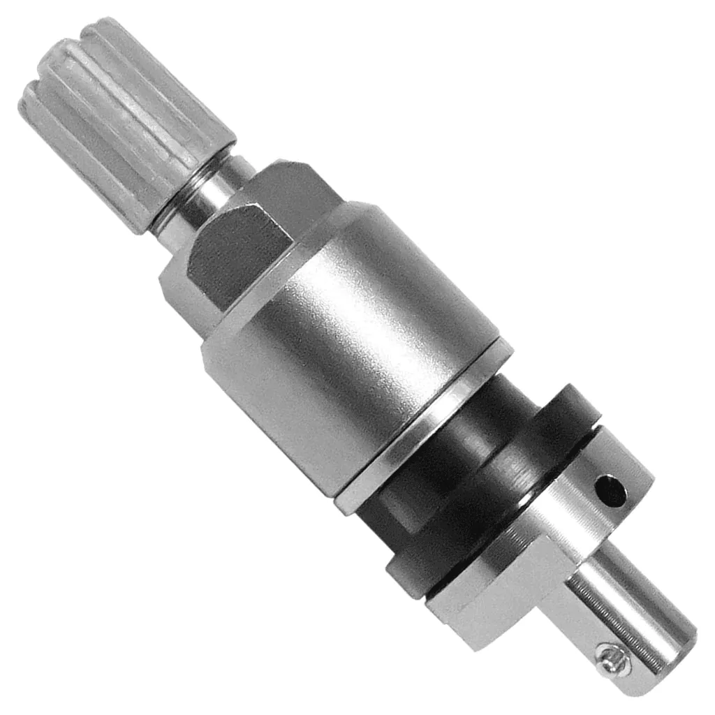

The metal stems are more for trucks running LT tires; rubber valve stems are usually only rated up to 60 PSI (even though I've used them just fine on higher pressure applications). But the assertion of them only using an O-ring isn't usually the case unless you're buying the cheapest of the cheap. Typically the rubber seal is a flanged shape designed to seal on the inner surface of the rim, the inner diameter of the valve stem opening, and then bulge slightly on the outside when compressed to seal against the outside surface.
Ford Maverick Wheel set for snow tires 1705512436049
Some of the commercial truck wheel valve stems just use an O-ring, but OTR use means they're probably getting changed pretty regularly.

Yes that is the style I am talking about, though I see I had a typo in my original post, now corrected, when I said the seal is on the outside. The seal goes on the inside of the wheel. But I still stand by what I said, and that this type of seal is terrible compared to a full rubber valve stem. The o-ring style, despite a small useless flange, does not seal on the outside of the wheel, unlike a regular full rubber valve stem. And the metal stems are not tied specifically to LT truck tire use. We’ve had this style (OEM, mind you) on our previous Toyota’s from the factory, and pretty sure the Prius and others weren’t spec’d for light truck tires.
Regardless, the topic is a bit moot as I said the Mav luckily doesn’t have this metal bolt-on style.
