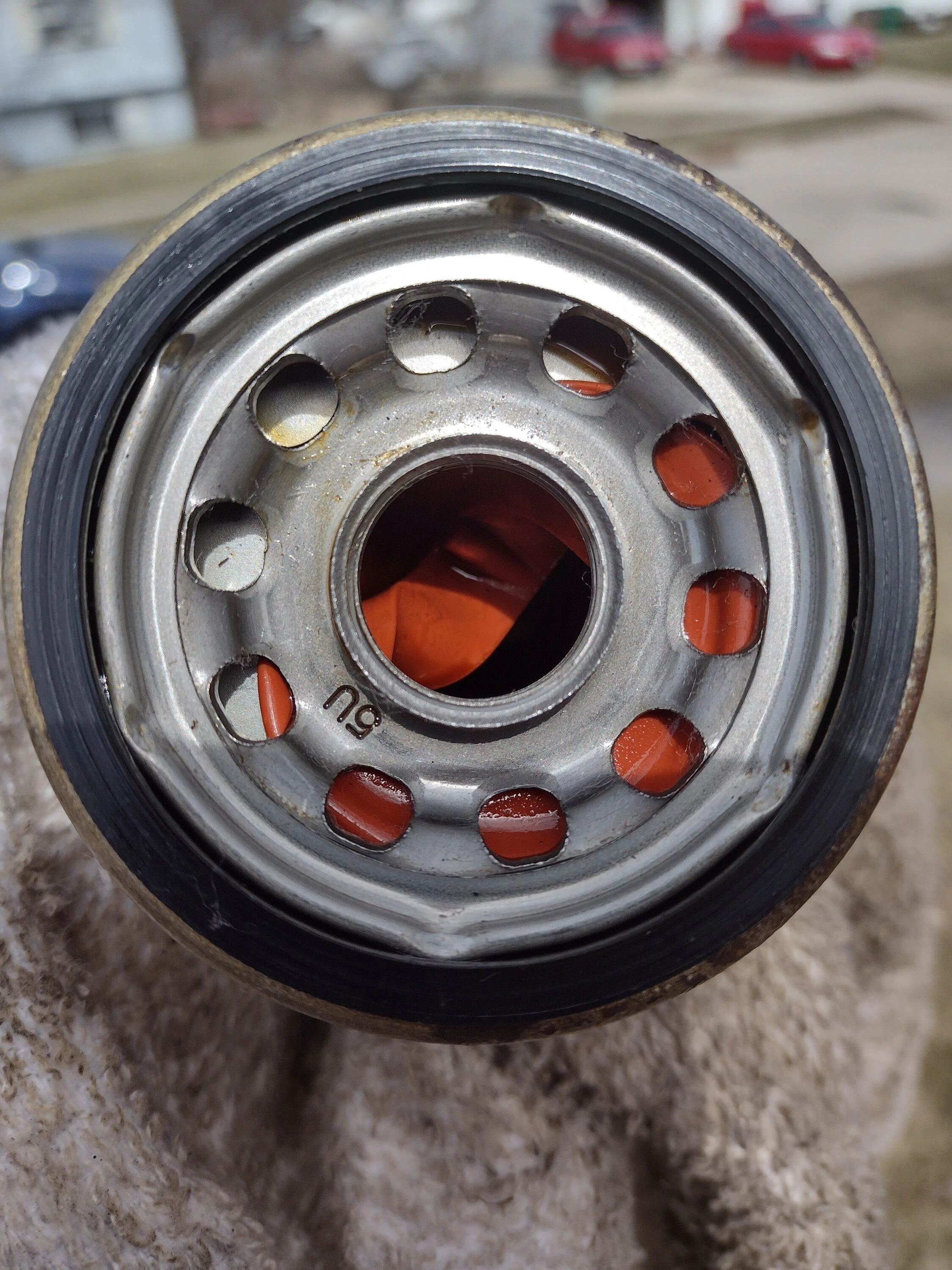

Changed my oil at 364 miles the other day. Still need to send out the oil for an analysis.
