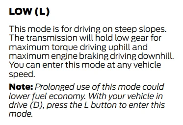

'24 Lariat EB AWD, found myself on a winding downhill stretch of road in PA this week, signed at 9% grade. Figured this was as good a time as any to try the L-button and see if there was any compression braking available, damn did the rpm's shoot up to 5k+! It certainly doesn't drop just 1 or 2 gears,,,,,,
HRG
I think you did not give it a fair test.
But in short, it is designed to rev higher because bloody 'ell that's what any low gear does!
RPM will "probably" drop if your speed does. RPM's taper off in the hybrids.

Not really sure what you thought was going to happen. It doesn't just downshift, it goes into gear to keep your RPM's as high as it can for downhill slopes and max torque. I don't think it goes over 3rd or 4th gear depending on your speed.

Honestly, I did not expect such a dramatic downshift. At the time, I was at about 40mph, well under 2K rpm, and the L button brought it over 5K, so like you said, down to 3rd or 4th (out of 8).

So it does EXACTLY what it says it does in the manual, yet here's a thread exclaiming it 'doesn't do much of anything'. There's nothing wrong with high RPM's, especially when engine braking, so I'm amused that it 'scared' you.
