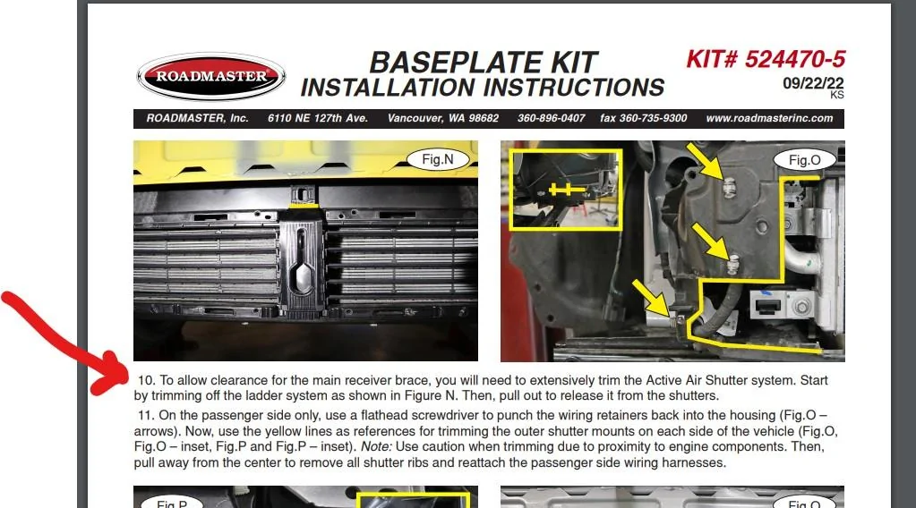

The instructions for the new Blue Ox baseplate are on the Blue Ox website, complete with photos of an azure gray Lariat getting the treatment.
Based on the instructions they have posted, I’ll probably wait to see at least one more vendor’s solution before committing to which one to buy.
I’d like to see if someone comes up with a solution that doesn’t completely eliminate all of the shutters and maybe doesn’t involve taking a sawzall to the grill.
DaveTS
Jan 6, 2025
New Mexico
2025 Maverick Lariat AWD 4K, 1992 MB SLK, 2014 Prius V
My feelings exactly.
