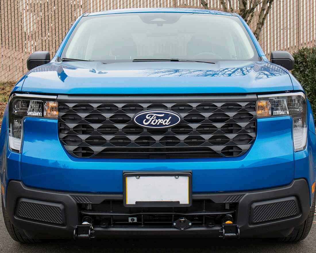

I am hoping to see the photos of the first installation I did ask Glenda to provide some pictures hopefully the connection points are narrow in comparison to the BlueOx setup and require less notching of the front facial

The instructions for the new Blue Ox baseplate are on the Blue Ox website, complete with photos of an azure gray Lariat getting the treatment.
