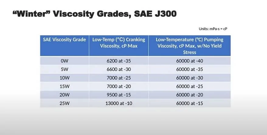

The reason these oil threads go off the rails is because people don't understand what the viscosity numbers even mean.
People actually think 0w, or 5w means really really thin oil and that that second number is what it thickens up to... It does not work that way. SAE J300 is the spec that explains under what conditions and what what the measurement is to make an oil a 0w, 5w, 10w, 15w etc. The W does NOT mean weight, it means Winter.
This first number is measured by temperature and the resistance called centipoise. The second number is measured by resistance to flow called centistoke. The second number is the actual viscosity of the oil at 100c(212f). Any given oil is going to vary it's viscosity by the ambient temperature and operating temperature of the engine. 0w-30, 5w-30, 10w-30 are ALL viscosity of 30 at full operating temp. The first number is only going to tell you down to what temperature it can be cranked/rotated/pumped and these temps when we say "cold" we mean -35c for 0w, -30c for 5w etc. Note that cold means FREAKING COLD! LOL The SAE J300 gives you the temp and the centipoise it has to meet or exceed. You can take 3 identical vehicles with the identical oil and have them in 3 different locations... Alaska, Michigan, Florida for example and every one of them will have a different viscosity oil at any given time.
So the OP mentioned a 15w-40 oil. The Ecoboost lists a viscosity of 30 as "recommended". A viscosity of 40 should still work fine as long as the ambient temps aren't too cold for that 15w. That according to the spec is -20c for cranking, and -25c for pumping.
Until people understand the basics they will continue to be off in the weeds with "too thin oil passages" and lots of wild speculation instead of science. If any of these "theories" about "too thick" oil were the case a used oil analysis would tell the tale. So if anyone has some actual numbers to share from a UOA that would be awesome. Preferably with some back to back tests with thin vs thick oil. Otherwise the science has been done on the oil side if people will take the time to look any of it up. I am sharing the winter(ie VERY COLD temps) preso for quick reference.
Now all that being said I would always start off with the "recommended" oil viscosity and work your way up from there if you feel you want a wider range of performance than the recommended spec oil. Of course climate, conditions, and how you use your vehicle play a critical role all of this as well. The higher the viscosity of the oil will mean more drag and less fuel economy. Just something to keep in mind.
